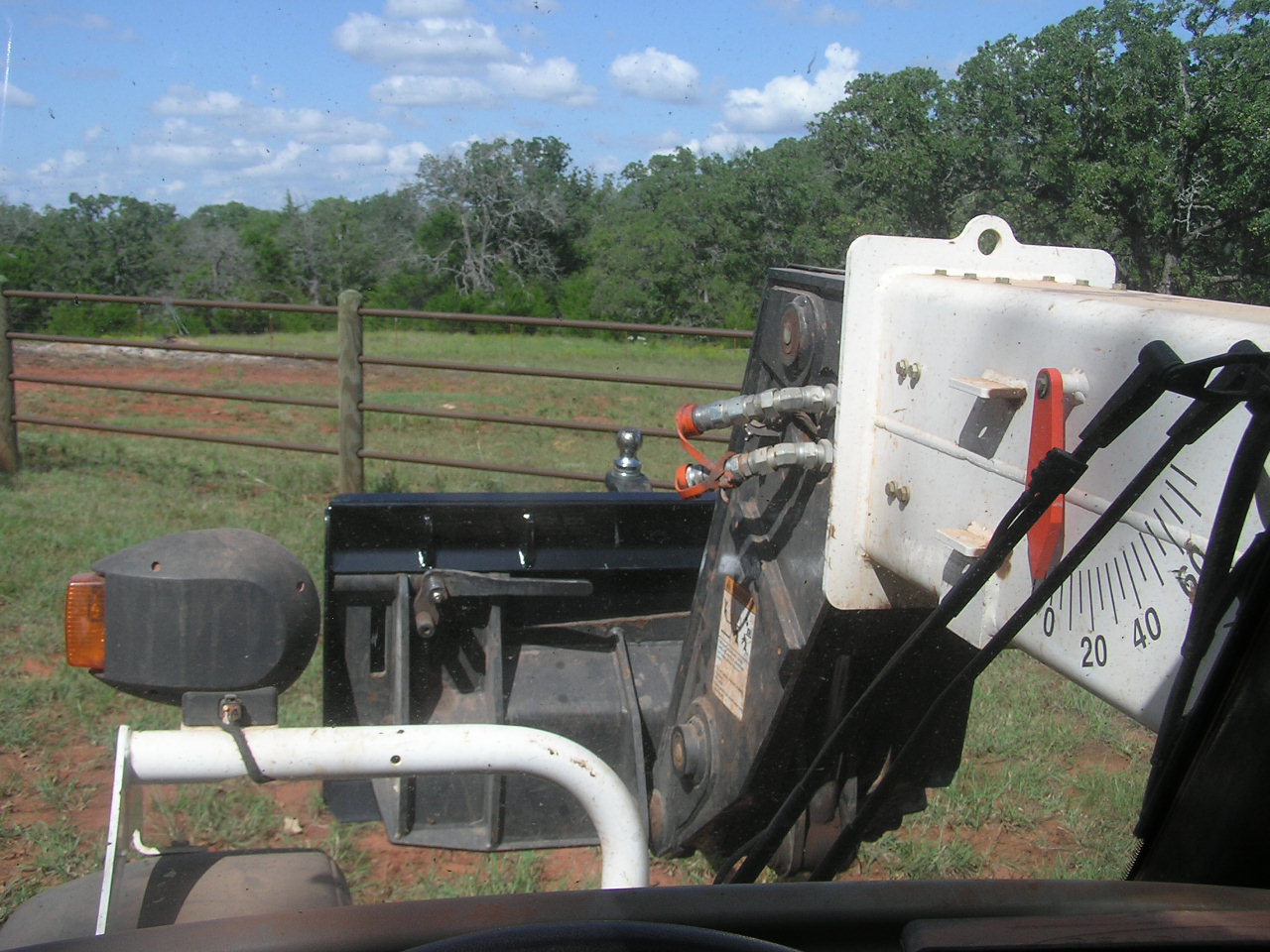

Will you be able to see the ball from the tractor seat?

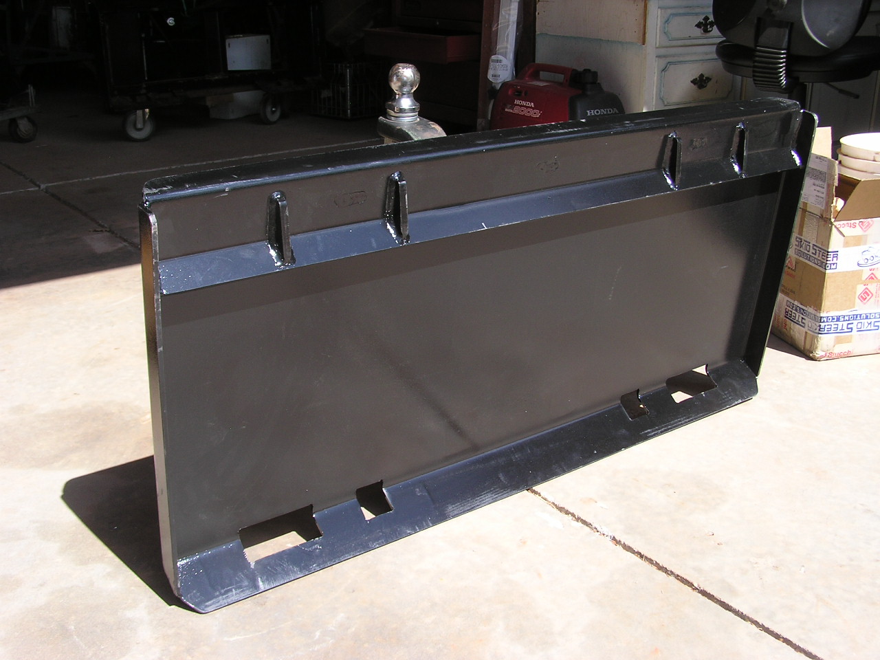

For my machine, I went with the highest mounted receiver on the strongest plate that I could find.
The rest of the story: http://www.tractorbynet.com/forums/attachments/322450-dual-hitch-receiver-mount-ssqa.html?highlight=
The view from the seat.
1150 pounds on the ball.

As for seeing the ball I think so, but if not I can get the Titan modified. I do have a 24" drop hitch that I can used in the raised position. They always seem to have one on Ebay for auction. I just need to figure out how to bid correctly. Neighbor said ignore until the last minute. I had been putting in a max bid, that someone always seem to top. Any bidding suggestions?

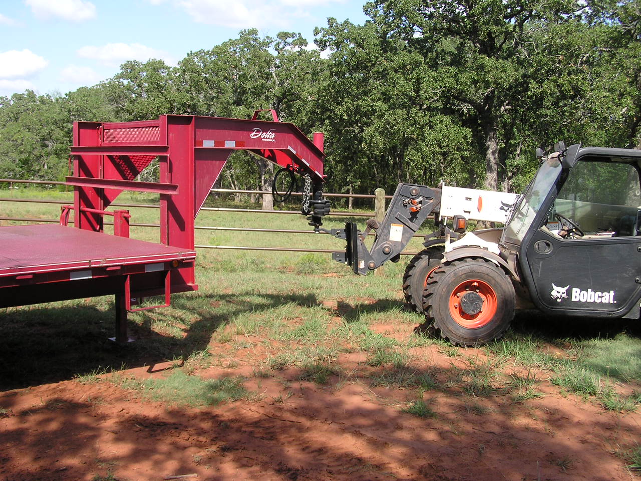

Well folks - scratch the idea of using this. 3point will hot handle the 1230lb dry tong weight of trailer. (trailer is heavier than I thought per the PJ factory)
I need to get a quick attach loader one for the front to move the trailer around the barn, and use the truck to drive around to pick up. Should work OK that way too.

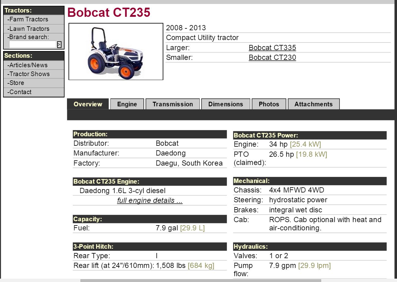

What brand is your tractor?
If it is Bobcat, TractorData.com Bobcat CT235 tractor information shows 1508 lbs.
And the 7TL Loader.
Most tractors have more lift at the 3 point, than on the loader. :confused:

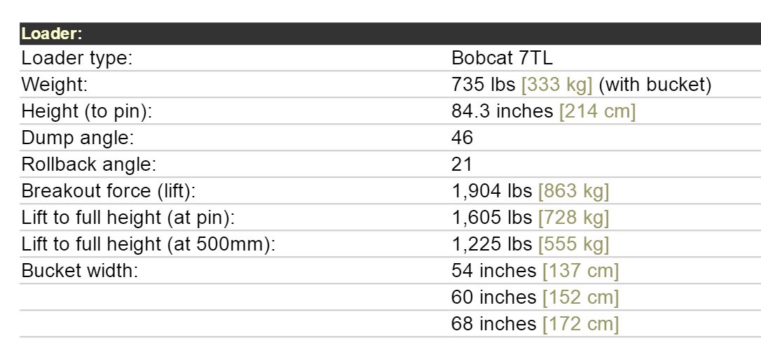

My owners manual clearly lists 1100lb for the 3pt (page SPEC-6). Local Kubota dealer has a more expensive QA set up on their yard tractor and indicates it is much easier to push and stear to park trailers using the front set up.
As the hitch ball will be very close to the pin, I believe I have more lift with the loader. Empty pin weight per PJ is 1230 lbs. I was able to lift the unit with the bucket on, putting the GN in the bucket. No issue doing that and tractor was stable doing it. However I did not try and move the trailer.
