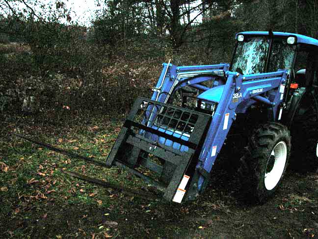

I would definately stick with the Neew Holland loader. It is excellent. You should consider the skid steer quick attach to the bucket. It is very handy. I have the MSL- self leveling loader. I'm not sure I would get it again, no that it really bothers me , but I don't think I need it and sometimes I'd rather controlt he bucket curl myself.

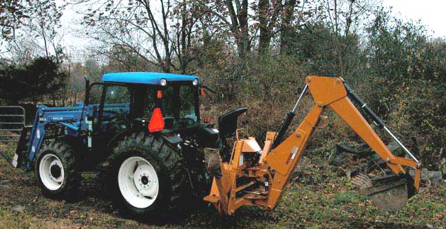

I'm running 16.9x30 R1's rear and 11.2-24 R1's front. They were the largest size available when I purchased. I really like the width and the load capacity. The rears are filled with 74 gallons of RimGuard each for extra traction. That equates to almost 800 lbs of ballast in each tire. Other than on wet ground, I don't have a problem with the tractor sinking in. Attached is a picture of my TN.

Anothr picture. Front end with forks this time.
