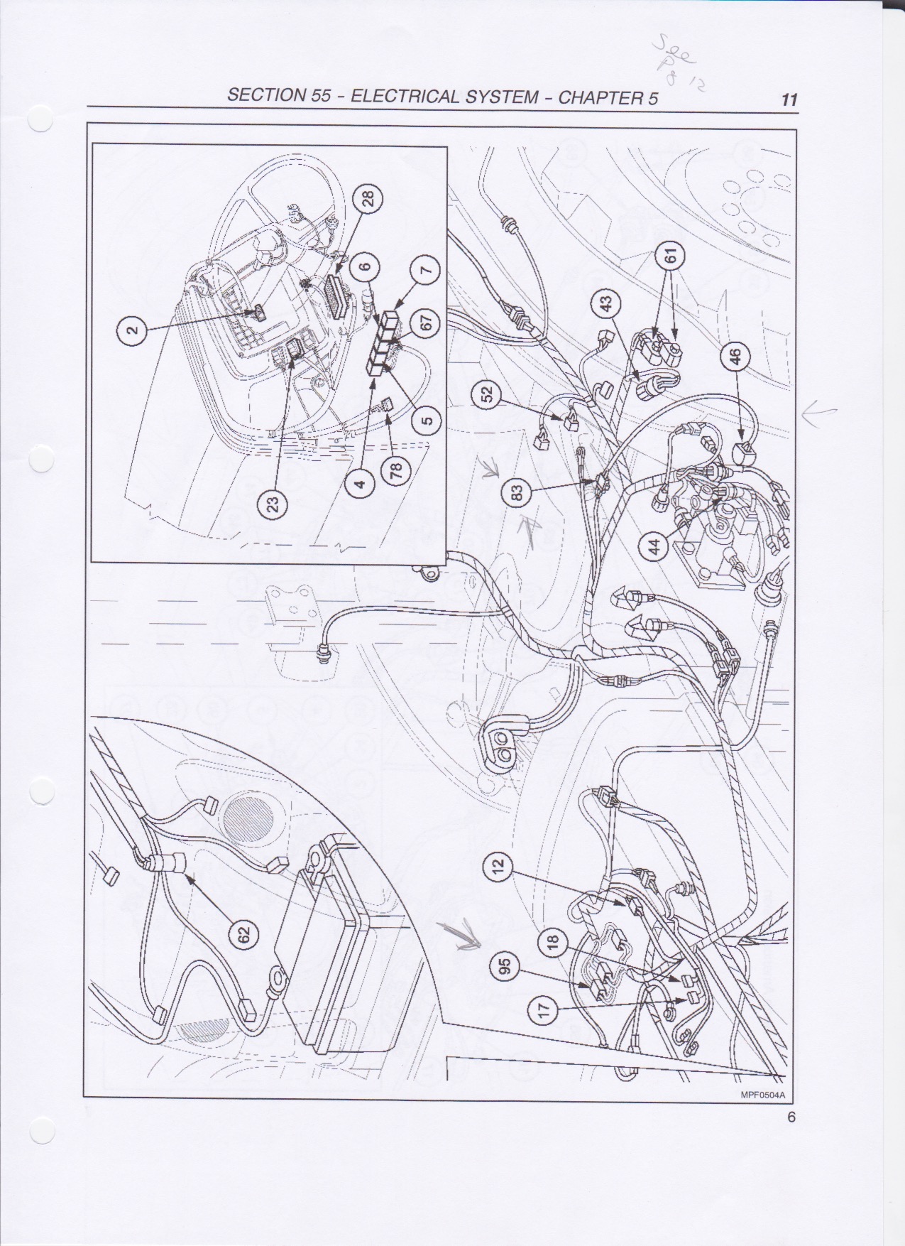

#12
Thank you ch1ch2, is #44 the solenoid/valve? There is a penciled in note at the top of the page that says "see page 12", is that the item list that goes with the numbers?

I sent you a PM that item 46 is the solenoid when I tried to send the diagram. I did not think the diagram went on the PM so I posted it here.

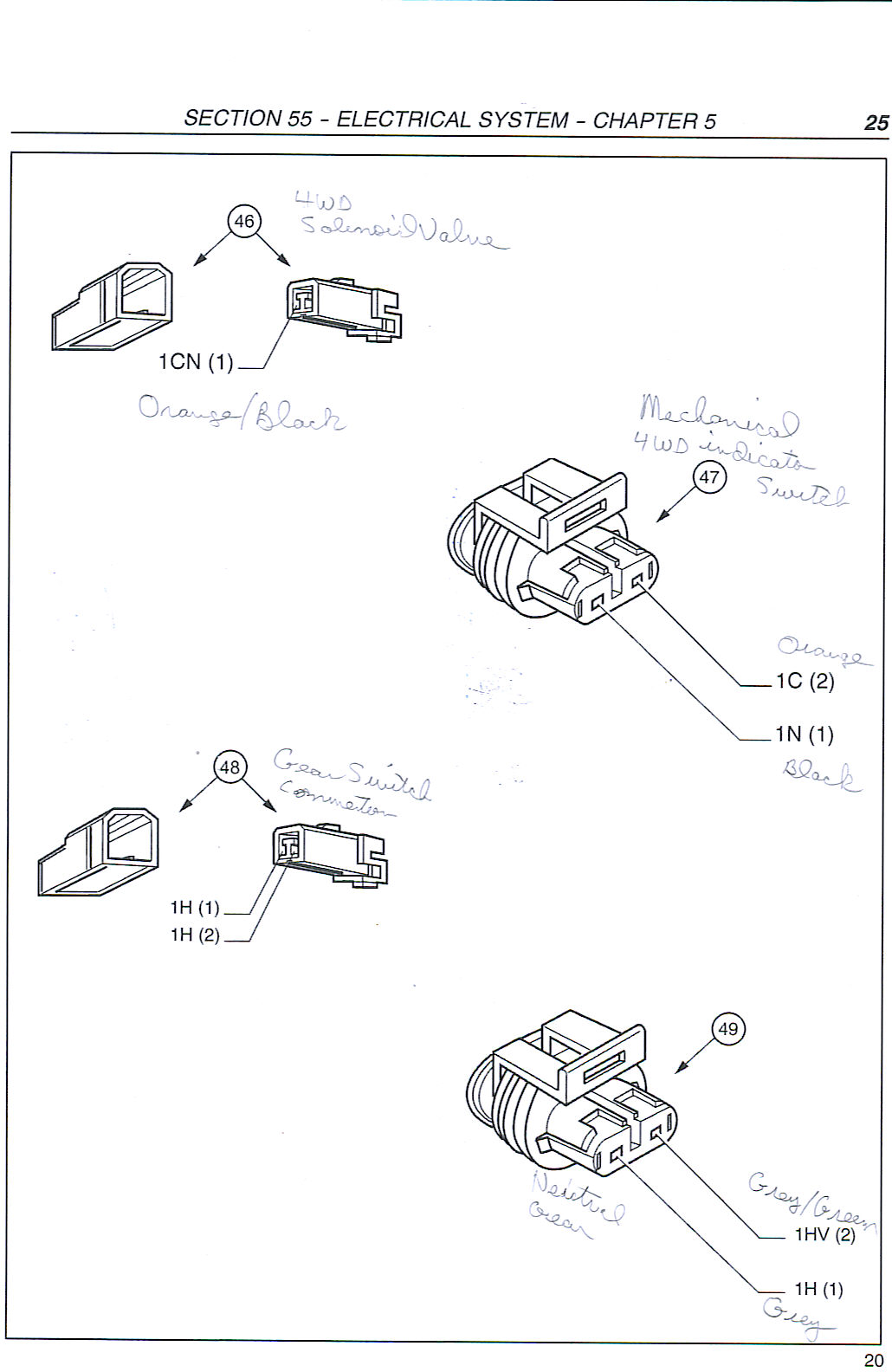

1 wire colored Orange w/black stripe.

#15
Got it, thanks. I will get out tomorrow if it is not raining and se if I can find this connector

Tim, Did you find the solenoid? Is there an open book light flashing on the dash ?
