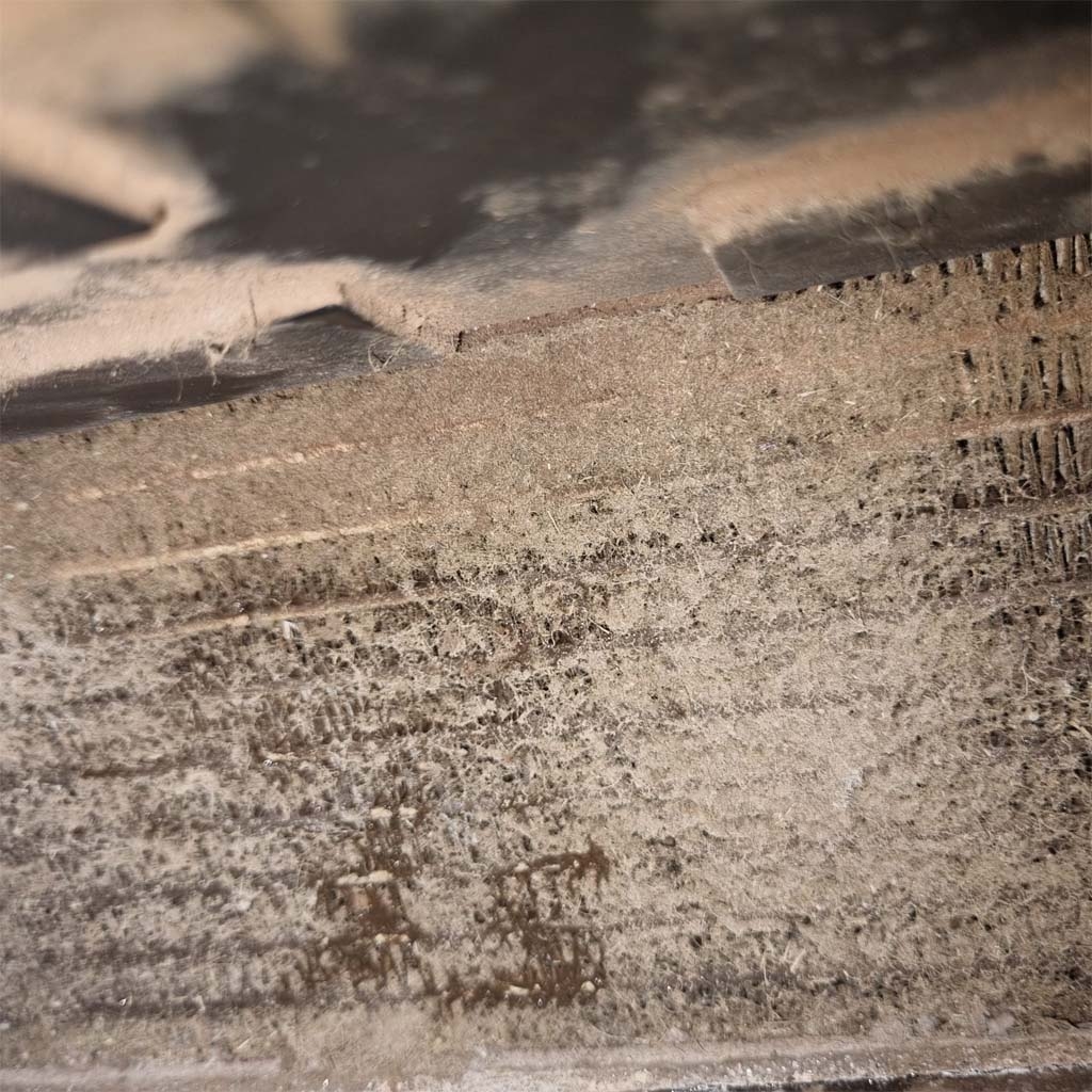

No both are extremely dirty... I am working with basicly one arm... shoulder surgery
in 10 days... trying to get this all done before surgery.
The above was in answer to the question: "Are you sure the evaporator and condensor are clean and clear? Can you see light through them?"
In the case of the AC in my Kioti being annoyingly erratic - producing nice cold air one day, then no cooling at all the next (or even the same afternoon) - we, that is the air-con guy, found an incorrect factory installation of the upper cabin frame sealing strip. The foam strip is designed to prevent ingress of air into the space between the hood liner and the fibreglass roof, such that the ONLY air which enters that space is via the cabin air filters - one on each side.
In the 4+ years since I've owned it since new, dusty ambient air had been sucked into the space (bypassing the cabin filters altogether) to the point where the evaporator ended up like this:
   / Tn75s air conditioning relay #34
Would be hard to get much cool air from that.
   / Tn75s air conditioning relay #35
Cold on both sides of the evaporator tells me you dont have any air flow across it. No gauges, pressures or calculations needed.
Mine looks like that... I bought this used off our local NH dealer I suspect no one has ever been up here since it was new... I can't put it all back together till I get the cork tape coming in the mail.
   / Tn75s air conditioning relay #37
Yeiks…you have to drop it into the cab. That sucks. On my kioti the roof hinges open.
Everytime ive opened it the space is clean of any dirt. I replace the filters often though. But there not cheap.
But my AC keeps me so nice and tosty.
A month or so ago the compressor stopped working, luckily was an easy fix…a shorted wire coming off of ac fuse.
#38
UPDATE! UPDATE! UPDATE! UPDATE! UPDATE! UPDATE!
Everything has been cleaned and repaired and cork tape reapplied and the thing is blowing cold cold air. Special thanks to everyone who helped me along this journey.
