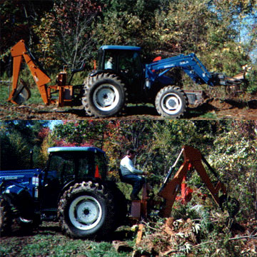

This reply may be a little late, but just wanted to let you know that I am using a Woods 1050 backhoe with my TN75S and it is a great combination. Very smooth strong hoe. Before buying the combo, I emailed a design engineer at Woods and he told me that the TN75S and 1050 were a good match and they had one set up that way at Woods. No clearance issues.

Hi Robert,Yes my TN75S has both the factory cab and supersteer and the Woods 1050 fits with plenty of clearance. I am 6' tall and don't get anywhere near the cab, either operating or getting on and off. This is a 3pt hitch mount backhoe, which I would never run on a smaller tractor, but both Woods engineering, my longtime dealer & riend, and New Holland technical folks told me that a backhoe that mounts the way the Woods unit does is not a problem. It uses 2 rigid lower attach points to the lower 3pt links as well as a very heavy rigid top link which is made even more rigid by the addition of 2 other bars of heavy steel that ford a 3D triangle with the top link from the lower mount points. In addition to this it has 2 heavy safety chains bolted to the backhow and secured around the axle of the tractor.I have attached a couple of pictures that aren't of very good quality but they are all I could get my hands on right now. This backhoe replaces a Ford 758 that I ran on my Ford 2120 for 14 years and it is a very major step up.Andy
   / TN75S with cab and backhoe? #17
There is quite a bit of room there, thanks for posting the pics that is the first one I have seen. It is a nice setup, now I am going to have to get the backhoe.
   / TN75S with cab and backhoe? #18
I'm still living in central Mass. I have the farm in Woodstock, Conn which I have owned for 14 years and will be moving as soon as I sell where I am and build down there. I guess I never thougt about clearance with the cab since i bought it. I was at the farm today using the backhoe- there is about 24 inches of clearance between my back and the rear glass of the cab- I never come any where near the cab. I looked at several brands of hoes before settling on the Woods- 6000+ #'s bucket force and 10 1/2 " foot digging depth. The other major reason I settled on the Woods was the swing was controlled by 2 directly attached cylinders (not the chain attached to the cylinders). I can use the swing to push a lot of material or a fairly good size rock sideways.
