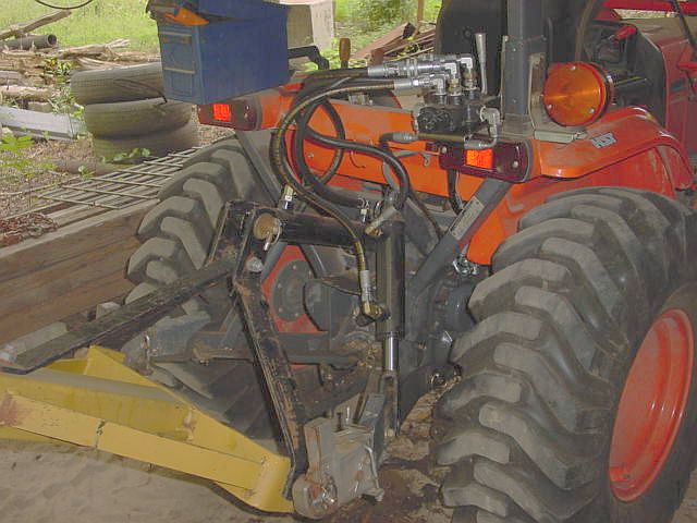

Well, Good folks, it looks like I'm finally finished with this TnT addition.
Thanks again to all who helped with this endeavor.
Hope this post will help others that may want to add TnT.
Before you order any parts go back and read the advice I received in this thread.
Remember hydraulic cylinders do not PULL as much as they PUSH.
If I could start over I would also use straight hose ends at the pump instead of the 90 degree that I have.
With 90 degree on both ends of the hose it gets a little difficult to attach both ends if the hose ends are not "aimed" in the necessary directons.
One of mine has to have a slight twist to line up for connection.
Ok since I just stopped the slight leak I have had since day one here is a pic of the finished installation.

The end result looks pretty good, and that's what counts.;)
   / TnT on B2910 still need help. #14
Yup, I agree with Bird. It looks like a pretty good installation. You must be excited having finished it and now it's ready to use.
Nice job.

It doesn't look like you set up the valves to use Power-Beyond. My memory is a bit faded on the topic, but without it the use of any down-stream function will create backpressure and lessen the force available to you TnT. If you 3PH is trying to lift, for example, it will lessen the pressure available to your TnT. This might be contributing.
