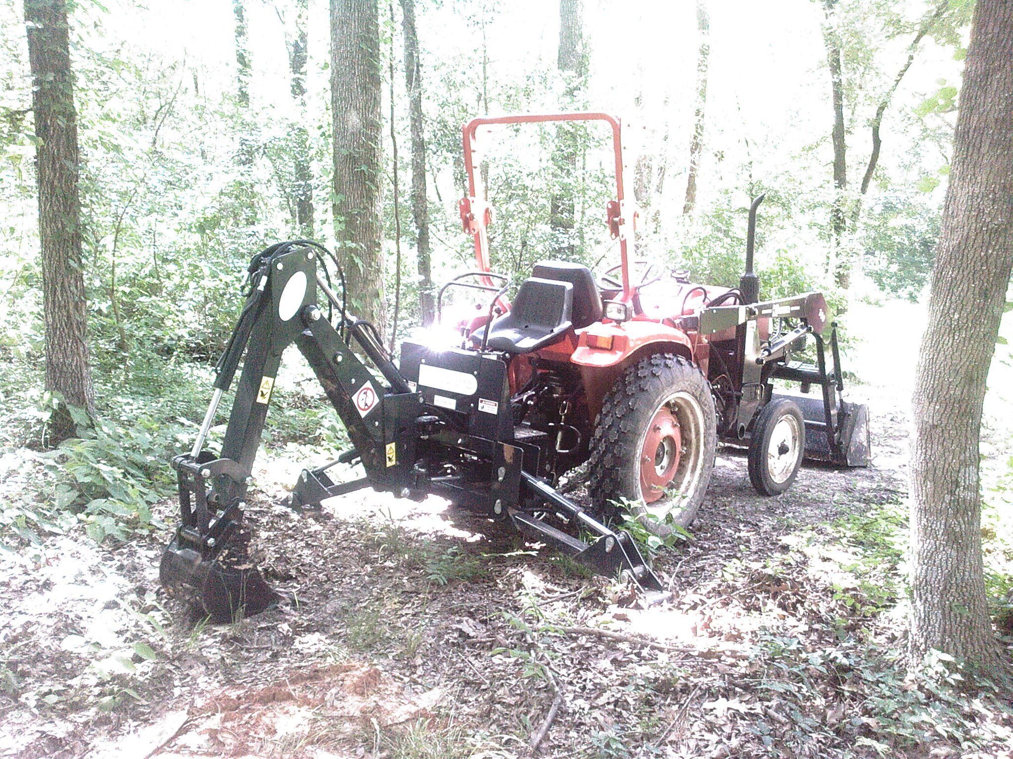

I have got about 10 hours use on a 3pt mounted backhoe on my Jinma 200LE. I got the steel today to hard mount the backhoe to the tractor. The only problem I have seen, in use, has been trying to dig deep in clay. The bucket tends to slide over more than dig in since the 3pt does not have down force. The other problem for me is trying to mount the backhoe. Lining up on the lift arm receivers and the top link pin is a real challenge for me. The lift arms flop side to side as I backup and makes it a moving target. I am going to a hard mount to the back axle. There are, all ready, bars connecting the back axle to the FEL mount. I have found that people use the backhoe to pick up the back end of the tractor and move it side to side. This puts a lot of stress on the tractor if there is no subframe support. I also found fast transport across rough ground will stress the tractor, probably enough stress over time to damage the tractor with no sub frame. I believe I could use the backhoe for ever, 3pt mounted, without breakage. The convenience of hard mount and the toplink will be worth the effort and the $100 it will cost to hard mount. I don't believe the tractor will be hurt if the rear wheels don't move while you dig.

The first thing I will tell you about your 3pt mounted backhoe... Enjoy it; as it is what you have.
Back in the landscaping days we used both types on almost exact machines, when heavy work was needed or we would be traveling any distance (like to the back of a 100 acre property ) with the BH and Tractor, we always took the subframe BH. It was not hard to see why when you lift the front of the tractor off the ground digging or when transporting long distances over uneven ground, even the subframe would carry over movement to the tractor, the 3pt would 'shake the s...; out of it, as I believe my coworkers called it.
So when it was time recently to buy my own, I did not even question it, subframe mounted was the only way to go. While I can believe there are pros and cons to both, removal and ground clearance are not an issue on mine. I removed it for the first time this past weekend thinking it would be at least an hour job, 10 minutes later I was putting on the rake. As for clearance, it might be a few inches at most below the axle, so I have yet to see any difference.
The one area I would give the 3pt BH an advantage would be with the storage footprint as you wont have to store the extra 4 feet or so of frame. Although the BH its self is no small item to begin with.
Since you already have it, why worry what other people think?
