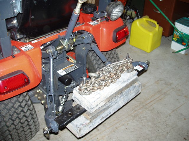

This why 3ph ballast is nice. A heavy rear implement will work also if you are multi tasking:D
If I am cleaning up brush in the yard then I do not worry about ballast beyond the filled tires. Any serious work and and the 3ph weight goes on!!!!
The weight for my BX consists of a Ford Bar and solid lead plates.
The weight for the 3940 weighs in about 1200# with over 500# in the tires.

weight is weight whether it is on the 3-point or in your tires and your 3-point.
Sorta but not really. With 3 point hitch ballast you modify weight distribution, esp. on the subcompacts.
   / To ballast, or not to ballast #20
Like I said, in most situations and the effect will vary depending on size, wheel base and on and on; hate to make blanket statements as someone can always pick it apart.
