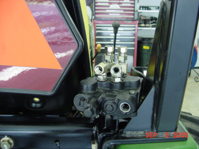

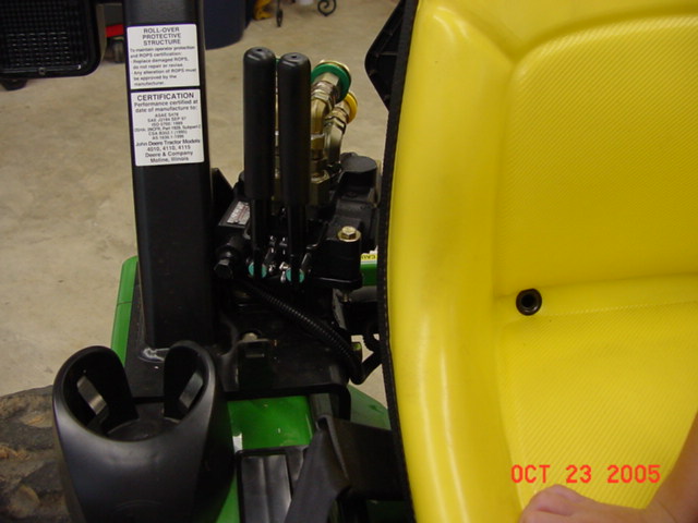

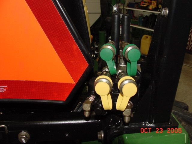

Been looking at those, but again, seems like the work ports are on top.:(
That is an easy problem to overcome with a few fittings, take a look at my valve below:
Kenny,
You're a lot younger looking than I would have expected.:laughing:
I'll take a picture tomorrow of the loader valve that I am thinking of replacing so you can see why top ports aren't very good in this situation. For the TNT, your right that I could work around it.

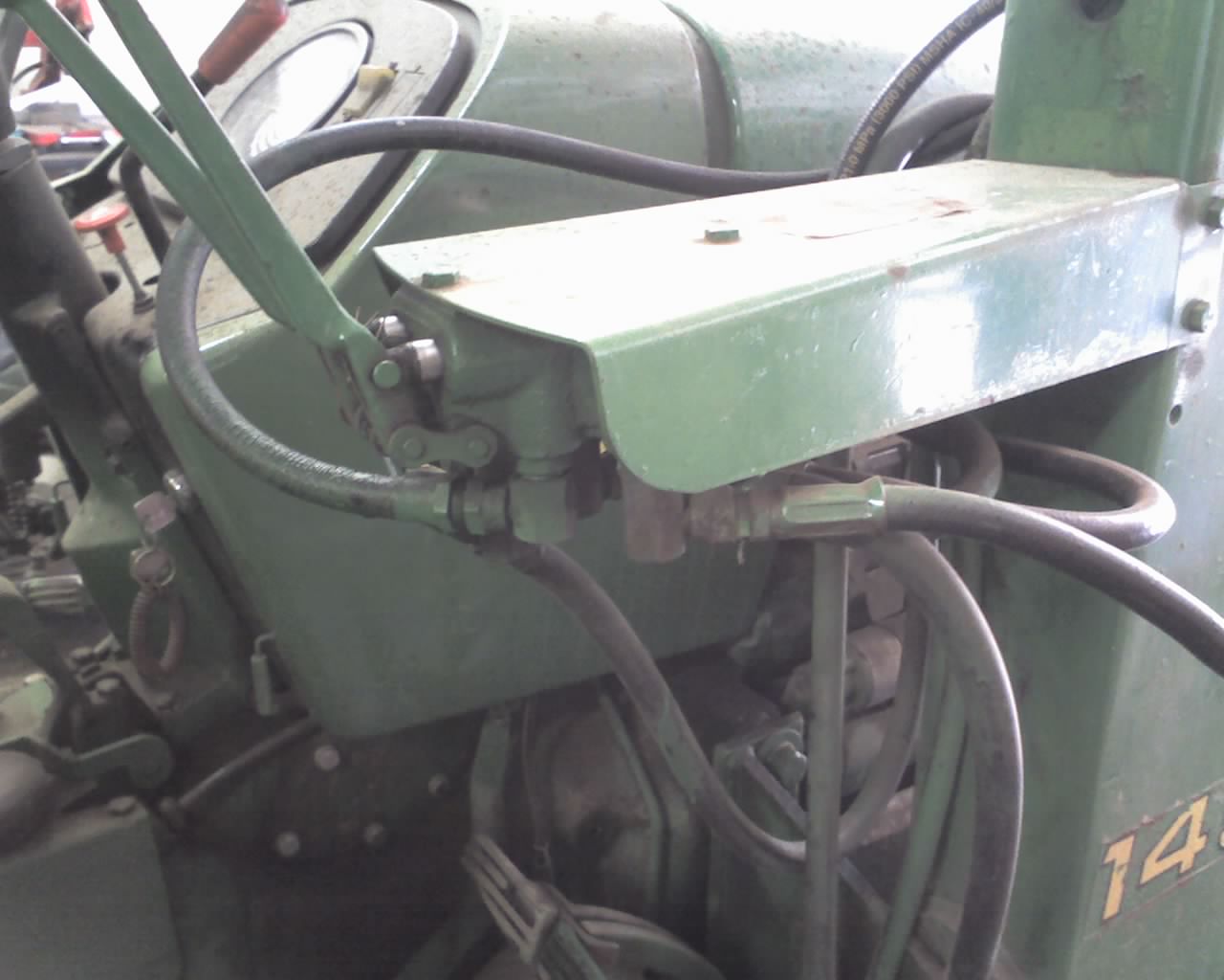

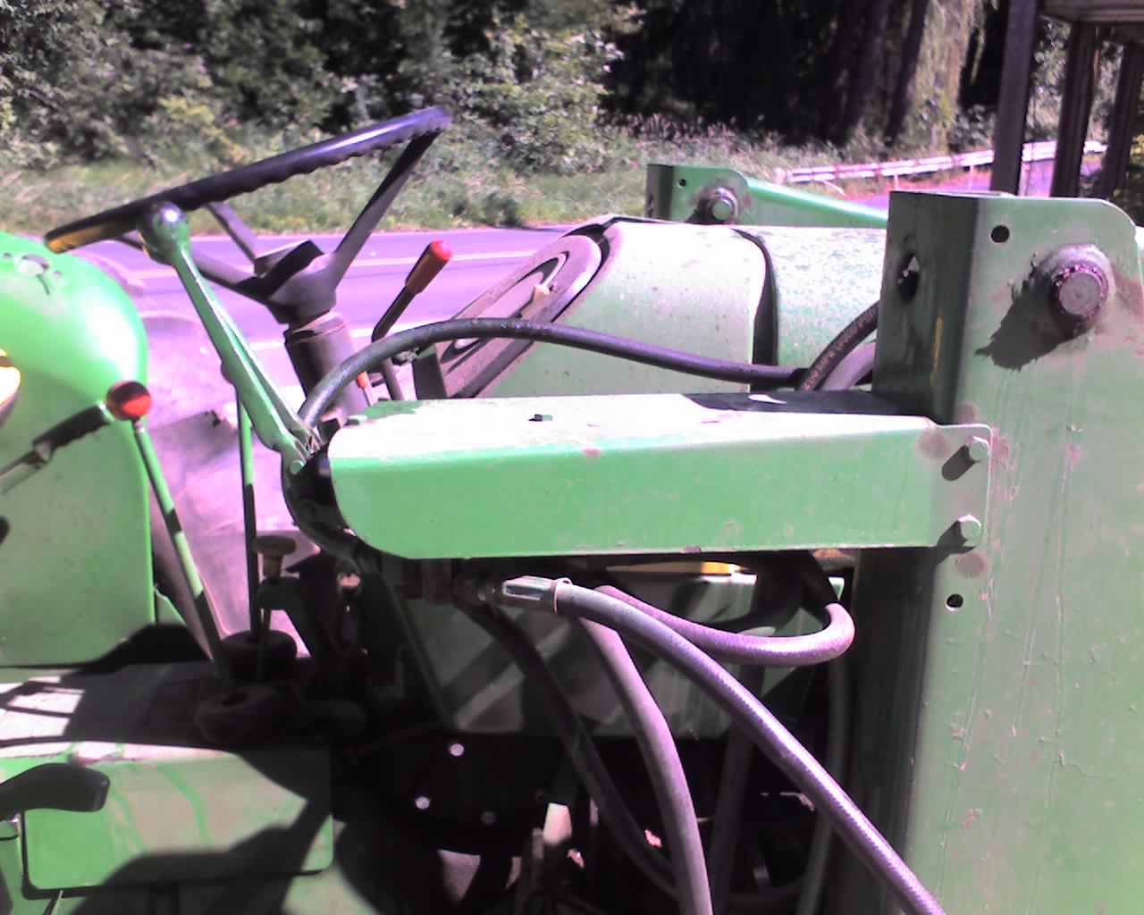

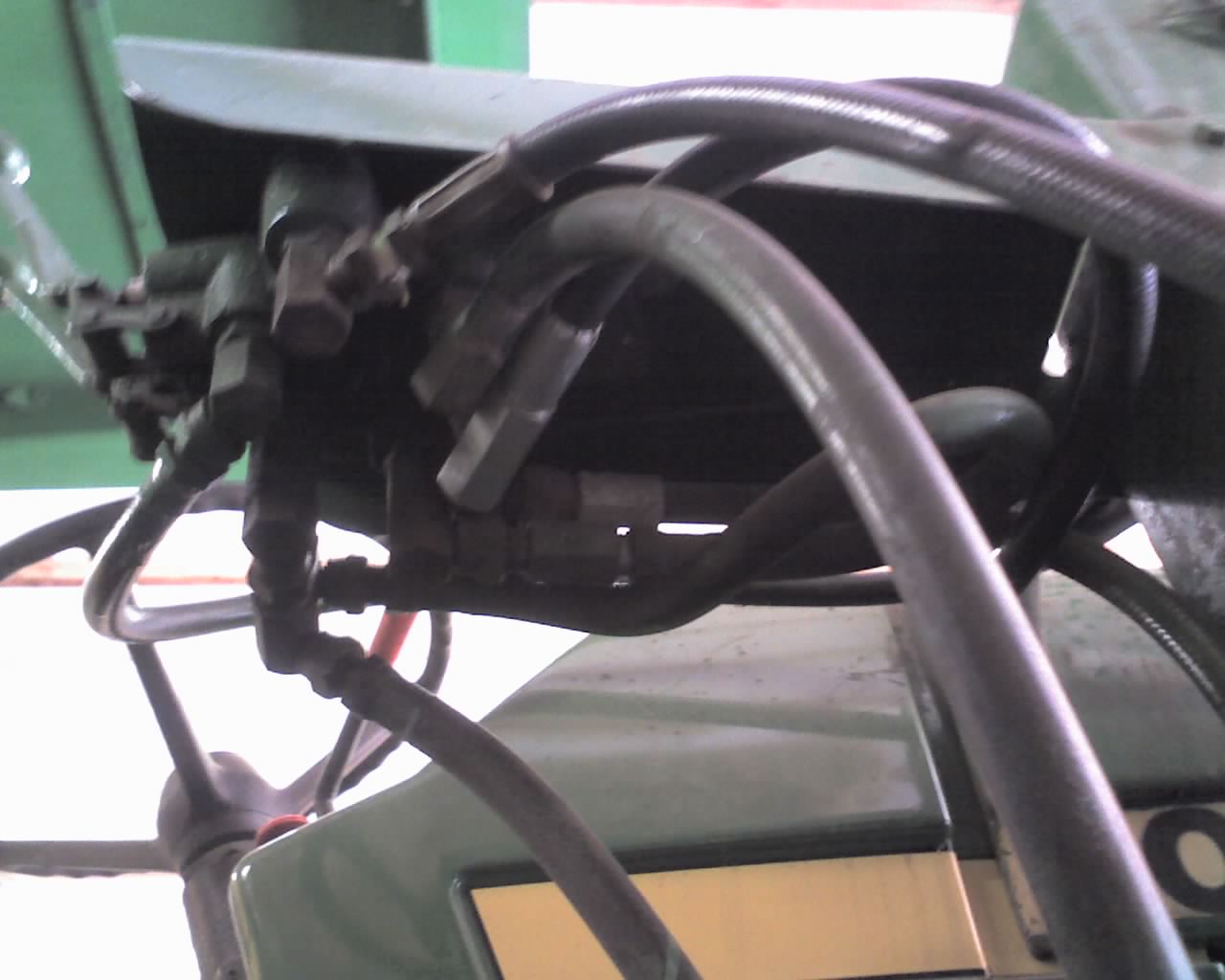

Here's my current loader valve Kenny.
