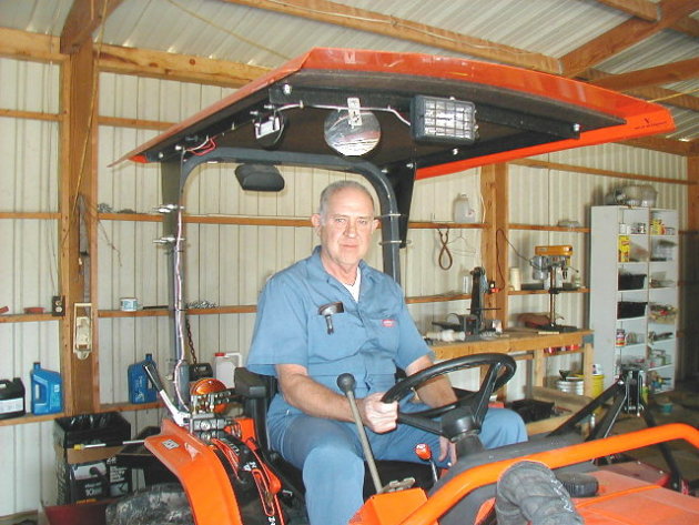

On the frame of my canopy I put a trapezoidal light to the front aimed a bit past the headlight range, and a flood light on the rear. Of course I also had a toggle switch to control them in the frame just above my head on the right, and I had a rear view mirror (later replaced the round one in the picture with a larger rectangular one), and I had two tiltmeters; one for side to side and one for front to rear.

Same as Bird's picture right below your message. They were cheap, about $12each but super bright. I made a switch box with a relay for the switch and fuse to control them and mounted it on the side of the ROPS. A bit of overkill for that much wattage, but that's how I do things so I don't have to repeat therm later. The big advantage of having lights up front versus on or under the ROPS as many do, is that the light is not blasting back at you from the mirror as they do on the ROPs mount and the pupils of your eyes are adjusted to the darkness ahead rather than the brightness of your cowl and dash. Think of driving your car at night with all the interior lights being halogen and on if you mount the lights back on the ROPS instead of up front on the canopy. You have to cock the mirror so you can't see what is going on behind you to keep from being blinded, or at least seriously agitated for having the light coming from behind your head.

Yes, either O'Reilly or Autozone, can't remember for sure. They probably all have similar ones. These have built in swivel mount brackets. I just took the two outside nuts off that bolt the roof plate onto the frame tubing up there, slipped the bracket over the bolt threads and put the nut back on. I had a little project box with aluminum cover, probably from radio shak. I probably had the toggle switch, relay, and fuse holder in my junk. So that made it easy to get the hot from a 40 amp rear power outlet ckt. already on the tractor instead of having to fish wire clear to the very front where the battery is located. The power outlet ckt. had a true ground wire back to the battery too so I didn't need to worry about a frame ground.
You can never have too many lights in a field operation at night.
These lights are so cheap, if I smack a low tree limb and bust one it will be cheap to replace.
