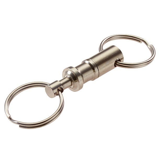

Or, you get one of these and put your ignition key on one end and your other keys on the other (that show's how old my truck is; two different keys), or if its single key, just a duplicate for the door lock, and you're good to go. I have this for my 93 Suburban. Our 2013 Impala has remote start, so no key needed.
