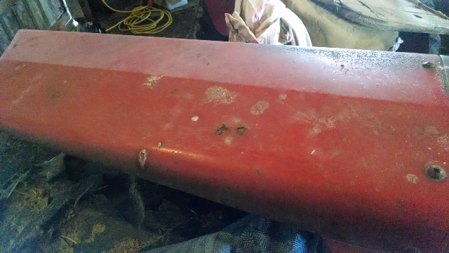

Crowbar, you have a lot of things to learn about: Having clean and dry air, proper repairs and prep, selecting a spray gun, selecting a paint system, learning how to spray paint correctly, choosing the right reducer, as well as choosing, and using primers and sealers, and the proper use of personal protective equipment.
What you need is at least a book, not just some advice.
Here is some advice: The amount of money, and time you will spend, to do all this, even at the most basic level, will exceed the cost of having it done professionally.

If all you need is an HVLP gun, I'd say you're more than capable with little practice, it really isn't that difficult to lay down a coat of paint. Advantage of my $40 gun is I use it to paint everthing I own for the tractors, back blade, drag for our paddocks, will use it on my bucket and forks etc. Like anything, once you own it you'll find 1001 uses for it.
That's only if you're interested at all in doing that of course, to each their own, and that's as much a part of your decision as anything else.

I've been a professional painter for 25 years, I can give you my instructions but this post is correct. Take the parts off yourself and take them in. 3-$400 is a pretty good estimate. My gun costs more than that alone, you'll spend that at least just to get set up. You would also have to buy more paint/clear than you really need(the way it is sold) where they will use out of what they buy. BUT, if you decide to try yourself, ask away.

Spraying is one of those things that look really easy, when you watch someone who spent years leaning how to do it. And, honestly, it is really pretty easy for those who have mastered it. But, there are a lot of things that can go wrong. And, it takes experience to learn how to avoid them, or deal with them, when they happen anyway.
Sure beginners can get lucky, and turn out some decent looking stuff. I sure did when I was a kid.
Unless you are working for someone, becoming experienced can also be costly.

I appreciate everyones comments and advice. If, as mentioned above, I could find someone who would do it for $500 I wouldn't even be thinking about trying it myself. I've got a couple of calls out, but haven't heard back from anyone yet. The head hasn't come back yet and the nose cone isn't here yet either, so I've still got some time to decide. It's entirely too cold right now to paint anyway. I was hoping that I wouldn't have to take the sheet metal back apart, but we'll see.
Just as another point of reference though, I've attached a pic. This is the only place that is rusted through that will need to be fixed. There are dimples on both fenders that will need to be filled with bondo. The dimples are overtop of the underlying structure of the fender and I don't think they can be hammered out. At least "I" can't hammer them out.
