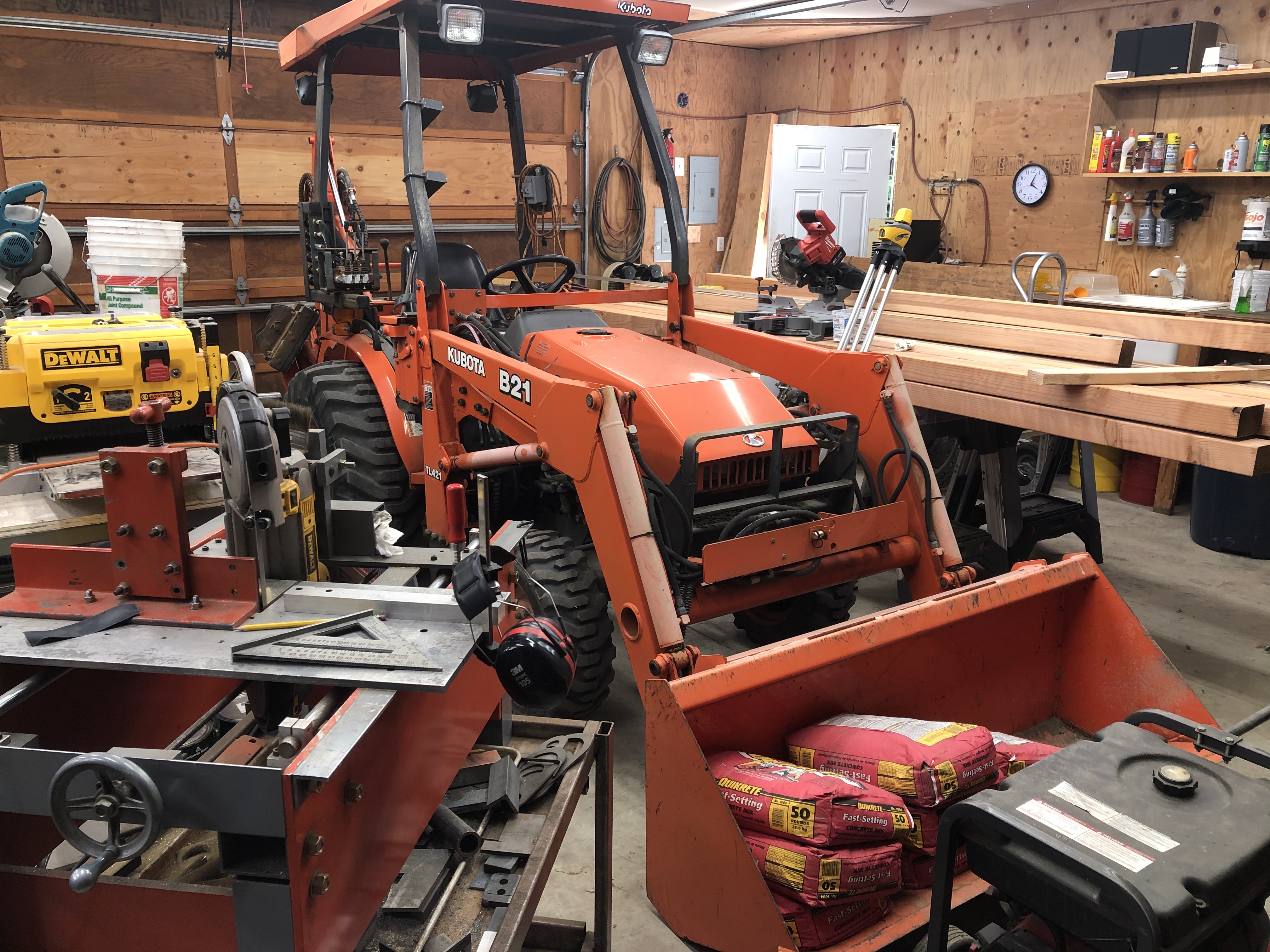

The wood shop is also the metal shop is also the storage shed is also the garage and the generator hut. I enjoy looking at photos of other people's wide open work spaces!

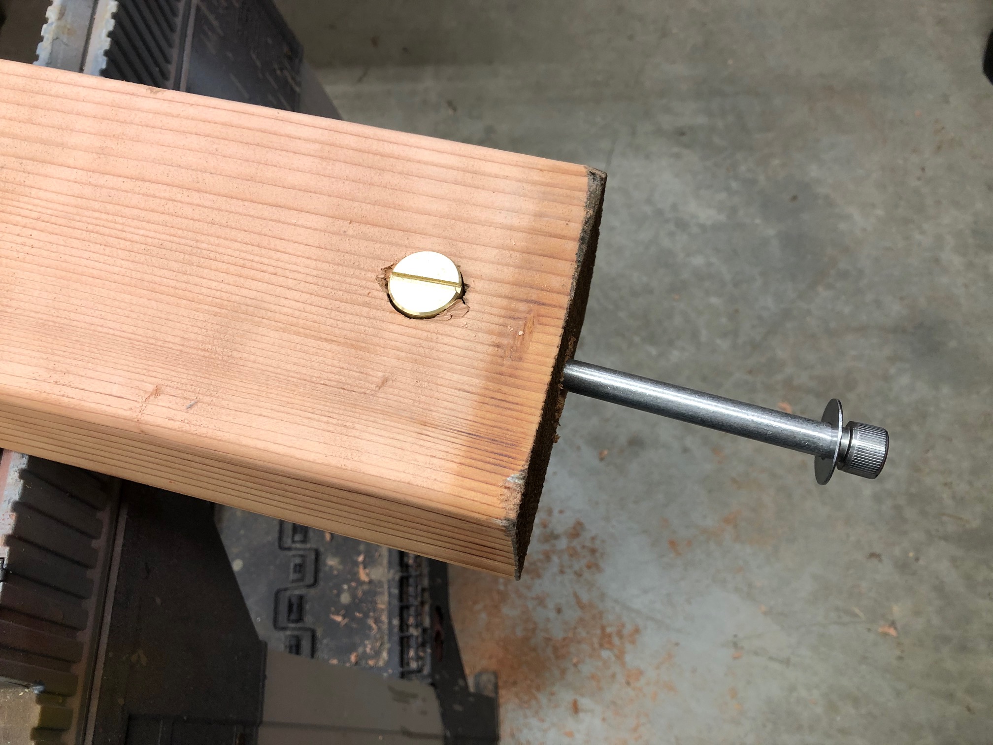

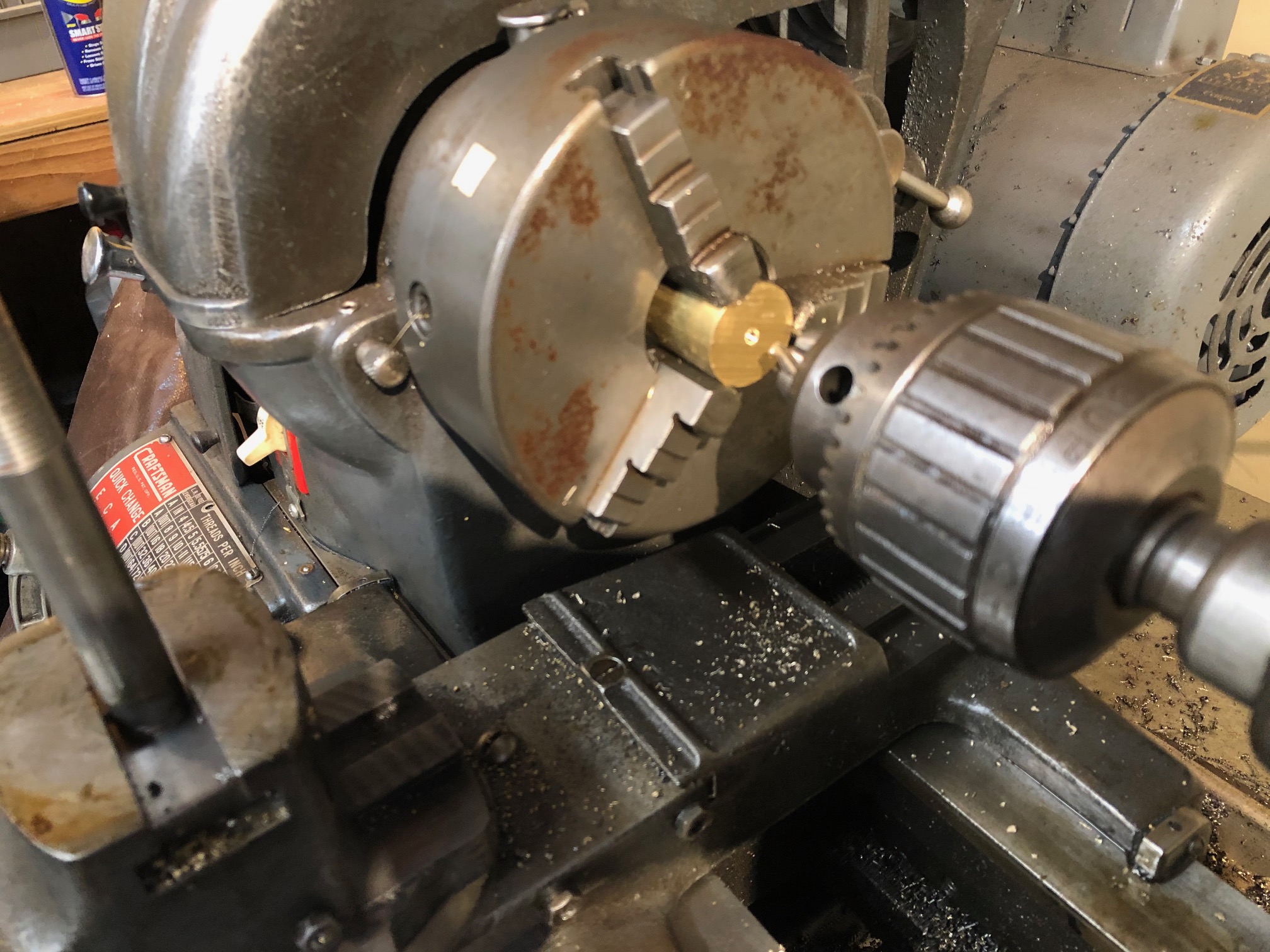

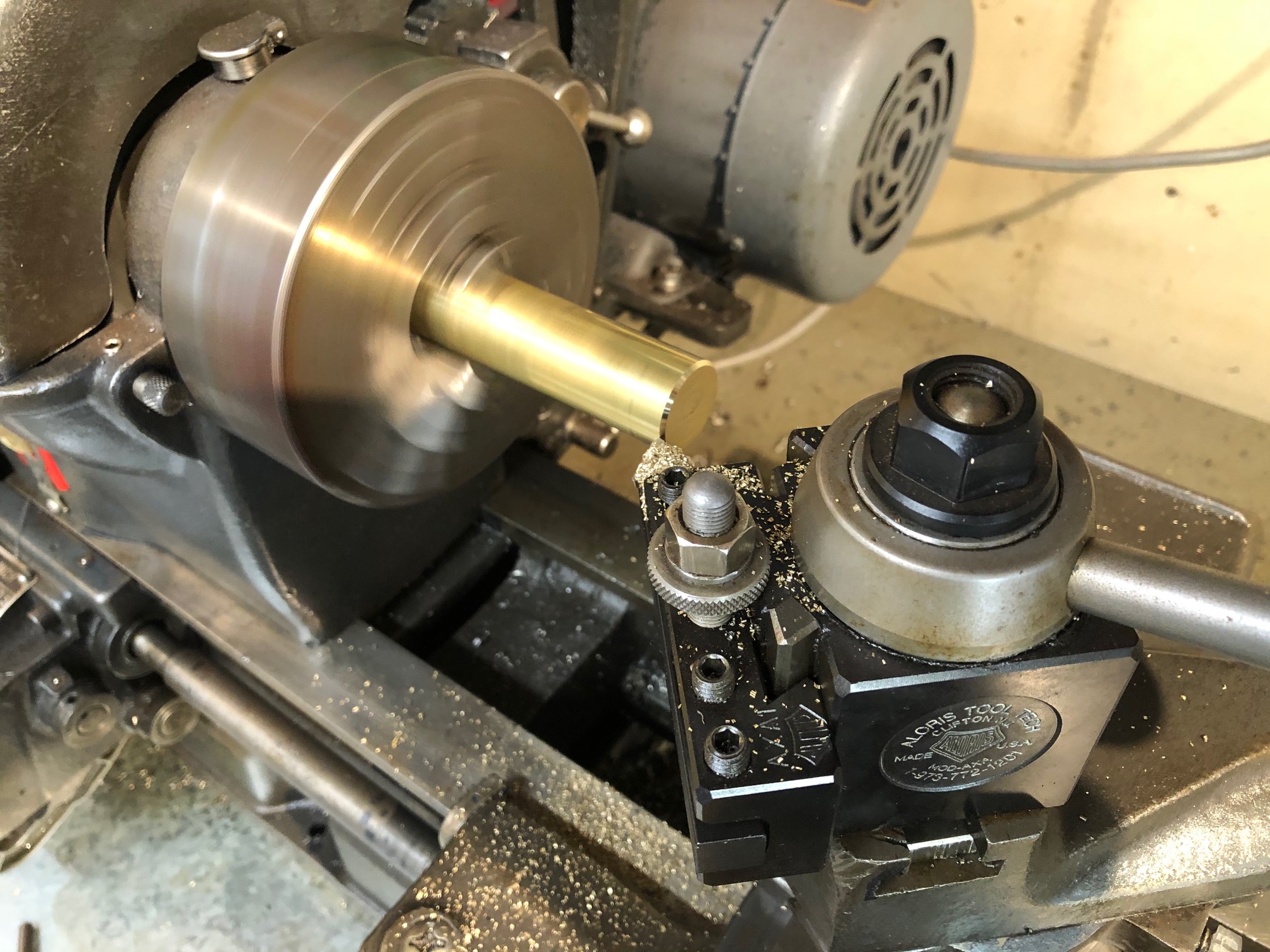

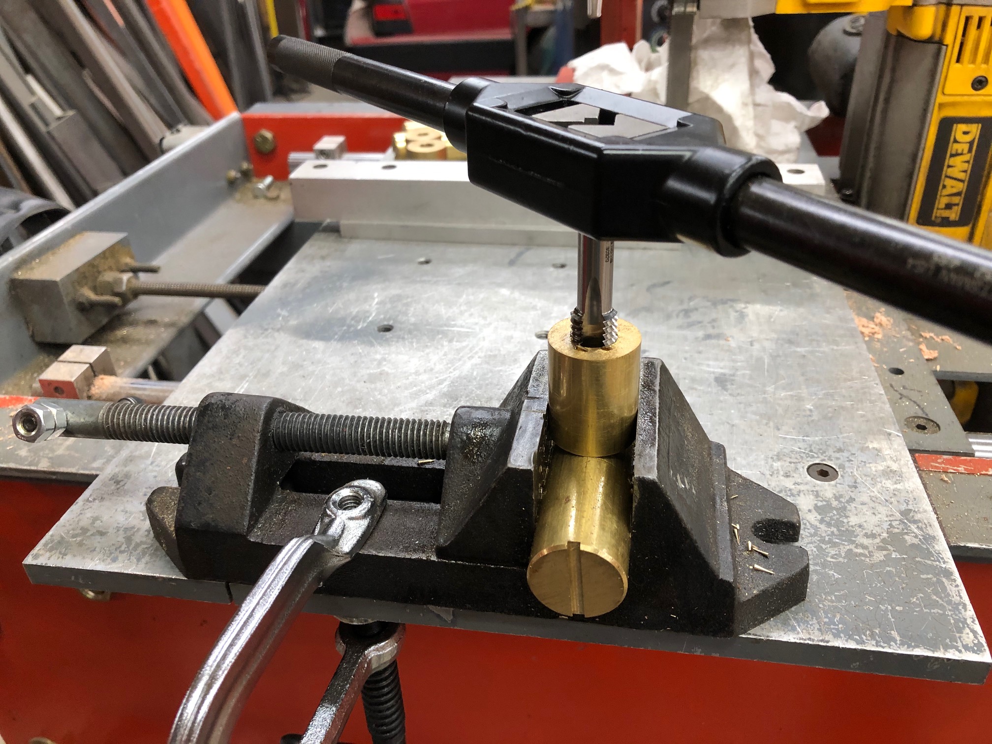

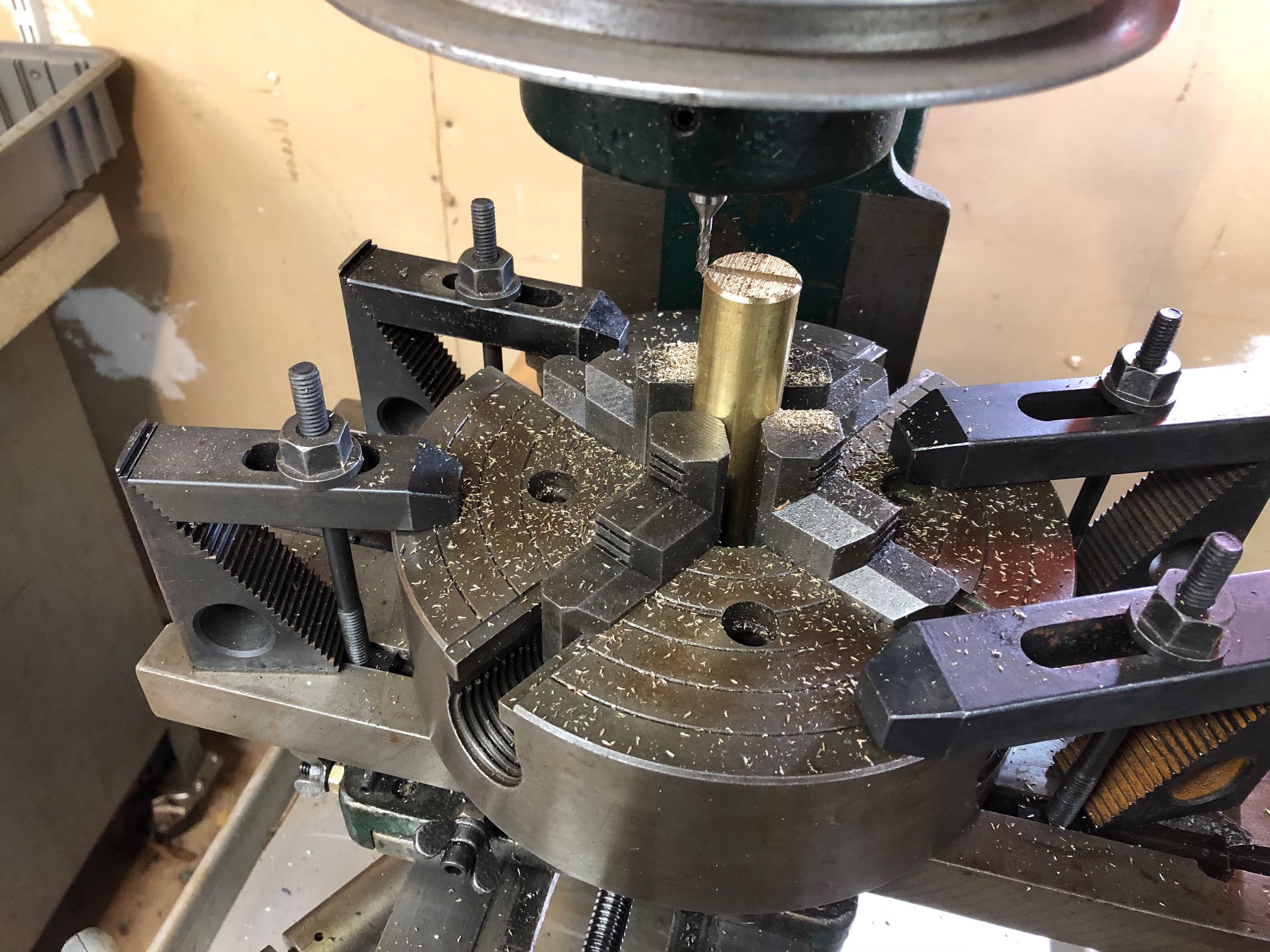

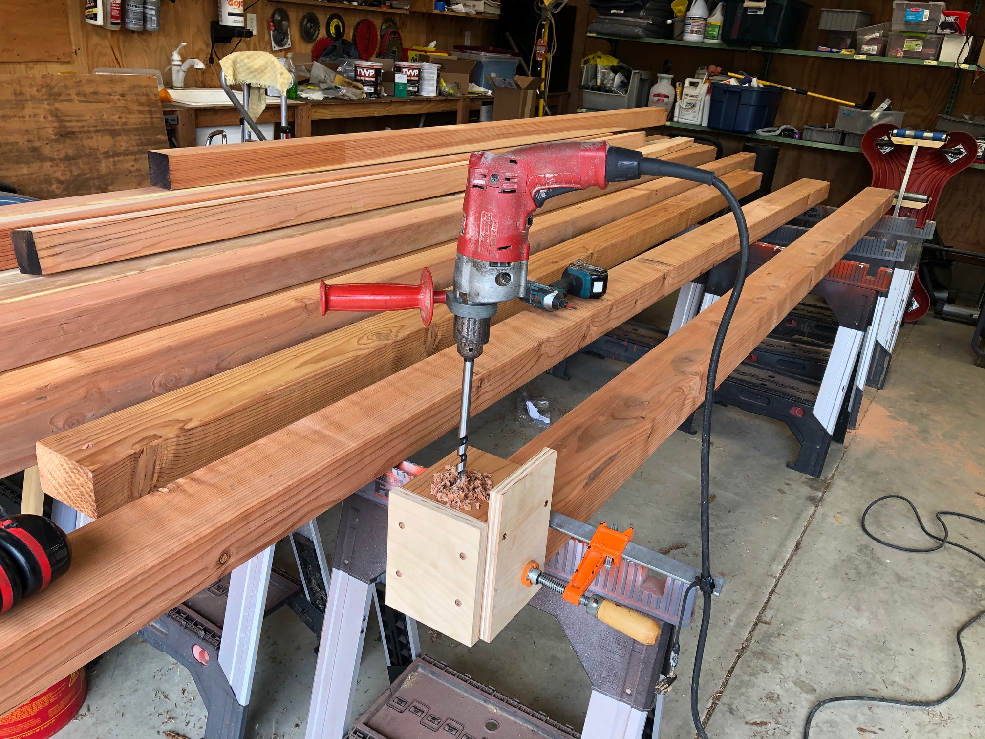

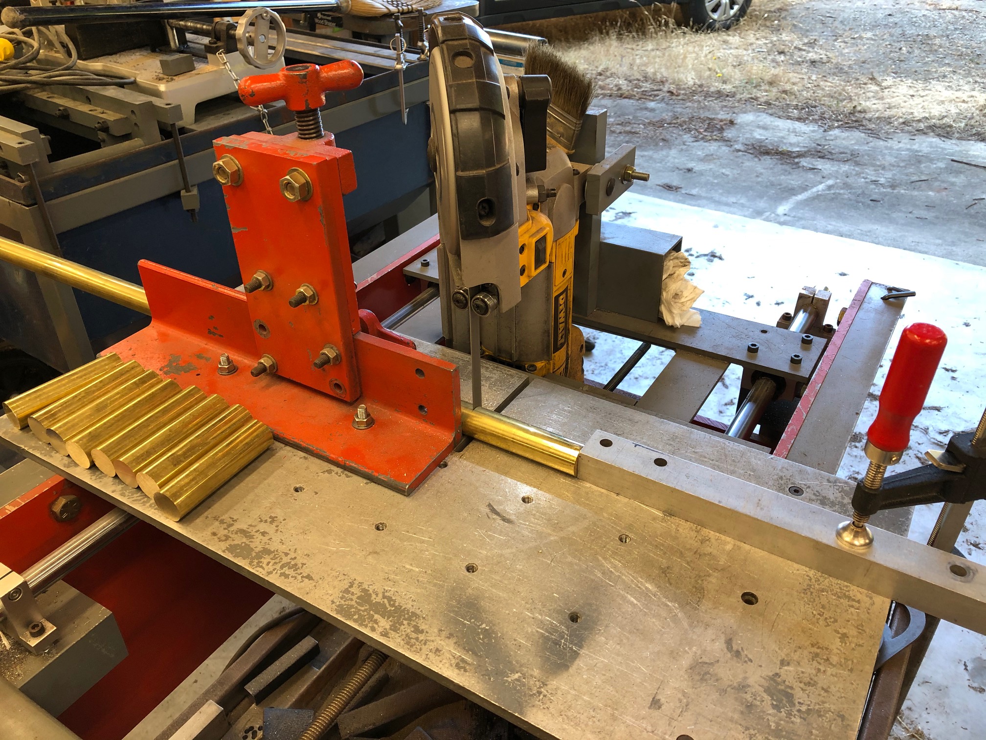

Making dowel nuts to put together the new greenhouse using 4x4 and 4x6 redwood. They are 1" x 3 3/4", could not find that size to buy.
Photo 1: cutting 1" brass rod to size.
Photo 2: chamfering the ends so they go easily into the holes.

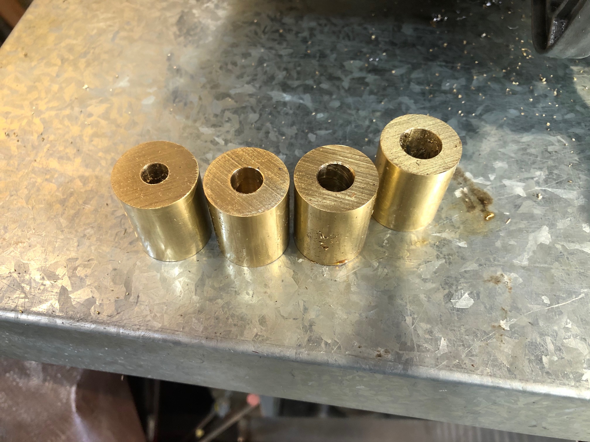

Photo 3: slotting one end to make it easy to align for assembly.

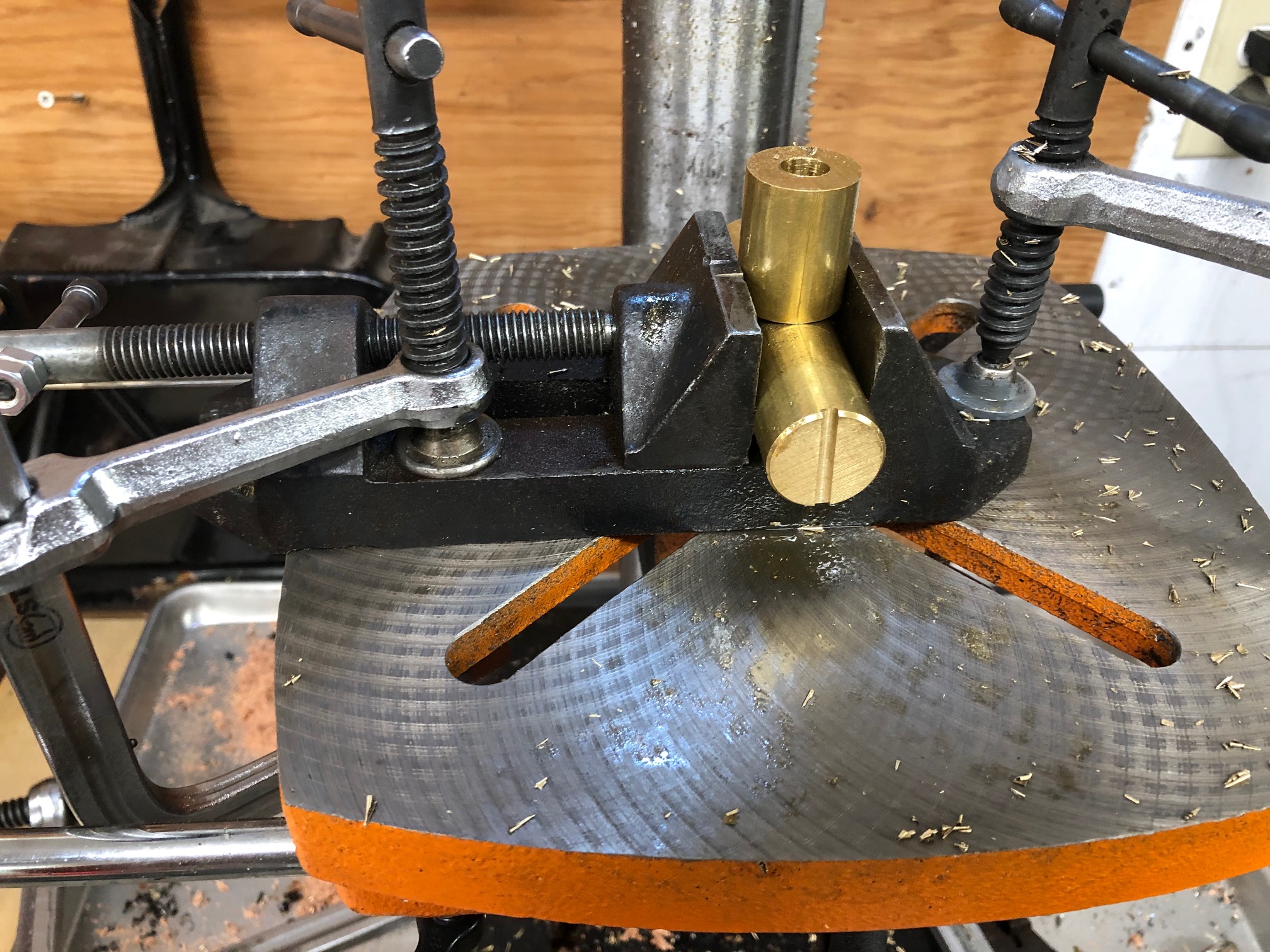

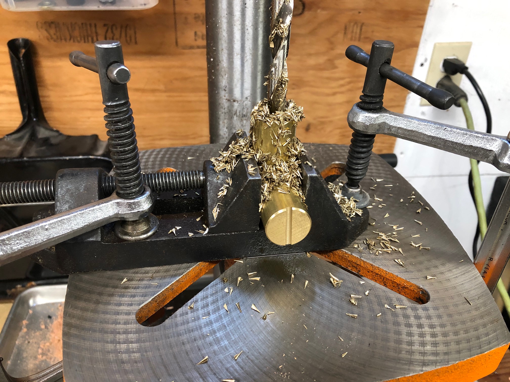

Photo 4,5: making drill guides and tapping guides.
Photo 6,7: drilling holes to be tapped. The drill guide centers the drill on the work piece.
Photo 8,9: tapping the holes. The tap is a "gun" tap which can be turned clockwise through the work without going back and forth.
Photo 10: the assembled fastener.
Photo 11: drilling the holes in the wood pieces with a simple jig to keep the holes square and properly located.

Your lathe looks like same Craftsman I have. :thumbsup:
