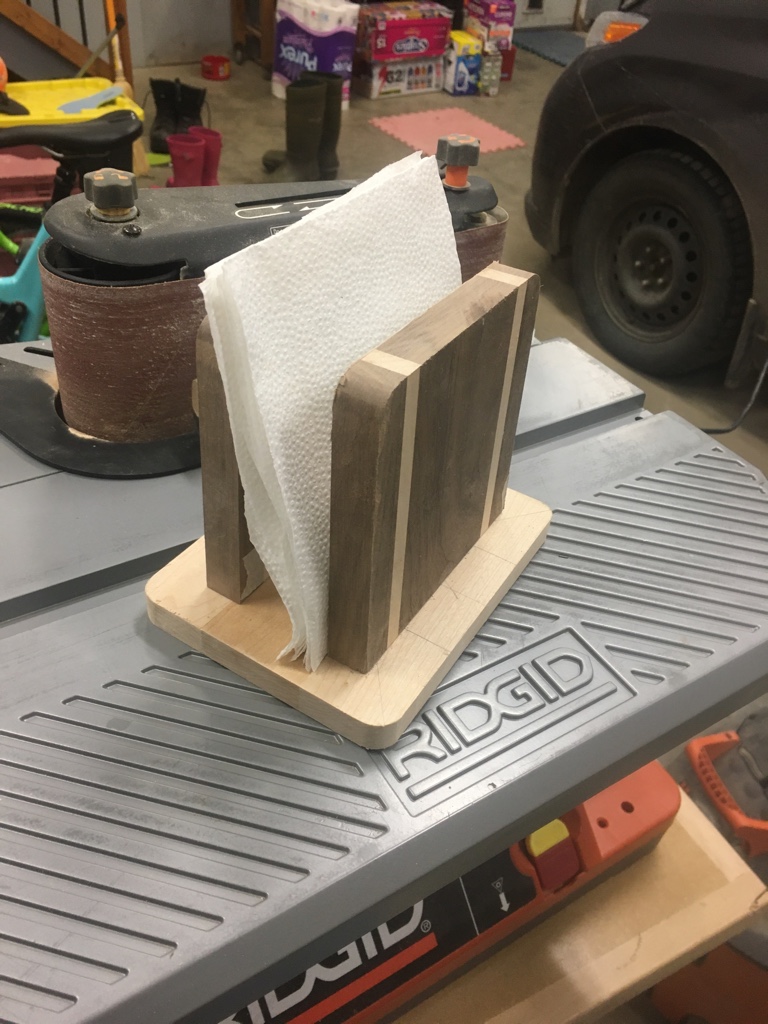

60729301879__90F9649B-25E5-4A0F-BD21-8911615958CB.JPGthis morning the wife asked me to build her a new napkin holder. This is what I came up with. Now for final sanding and to oil it!

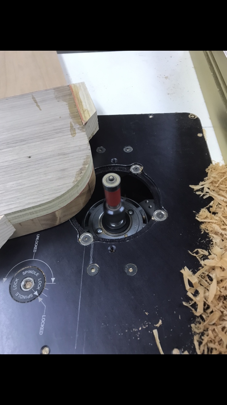

Cutting a radius on the corners and then a round over on the sides would make it nicer. Here’s a trick I use for cutting a perfect radius quickly. For one that small I’d just cut and sand it but for bigger ones I like to make a template to use a flush trim bit with. IMG_8505.JPG

60740210071__D00572C6-A2B7-4087-BE9C-207301A07FF5.JPGyeah. That happened and the round over will also happen, just never got to it yet. Work got in the way.

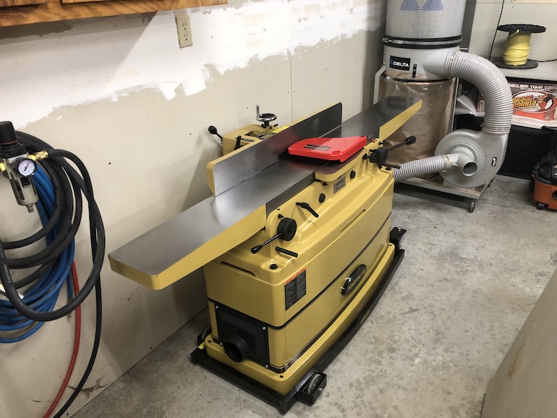

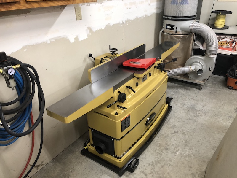

Great day today... besides getting my propane heater finally working in my shop (its own thread) I also unloaded and placed my new 8in jointer in my shop. Time to read the manual then turn it on and make some chips.

What a beauty ! Any projects planned??

Thanks... surplus sale... some scratches and nicks, pretty much new. A heck of a deal. Projects... yes, too many to count... a bookcase, a shoji screen room divider, a Murphy bed for our closet/extra bed space. Figured I better make sure I am outfitted before retirement. Pretty sure there won't be big tool purchases on a fixed income unless my tools are generating some.
My 6in jointer is now on the block. Hard to sell online these days due to the lock down. Running out of room!

I had a grizzly 6” before I bought my Powermatic 8”. I hung onto the grizzly for a while thinking there might be some use for it. I finally sold it and haven’t missed it.

Was thinking the same... 'hey I might use it... who am I kidding?' :D

She's a Beauty Dragoneggs did you get to run some test pieces through it yet? How is the set up from the factory ? Most new equipment needs some tlc. There is a good video by the wood wisperer on utube on that exact model check it out.:drink:

I've had my 8" Rockwell jointer since the early 80's and it's amazing how much more useful an 8" is over a 6". It seems most buy the 6" first, and then learn it's a mistake to do so, myself included.

My 6” was bought only out of affordability. I was 19 and going to school for fine woodworking. Our school shop had multiple 12” jointers so I knew the value of bigger ones.
On my list of future tool upgrades is either a new tablesaw or a new fence for my 1962 General, a band saw and a bigger jointer.
