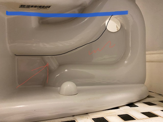

I'll snake it before I pull it but it is flushing fine so I doubt that's it.
The more I look at this toilet the more certain I am that it is not a crack. As mentioned the 'S' pipe is a true 'S' and is completely out in the open underneath the toilet. I can see the whole thing; both sides. Any crack in the part of the 'S' pipe that holds water would be visible and leaking onto the floor.
At this moment I'm betting on a vent pipe issue but still not clear in my mind how that could be the case.
My wife, generally the wiser and more prudent of the two of us has recommended that I get over it and leave the thing alone since it is working properly and their are no obvious external leaks.

Have you tried a toilet snake? Maybe something got partially flushed and creating a siphon. I worked in a hospital maintenance department for 19 years found a lot of weird things happen.
Ah, like when you have a stoppage or partial stoppage in the S trap, the water in the bowl goes down slowly after a period of time. When you use the plunger and get what ever is in the S trap out everything works again...I can see that.
   / Toilet Mystery #24
If you look at the toilet test video previously posted, that toilet was determined to have a leak in *it's s-trap* -- as in, internal to the toilet. There's a leak inside the toilet, not in the plumbing below the toilet.

N80,What you are not taking into consideration is that toilets are cast in 2 halves then joined before firing in a furnace. The crack is actually a manufacturing flaw running between sections of S trap. Does that help understand how crack can join upper and lower part of S trap?

If the water is being "sucked out" as opposed to leaking out, could you wait until it is empty and then use smoke to verify? Seems like if there was enough suction to pull water out there would be enough suction to pull smoke too. It may not work, but it doesn't take any dismantling either.
Yes, I understand that. I don't think I'm explaining how this toilet's 'S' pipe is constructed very well. I'll try to link to a picture so it might be clearer. But again, the top of the 'S' does not share a common wall with the lower part of the 'S'. The upper part of the 'S' holds the water. See below. The normal water line is marked in blue. The little bridge between the upper and lower parts (red arrow) is structural. The porcelin in the middle is just a thin layer( red squiggle). So if there was a crack in the upper pipe it would have to be in the floor of the upper 'S' pipe outlined in black. You can see that there is no way that it would communicate with the lower part and thus allow water exit the house via the drain pipe.
I hope the picture helps and I hope I'm thinking about this right.
   / Toilet Mystery #29
If the thin support boss was leaking the bowl would drain completely. Blue line indicates the 'trap weir', typically above '1/4' remaining level of that model. The pipe's vent may be blocked from something on a higher floor, perhaps at a tee between them. NA if this is the top floor. Snaking or cam from the roof may be indicated (love to) but not this time due to logistics.
This is a classic symptom of a vent blockage somewhere above the fixture and suction break to stop it. That would come when the water level is down to the top of the S pipe where it connects to the bowl, siphoning until then. It's so common in fast food store remodels where stuff had to fit the floor plan vs getting proper rework I bet every guy over 30 has seen it more than once where they eat out of paper.
If the bucket test sucks down like when flushing there may be a clog below and a blockage above. What kinda critters could cause something? Wind-blown plastic bag snags on vent? Hmm... btw, Why it doesn't drain faster is because vacuum accumulates until it breaks at the stool.
   / Toilet Mystery #30
Well, I've been watching "How toilets are made" videos all night... (thanks, by the way :ROFLMAO: ) and your toilet was most likely cast in one piece, from the videos I watched.
That's gonna move me to the "a vent is probably blocked" team.
Good luck with your investigation.
