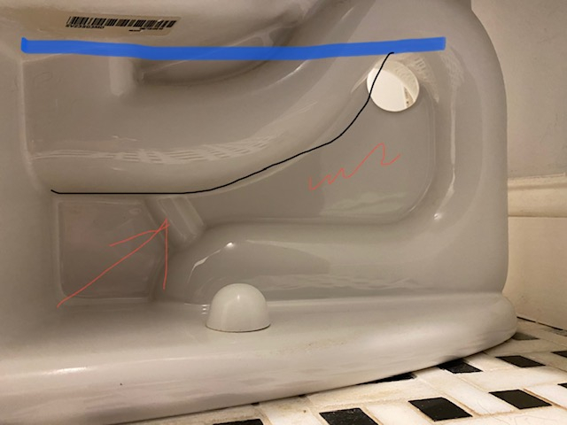

Yes, I understand that. I don't think I'm explaining how this toilet's 'S' pipe is constructed very well. I'll try to link to a picture so it might be clearer. But again, the top of the 'S' does not share a common wall with the lower part of the 'S'. The upper part of the 'S' holds the water. See below. The normal water line is marked in blue. The little bridge between the upper and lower parts (red arrow) is structural. The porcelin in the middle is just a thin layer( red squiggle). So if there was a crack in the upper pipe it would have to be in the floor of the upper 'S' pipe outlined in black. You can see that there is no way that it would communicate with the lower part and thus allow water exit the house via the drain pipe.
I hope the picture helps and I hope I'm thinking about this right.

If the thin support boss was leaking the bowl would drain completely. Blue line indicates the 'trap weir', typically above '1/4' remaining level of that model. The pipe's vent may be blocked from something on a higher floor, perhaps at a tee between them. NA if this is the top floor. Snaking or cam from the roof may be indicated (love to) but not this time due to logistics.
This is a classic symptom of a vent blockage somewhere above the fixture and suction break to stop it. That would come when the water level is down to the top of the S pipe where it connects to the bowl, siphoning until then. It's so common in fast food store remodels where stuff had to fit the floor plan vs getting proper rework I bet every guy over 30 has seen it more than once where they eat out of paper.
If the bucket test sucks down like when flushing there may be a clog below and a blockage above. What kinda critters could cause something? Wind-blown plastic bag snags on vent? Hmm... btw, Why it doesn't drain faster is because vacuum accumulates until it breaks at the stool.
Well, I've been watching "How toilets are made" videos all night... (thanks, by the way :ROFLMAO: ) and your toilet was most likely cast in one piece, from the videos I watched.
That's gonna move me to the "a vent is probably blocked" team.
Good luck with your investigation.

Venting is proscribed to keep keep effluent velocity up & prevent suction that can siphon traps. Drawn to some low point the trap will let air into the drain. There'll always be a bit of water left.
The trap is there to hold more water, up to it's weir (rt end of blue line) the vent is to keep it there by preventing pressure/vacuum excursions in the drain system.

My sort of logic....Water is going from the front of the bowl. Is it going over the floor...No. Is there any damp patches...No.. So it must be going down the back part of the U bend. [ruling out dogs]. Is it being sucked out by vent problems....If a vacuum was `pulling` it out, the vacuum would be lost as soon as the water level got to the bottom part of the U bend, and the water level would stay at that level. Is there a gap between the final water level and the bottom of the U bend, ..if yes the water is going straight from the front to the back by a `hole or crack`. That `hole or crack` being at the same level at what the water level settles.
