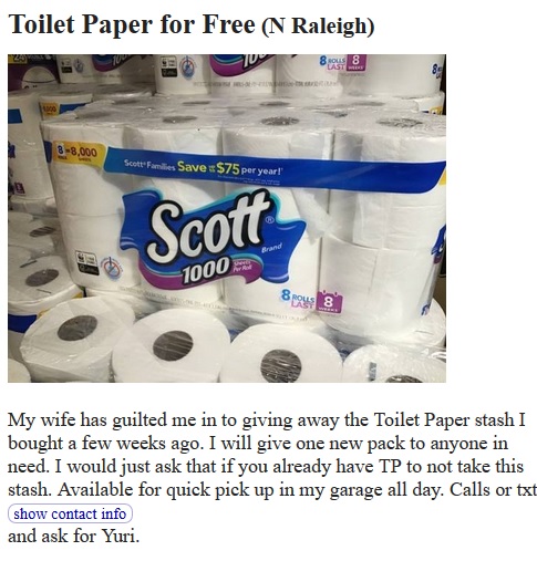

Saw this in Free Section of Craig's List this morning:
If it's fake and they posted someone else's number (sorry but that's funny - except if they used my number!?!!?) :D
Read a story about a local prank, bored teenager put up ad on CL for toilet paper with his Dad's phone number. Dad started getting all these calls.. felt he needed to help these folks out.. he took them some toilet paper, got some donations for more, been running around delivering TP for those that are out...

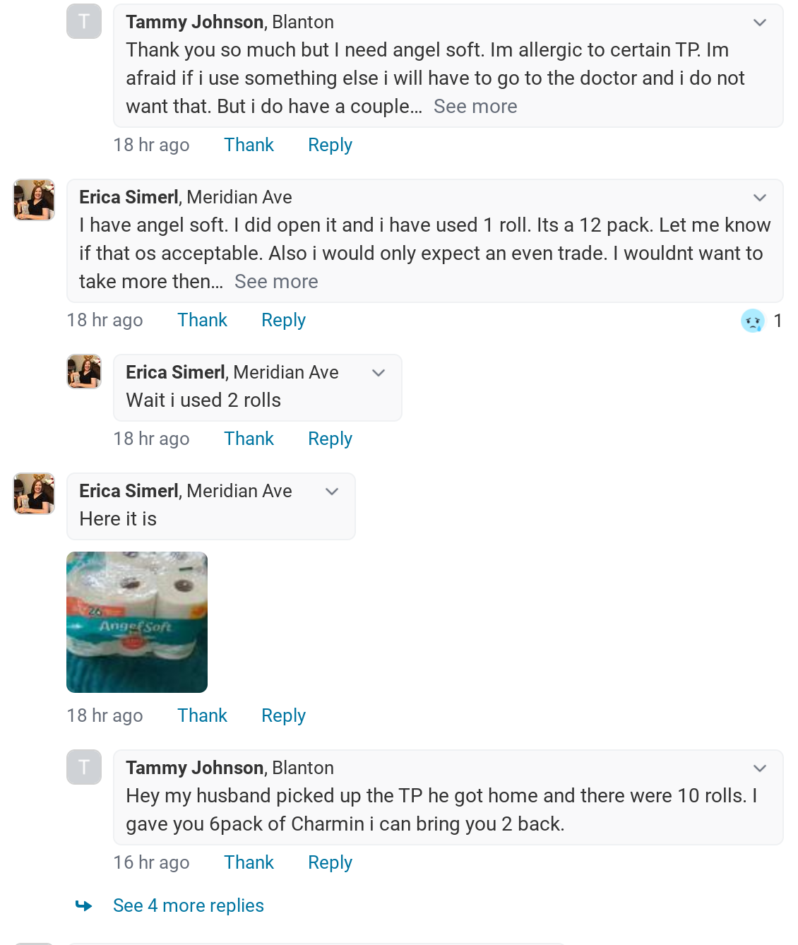

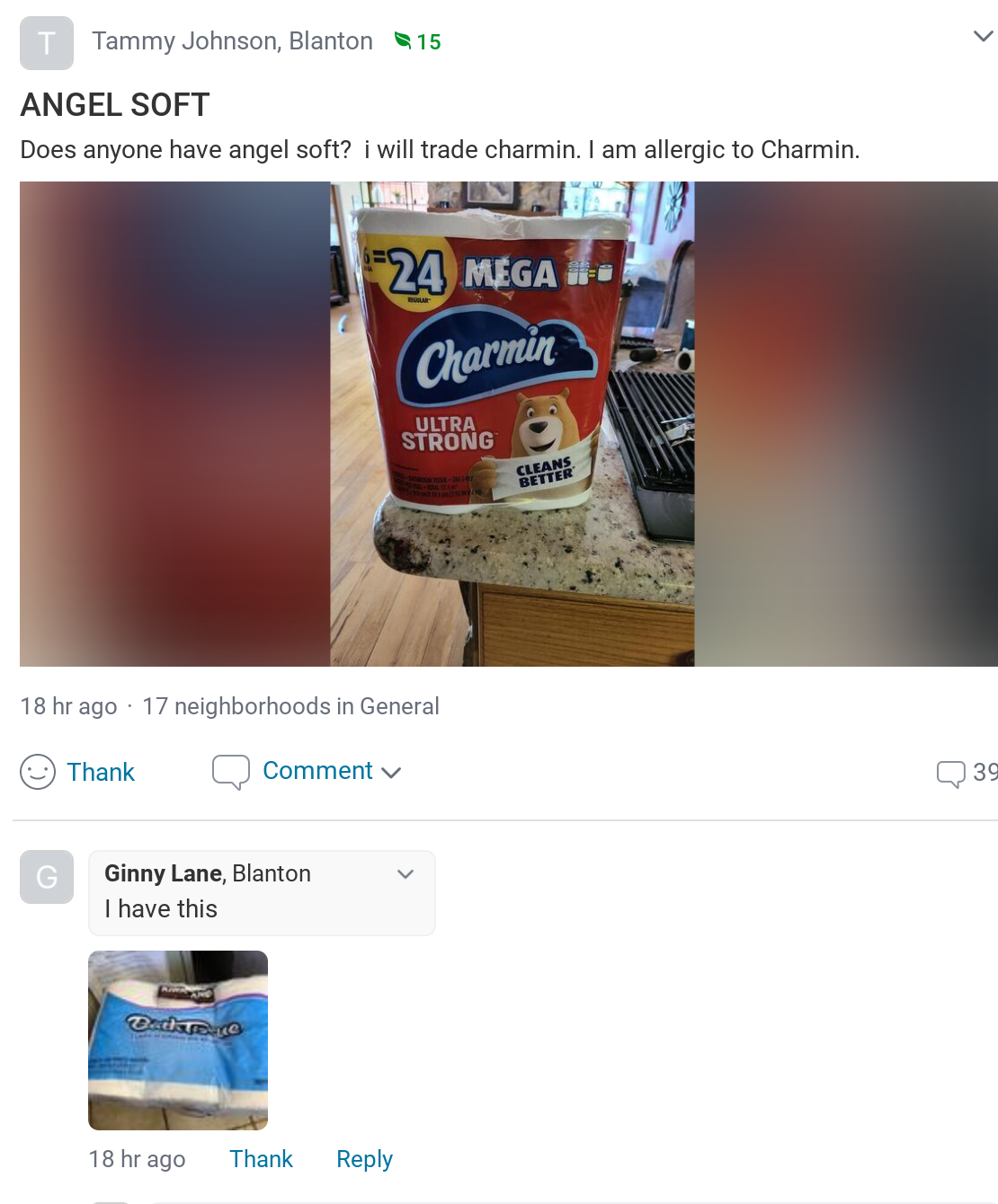

My wife saw this on the local Nextdoor app yesterday and at first I thought it was a joke but apparently not, luckily there were several people that came to Tammy's rescue.
Screenshot 2020-04-03 at 8.46.29 AM.pngScreenshot 2020-04-03 at 8.43.02 AM.png
