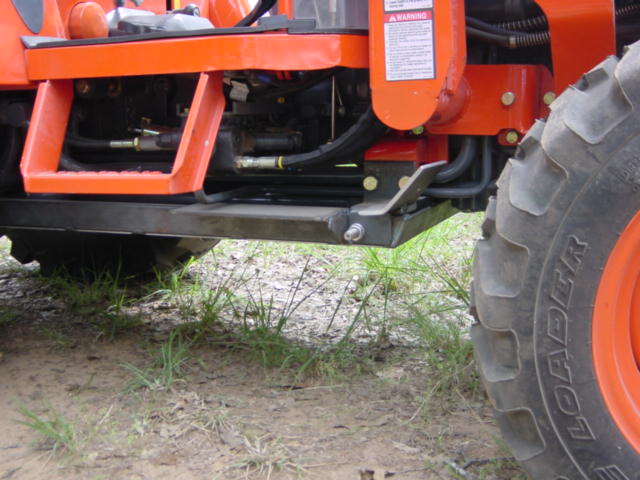

Anyone have a skid plate attachement idea for the CK25??
Yep, a must at my place.

Nice work RedRocker. Too bad there isn't a big market for it - would make a nice niche business and maybe some good $$ for you. I'm surprized you didn't paint it orange ;).
   / Took me less than two hours to #15
Very nice work Redrocker! An underside view would be nice too ;) !

An old Jeepers trick... Straighten the tie rod best you can. Then, set your toe-in. Now, weld a pies of 1"-1.5" angle iron on there. It will strengthen it, and if placed correctly, act as a skid too.
Common issue with hard rock 4x4's...
