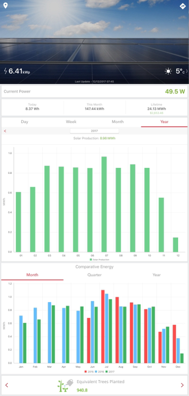

I have 6.405KW system up. If you don't have net metering in your location it's very hard to make a financial argument for a system. If you have net metering, and plan to remain in your home for 12-16 years more, or think you can recover your capital investment upon departing in increasing home value, it's a winner. I wouldn't borrow money to do it... With the cost of the money added in, it's not viable. If your tax savings drop you into a lower tax bracket that could be something to consider too, realizing it's a one time event. I have 21, 305 LG panels up and use SolarEdge system. Fully investigate SolarEdge, it's simply the best way to go, no need with net metering for batteries, unless you want to use battery like an emergency generator, in which case you'll be weighing cost of batteries and their maintenance against a ICE generator and its maintenance and cost. Again, if you don't have net metering, it's a loser!!!!

For a 7.59KW 22 panel system with installation it comes out to $29k. after federal tax credit of $8,600 takes total system cost down to about $20.5k
We have high electricity costs. First 200 kw hours are at 10 cents per, after 200 its 23 cents per.
Instead of paying the electric company each month I will now be paying that money into a system I own. Did the 12 year loan option at 2.99% interest through a local credit unit and my monthly payment is equal to that of my average electrical costs
