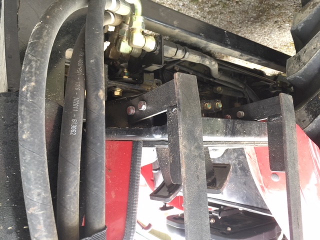

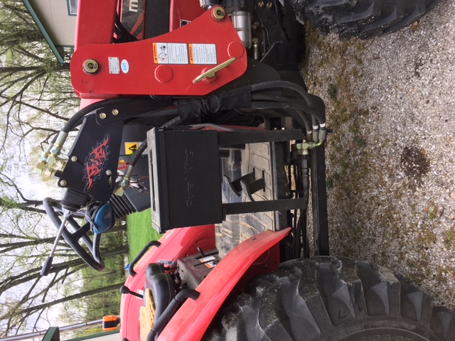

If you did no modifications, how did you attach the ammo box? Thanks in advance.
The step that the box is mounted to has a bunch of approximately inch diameter holes in it for drainage or traction I guess. I drilled holes in the bottom of the ammo box and put bolts down through the holes in the ammo box and then down through the holes in the step and then put a fender washer with a bolt on the bottom. It is very secure.
The step that the box is mounted on has a bunch of approximately inch diameter holes in it for drainage or traction I guess. I drilled holes in the bottom of the ammo box and put bolts down through the holes in the ammo box and then down through the holes in the step and then put a fender washer with a bolt on the bottom. It is very secure.
Got ya. The 2538 does not have a step there stock. Maybe adding one is the way to go first.

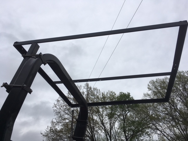

Here are a few items I have built for my 2538. I haven't finished the sunshade yet.Still trying to decide what to use.
