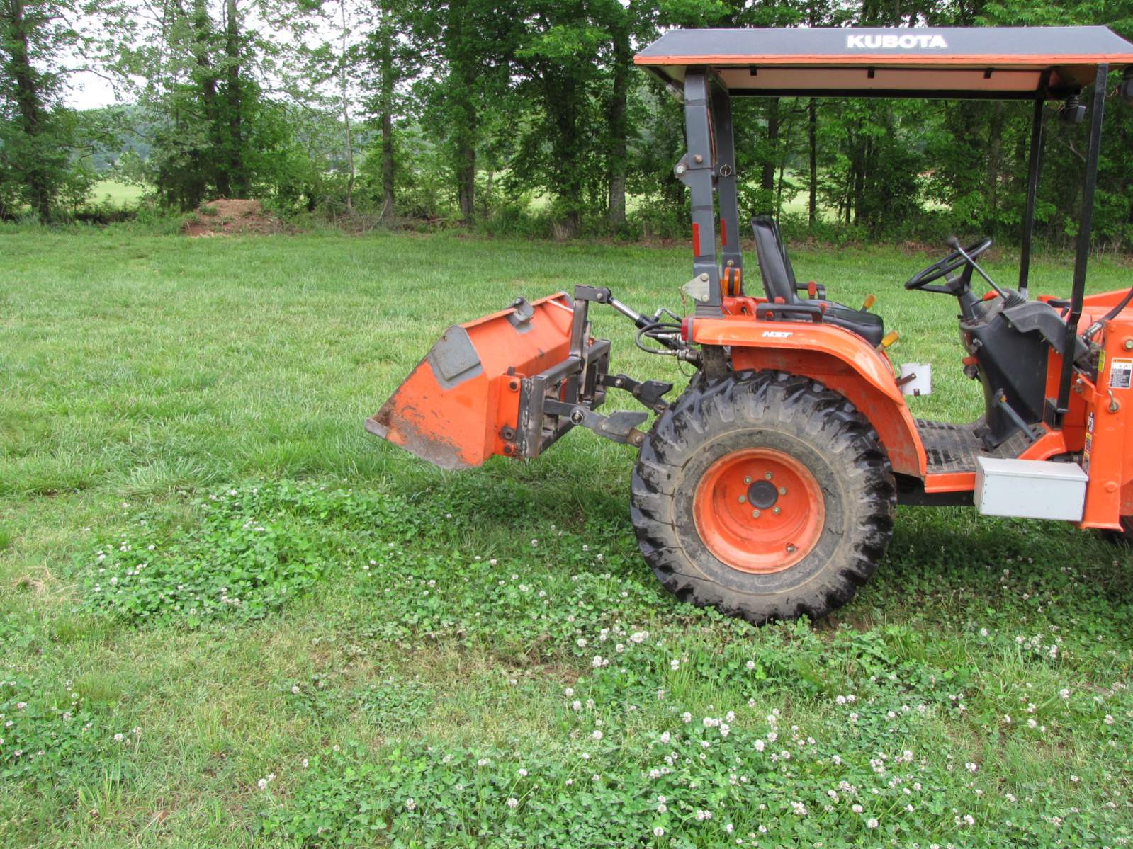

Well done. Tell us about that rear loader bucket? Drop it, back into a pile, lift and tilt?

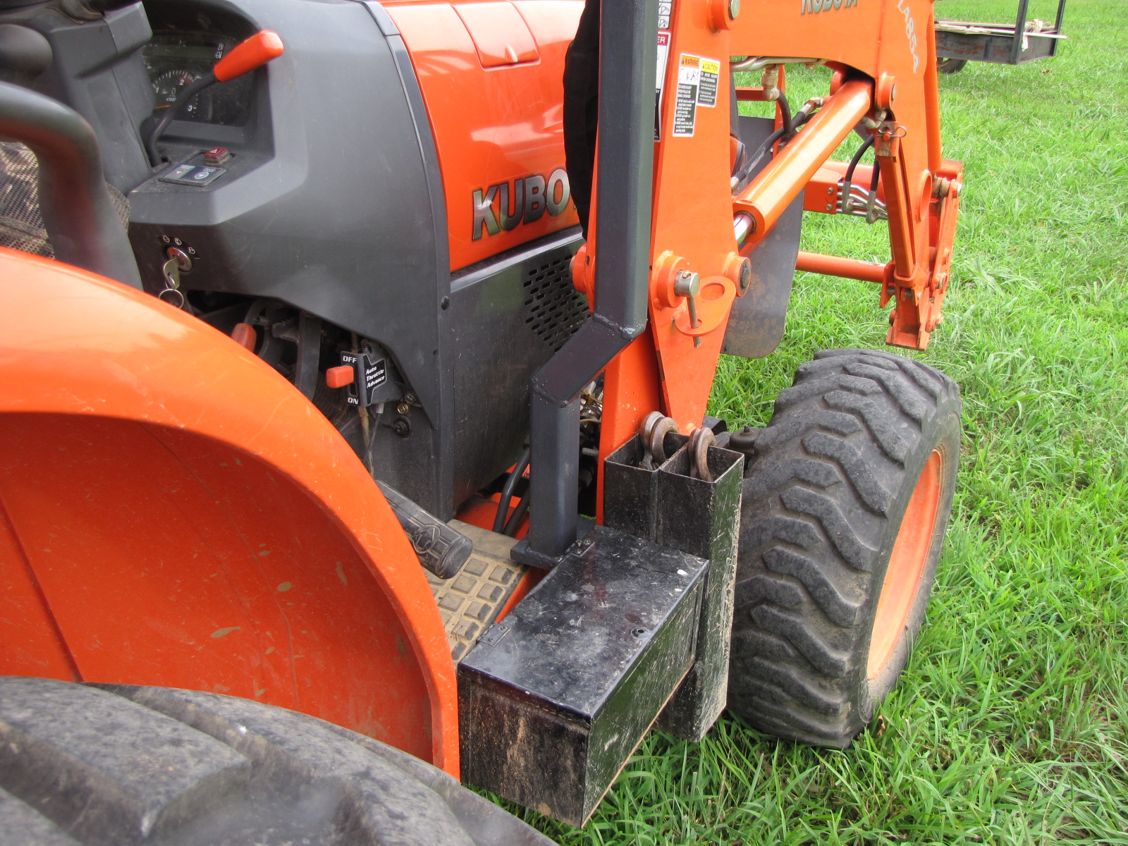

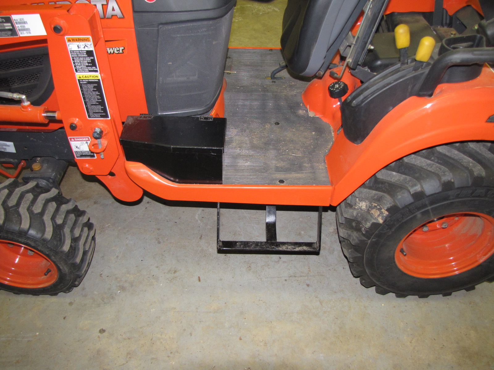

Here is how I did mine on the L4240, the B7800, and the BX2660. I made all three boxes also.
Can I see a front view of that chain holder? That is a genius idea. I assume there is a hole or two fro water to drain out each chain box? (sorry "chain box" in middle pic)

I'll take some tomorrow. You are talking about the L4240 right?
/ Tool Box Mounting Pictures #25
I took a picture, but not a lot to see. Couldn't get a picture of how it's mounted. The loader upright had a big hole in it not being used so I used it. I welded a 1/2" bolt near the bottom of a 3" X 5" thin wall tubing. Then welded a 3/8" bolt near the top of the tube. Had to drill a hole for the top bolt into the upright. The 2nd tube is 3" X 4" and just tacked welded on to the other.
Took a picture of the other side so you can see the one I put there. Also I wanted you to see my grabber I maded. I have about $550.00 to $600'00 in the grabber, bucket and the teeth. The teeth cost me $200.00 just by themself,so that well tell you what I have in the rest of it.
