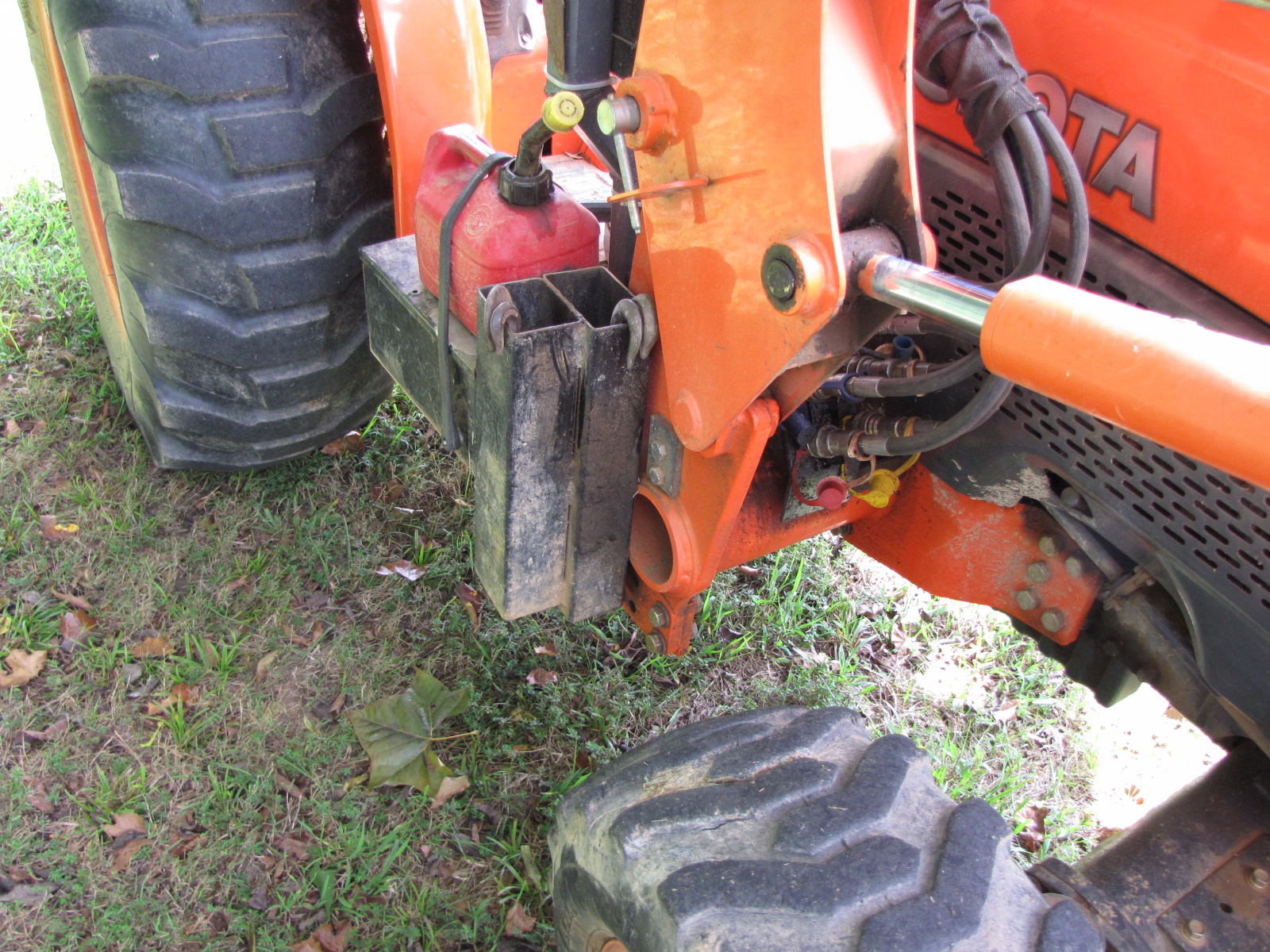

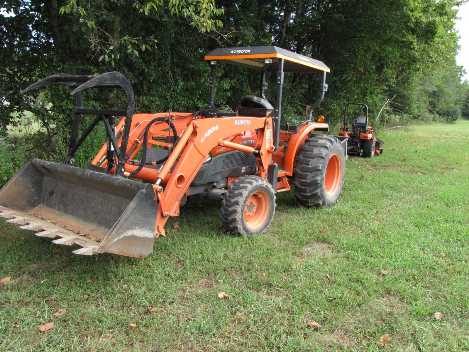

I took a picture, but not a lot to see. Couldn't get a picture of how it's mounted. The loader upright had a big hole in it not being used so I used it. I welded a 1/2" bolt near the bottom of a 3" X 5" thin wall tubing. Then welded a 3/8" bolt near the top of the tube. Had to drill a hole for the top bolt into the upright. The 2nd tube is 3" X 4" and just tacked welded on to the other.
Took a picture of the other side so you can see the one I put there. Also I wanted you to see my grabber I maded. I have about $550.00 to $600'00 in the grabber, bucket and the teeth. The teeth cost me $200.00 just by themself,so that well tell you what I have in the rest of it.

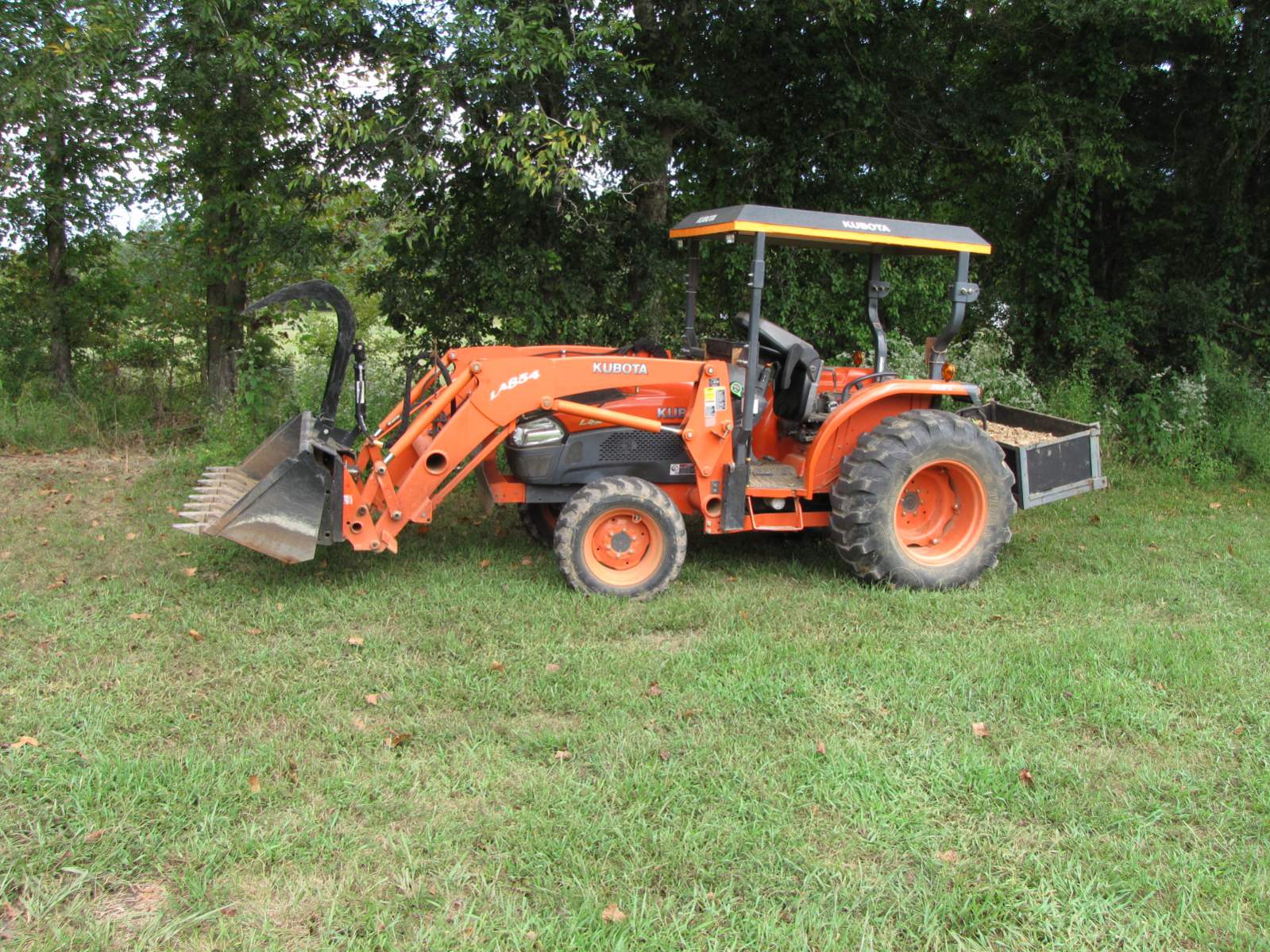

Thanks for the info and specs. Ive got a slightly older loader so I will have to check hole availability but to have something more durable then PVC and also get all these chains off my fender (I have to pull things out of the mud a lot :( ) would be a great improvement. Is that a single tooth grapple? I've been toying with tri-rear remotes and plumbing one to the front for a grapple but just have not gotten to it yet.
   / Tool Box Mounting Pictures #27
No, here is a better picture of it.
