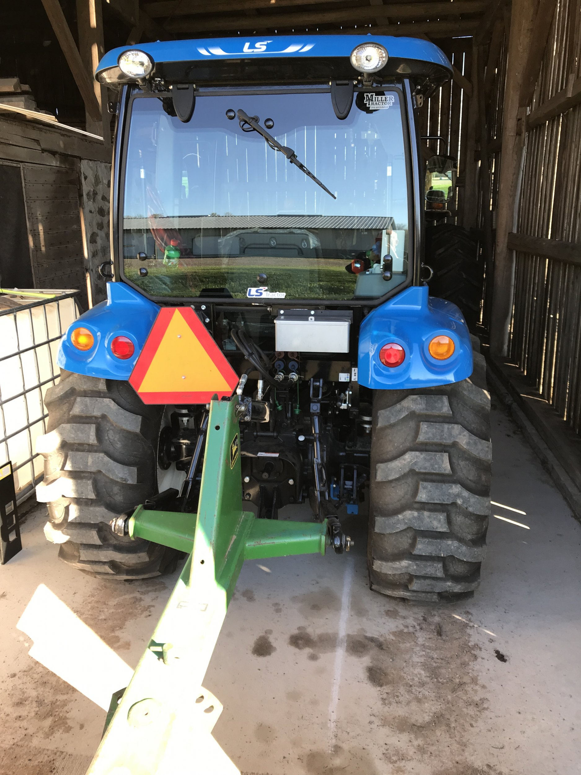

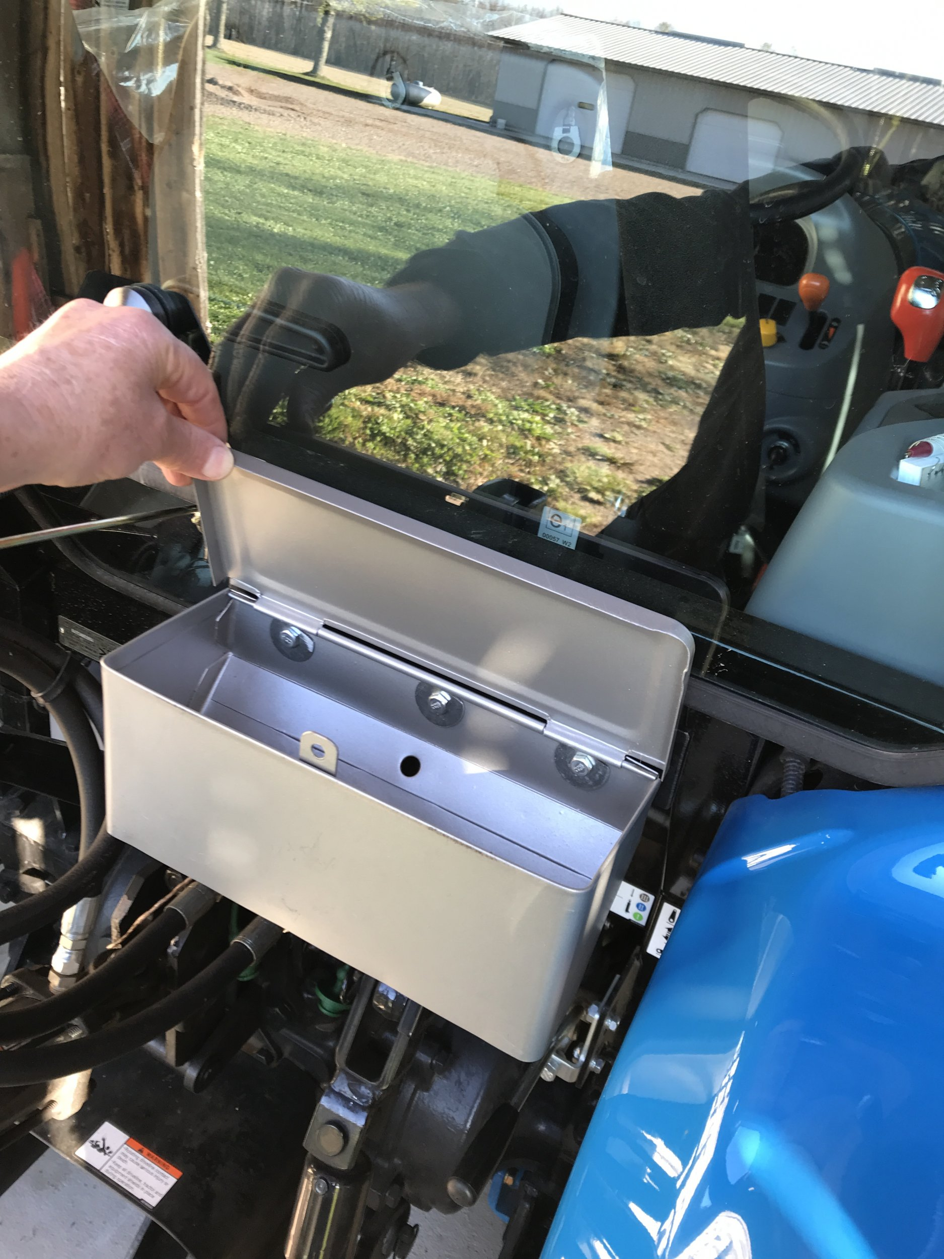

Stock toolbox for 8n Ford mounted to the rear of my LS XR4155

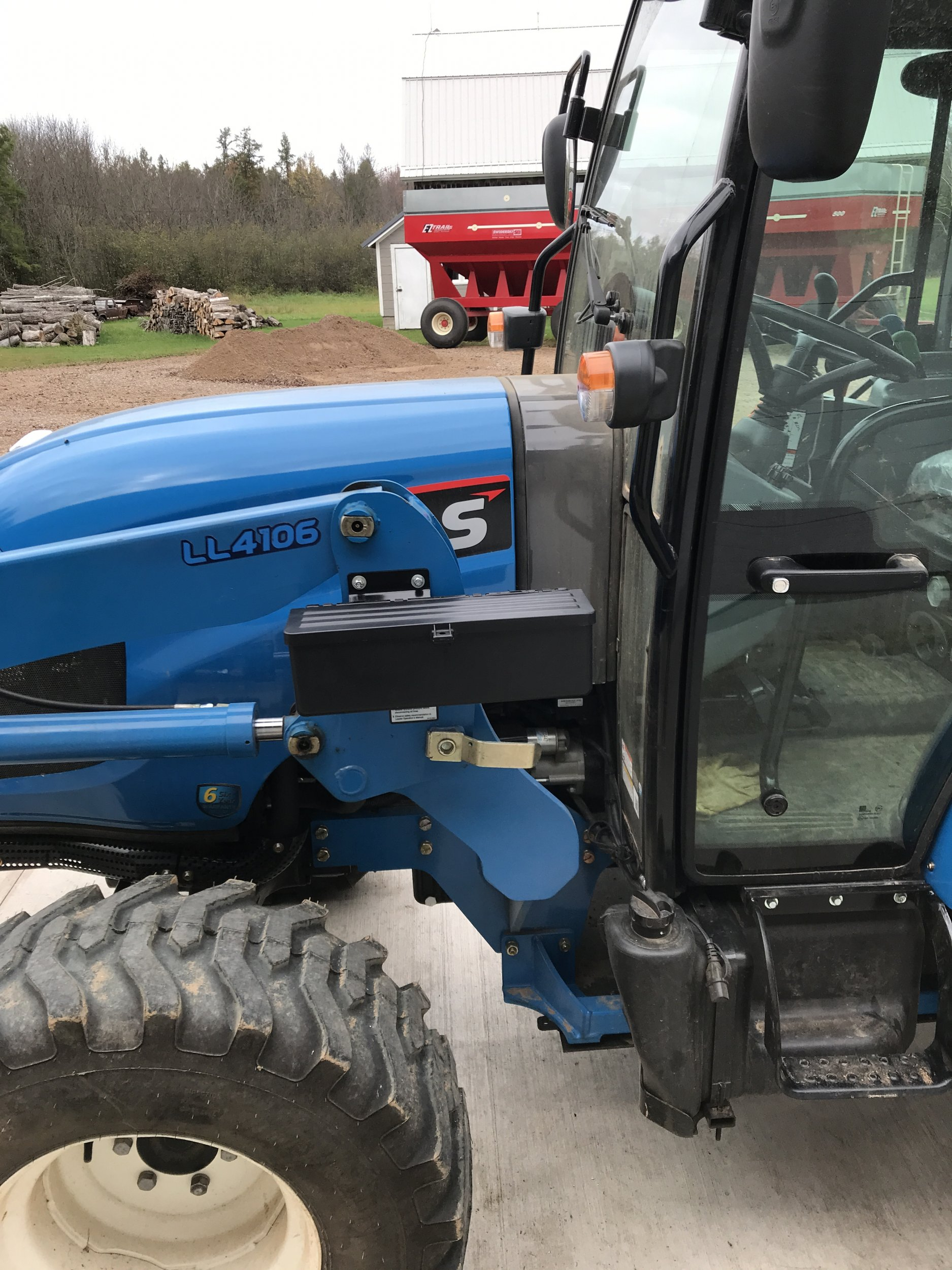

Toolbox for a New Holland Boomer mounted to the loader of my LS XR4155
This loader frame tool box is a great idea!
Unfortunately, it won't work on my Kubota L6060hstc. The loader frame disconnects from the tractor when it's removed, leaving the tractor without a tool box. That location also blocks the view of the front tires from the cab. I frequently monitor the turn angle and also the tire chains when plowing.
For other machines, it's a great location though.

Cycledude, I tried the behind the cab spot for a tool box like yours it was more in the way than not.... Especially hitching up to the jacto blast sprayer. The loader mounted box is slick....
Smokeydog, is that a 372 husky in the sabbard??
For me the main reason for the rear toolbox was to store small 3 point hookup parts, so far it’s never been in the way of anything but I do use the tractor to run a rear snowblower so the box does get snow and ice on it and sometimes freezes shut.

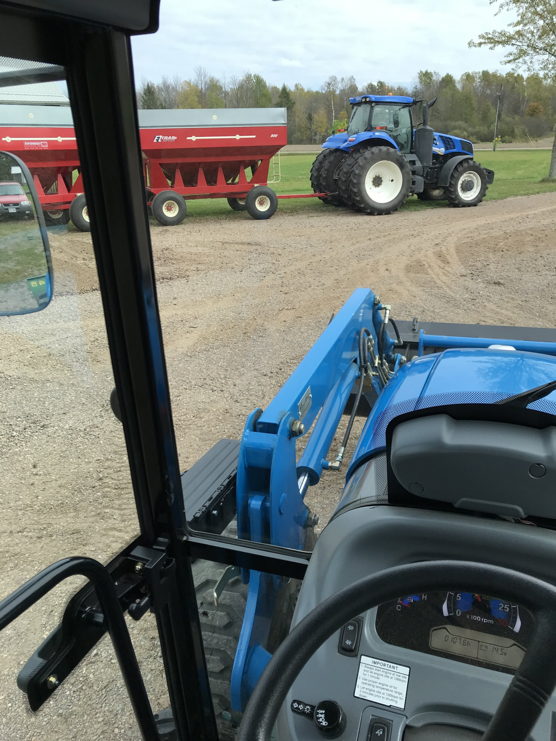

Yes the toolbox does stay with the loader on the rare occasion that I remove the loader so at least for me so far it’s been no big deal. It doesn’t significantly block my vision, here’s another picture from inside the cab looking out.

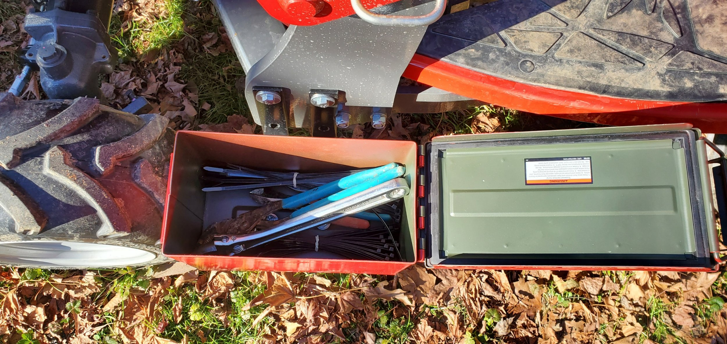

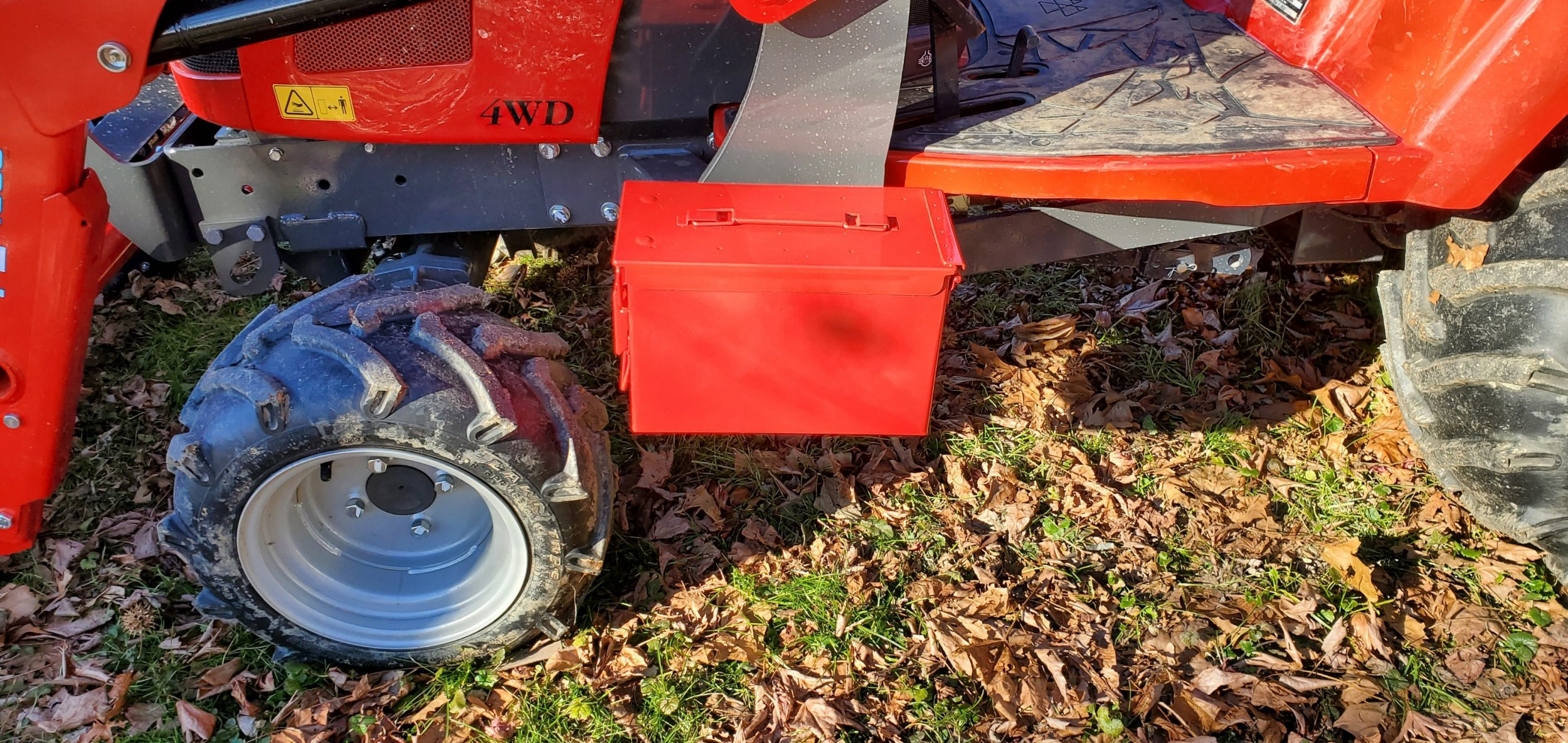

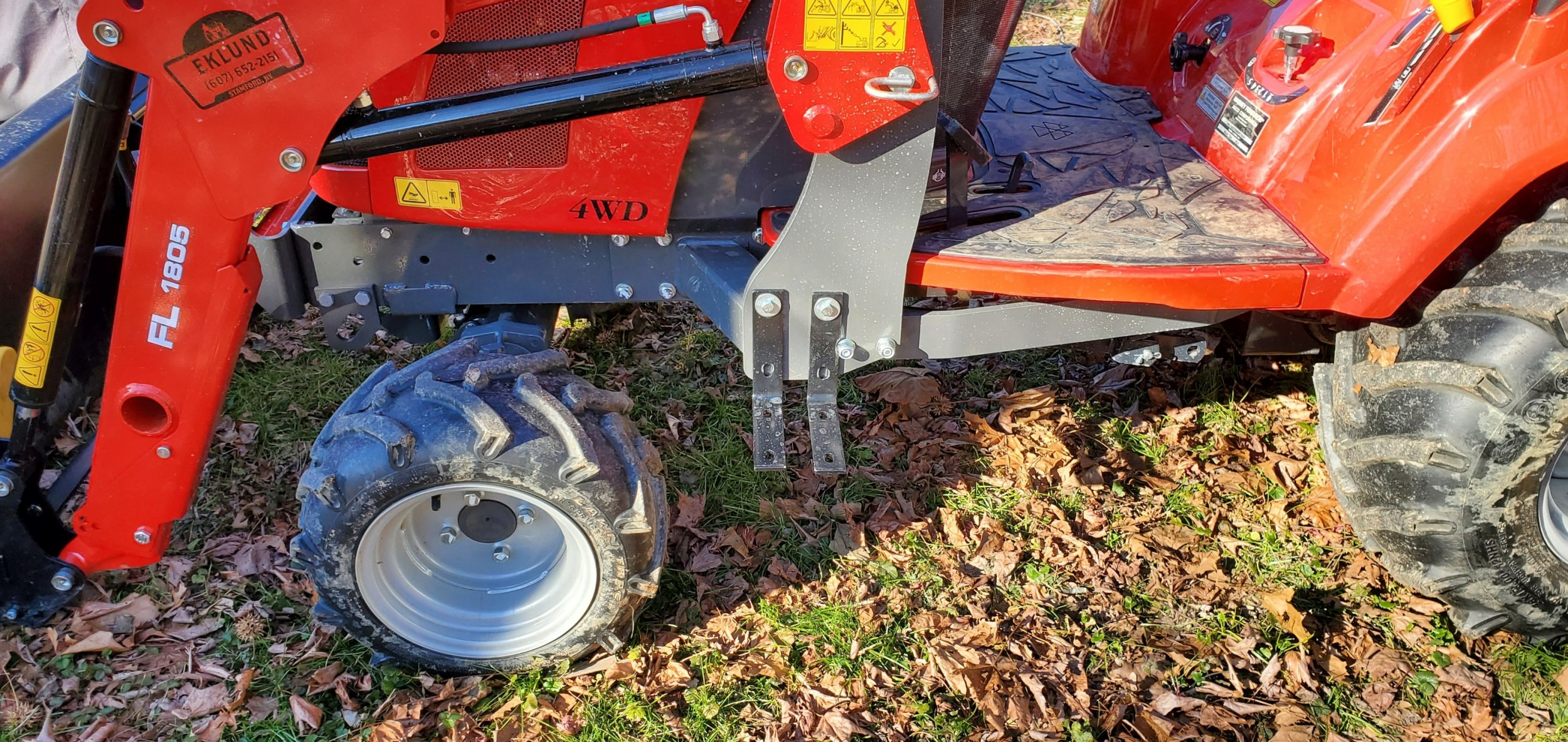

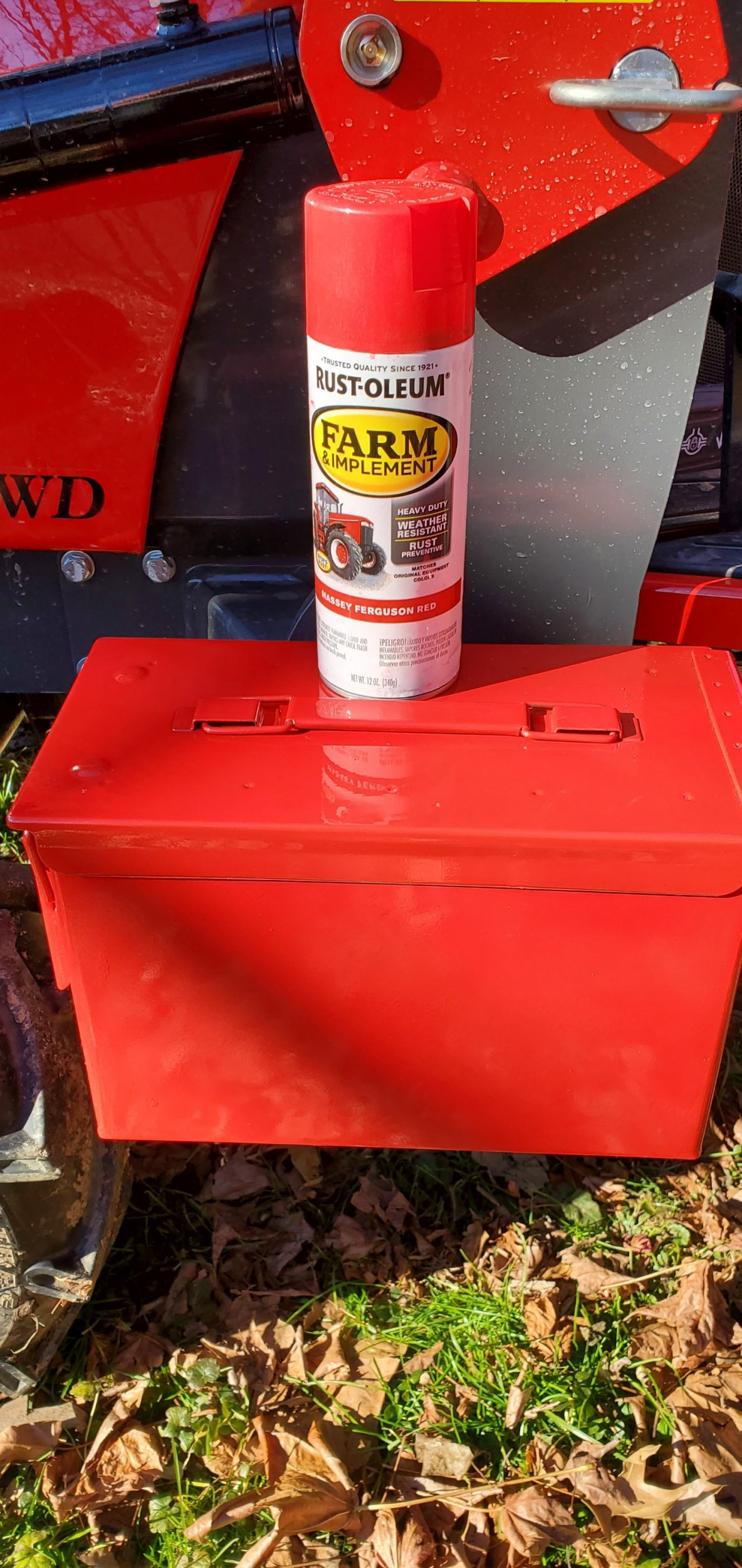

I got a .50 cal ammo can from Harbor Freight and hung it on 2 heavy "L" brackets using the existing holes on my loader arm bracket. Spray painted it with Massey Ferguson red to match my little GC1723. Holds a ton of stuff and yes it clears the front tire with room to spare. The only problem I had was getting the label and glue off the side of the ammo can. The paint kept bubbling up where the label was, so I ended up sanding that side and priming it before spraying it red.
