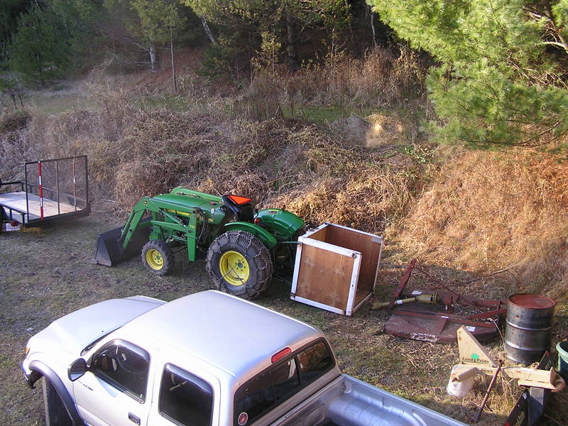

   / Tool Carry All - Ideas / Pics Requested? #14
I built this shelve thing onto my 3ph contraption. It holds chainsaw, fuel, chains, wedges, rope, 2 snatch blocks, helmet, chaps, large hammer and sometimes my coffee. I like it because the FEL remains usable for any task that comes up.
My wife wants to know why you carry a pumpkin around on the side of your ROPS??? LOL I had to explain that it was your helmet.

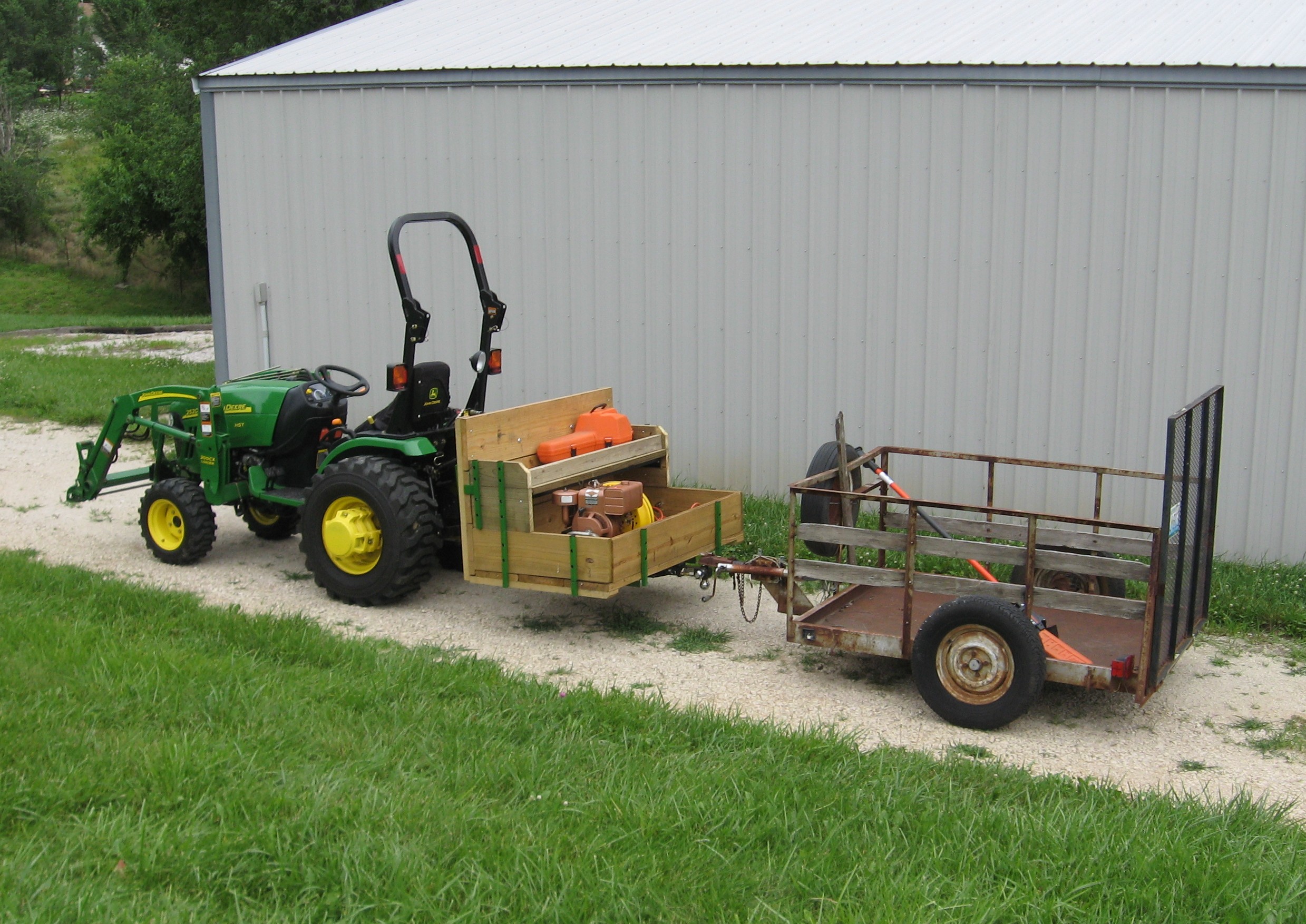

   / Tool Carry All - Ideas / Pics Requested? #15
I used a KK carryall frame as the basis for this two-level unit. The idea was to have my generator underneath and chain saw storage above. I also included a trailer hitch for my utility trailer. This allows me to carry everything I need for trimming trees around the property.
The upper shelf also doubles as a seat for giving tractor rides.

While all the points you guys make are valid and were a concern to me I pulled about four cords of wood with that setup last fall. It sure beats having that stuff in the loader. The shelves just pull out of the sleeves on the side and are out of the way when I'm not cutting firewood which is 10 or 11 months out of the year. One thing for sure some of those large carry all frames would get quickly banged up or hung up on trees and rocks. My setup is what I need for my particular piece of land and personal preference of cutting wood. I would hate to have to cut down more trees just so I can turn around or fit through with something big.
It seems so that things would fall out but they don't. The sides of the shelves are 3" tall and most of the loose stuff is under that level. I wear the helmet and the chaps so no risk loosing those. Believe me when I say that there is nothing smooth about the roads I travel. I don't know if you ever tried to even walk in the Maine woods. The best way to describe it is: there are a few specs of dirt between rocks and boulders. In fact nothing falls out because I have to travel slow so I don't risk tipping the tractor. I especially love the fact that I can put a travel mug in there and I have a sip of coffee every now and then.
The visibility for backing up is fine. I clamped the thing together before I welded the frame. That was to make sure I have plenty of room for hooking up logs and I can see over the top shelf when backing up.
The pumpkin... well... that was a good one. My wife likes to make fun of these things too and it keeps us both entertained.
