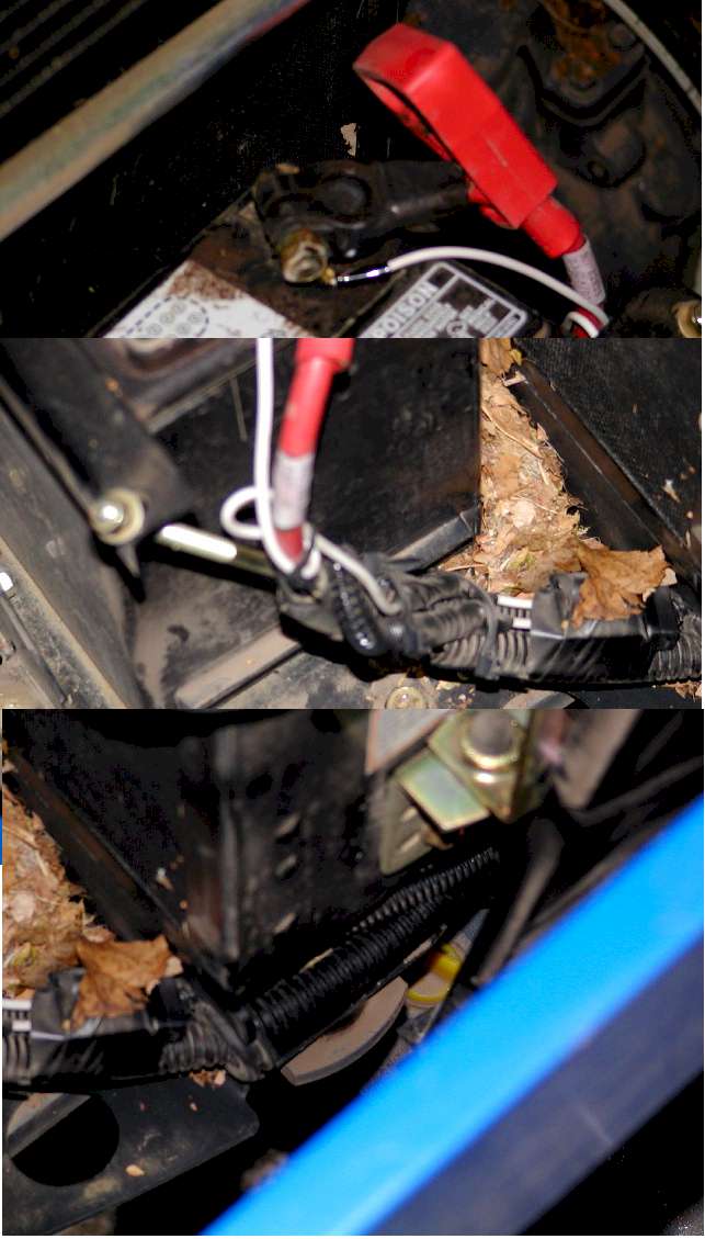

Attached is a picture that shows the connection at my battery as well as the corrugated sheath I used. It also shows I need to clean the debris at the base of my radiator. /w3tcompact/icons/crazy.gif

Mike,
What guage of wire did you use? 12?
Terry
   / Toolbox and Lights for my JD4100 #67
Yep, 12.
