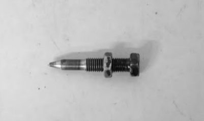

   / Toolcat 5600 2003 Brake issue #29
Do you need 1 bolt or 2?
From other threads, it sounded like the old TC's could roll with these bolts but newer ones can not.
   / Toolcat 5600 2003 Brake issue #30
that's correct, you need 2 one per axle works the same on semi trucks rear spring brakes
