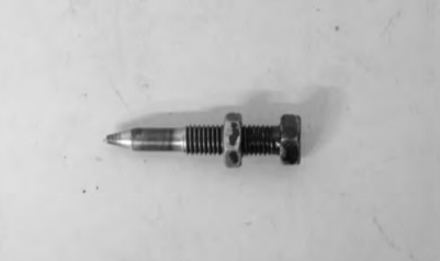

om the old 2005 one I had correct the brakes are spring pressure, thats why the brakes need to see pressure to release, there is also a bolt one can jack the brakes off to load on a trailer,
the brakes ever worked for you
Do you need 1 bolt or 2?
From other threads, it sounded like the old TC's could roll with these bolts but newer ones can not.
   / Toolcat 5600 2003 Brake issue #30
that's correct, you need 2 one per axle works the same on semi trucks rear spring brakes

Did you make these bolts? I'll buy them off you or if you can get me the dimensions I'll make them. Thx!
I don't have the brake release bolts. The picture was only from another thread.
