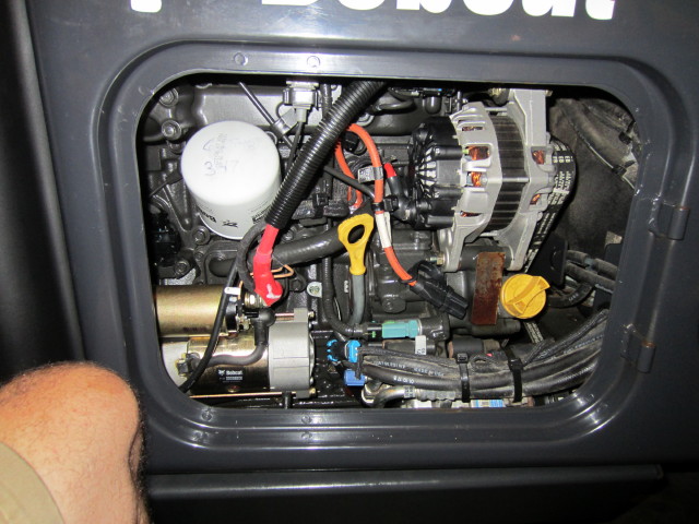

Where is the power cord? I am guessing that since the Engine Block Heater is an option, our 5610G does not have it.

Block heater slides in a hole in the block but first you remove a rubber plug.
/ Toolcat block heater #25
Thanks, now I know for sure that it does not have one.
