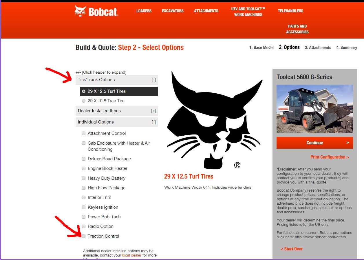

Overall, I've found them to work pretty Ok on softer ground in non-Winter conditions. The tires off the Tundra are somewhat worn, but have a "mud" tread pattern and I think the traction is better than the stock tires. (Stock tires for me were the non-turf critters that have a specific type-name that I can't remember right now.) Best traction for me is from some little LT235-15's that have chains on. That's what I use for snow removal.
