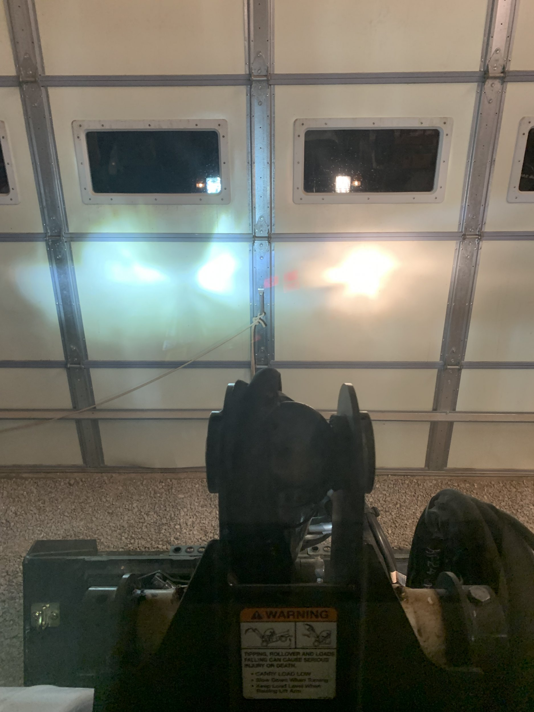

I gave LED headlights a try. The OEM halogens were stamped "64183 OSRAM 12V R2" which apparently is 45W and 1000/700 lumens (hi/lo beam) with a P45t base. I trialed Ruiandsion fanless LEDs that advertise 1800/1200 lumens (hi/lo beam). Ruiandsion LEDs with fans offer as high as 3000 lumens, but I wanted to avoid fans.
Here's the light pattern on my garage door from about 8' away. The halogen on the right is a concentrated beam, while the LED on the left spreads the beam with a shadow gap in the middle.

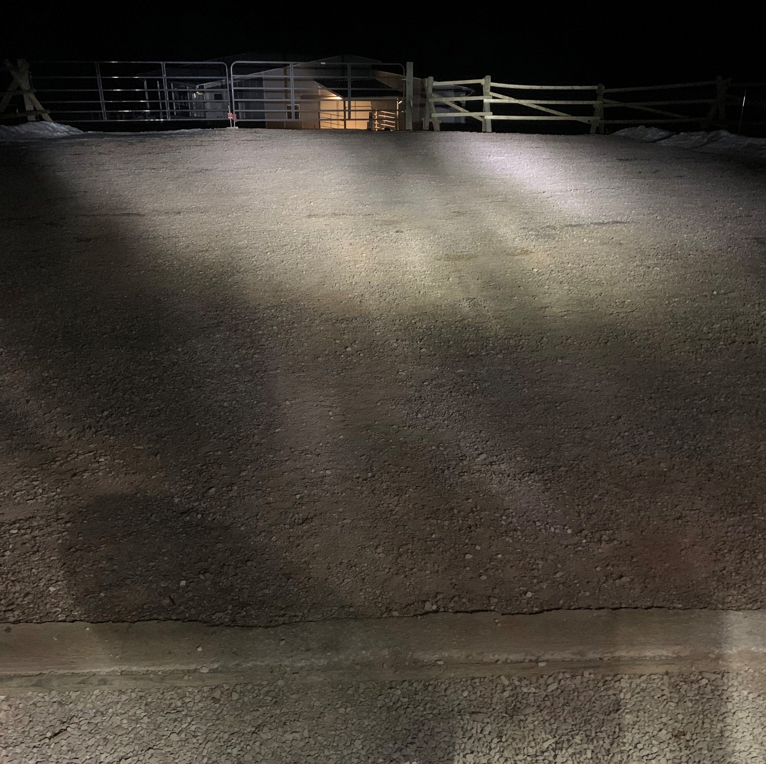

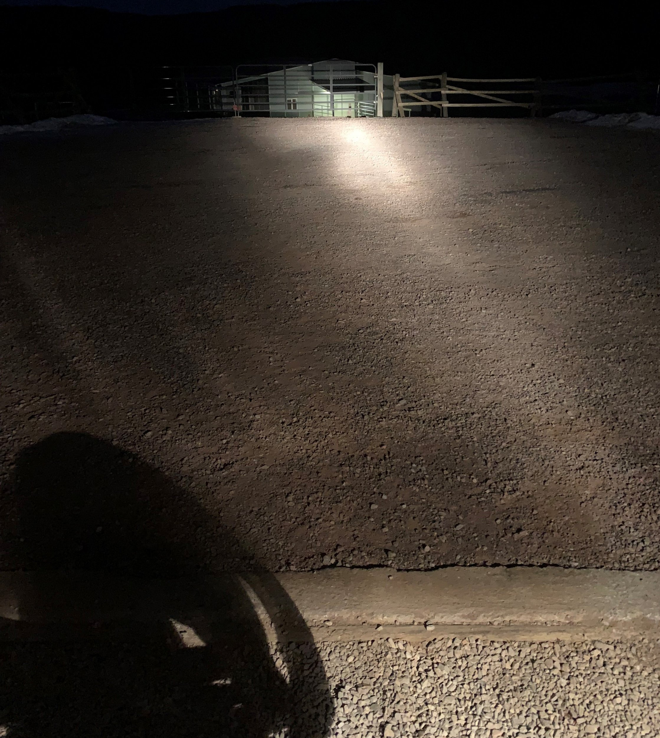

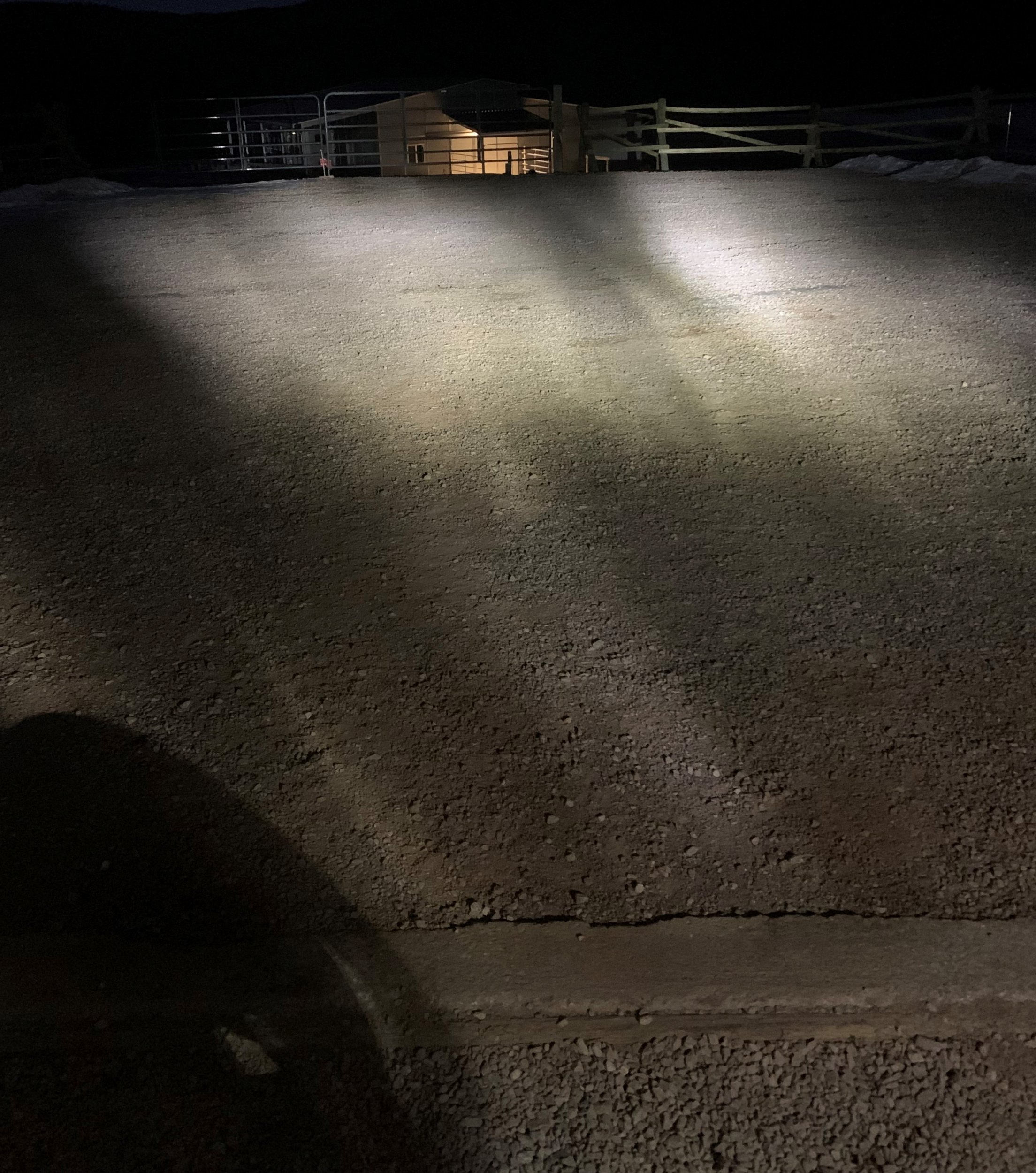

Here's the light pattern on the ground, one photo showing a single halogen and the other a single LED (both passenger side). Again, the halogen is concentrated, and the LED spreads out with a centered shadow gap. Seems like that LED shadow gap is right where the halogen concentrates.

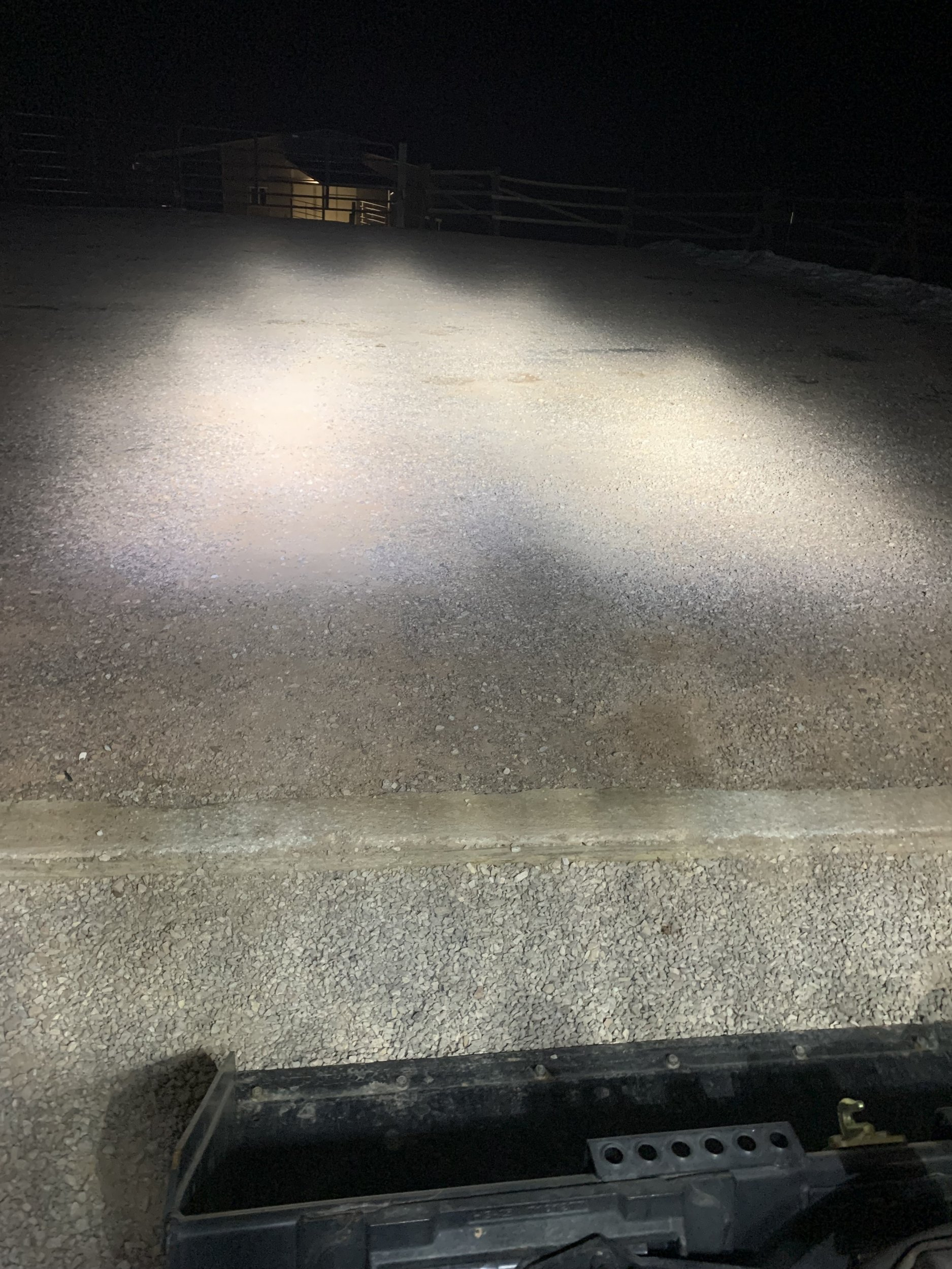

Here's both LEDs installed. The shadow gap is less pronounced, but evident. Still, I think the LED coverage is an improvement over the halogen.
