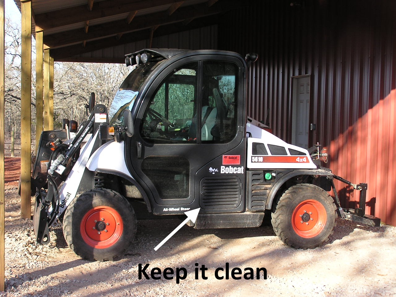

If you are mowing with a front mount mower, the 5610 does not have the overheat, stop and clean the radiator screen problem that the 5600 has. If using the Air Conditioner, you have to clean this one.

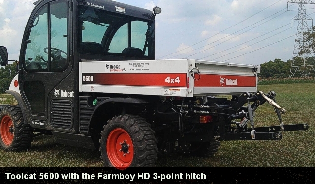

Since you have a 3 point PHD and brush hog, look at this: 3-point hitch - Farmboy HD | UTV Hitchworks - Maineville, Ohio

Does the farmboy add on have a pto? I thought it was for non powered (no-pto) implements only.
   / Toolcat Series? #25
The PTO would be the factory option on the 5600.
   / Toolcat Series? #26
I had seen the Farmboy HD before. I actually reached out to them last week.
If you look at the design their 3pt has one center mounted lift cylinder. This wouldn't work with pto.
I did however reach out to them about making me a custom version with two cylinders instead of one so they could be on each side instead of in the center. They said they could do that for about $600 extra.
