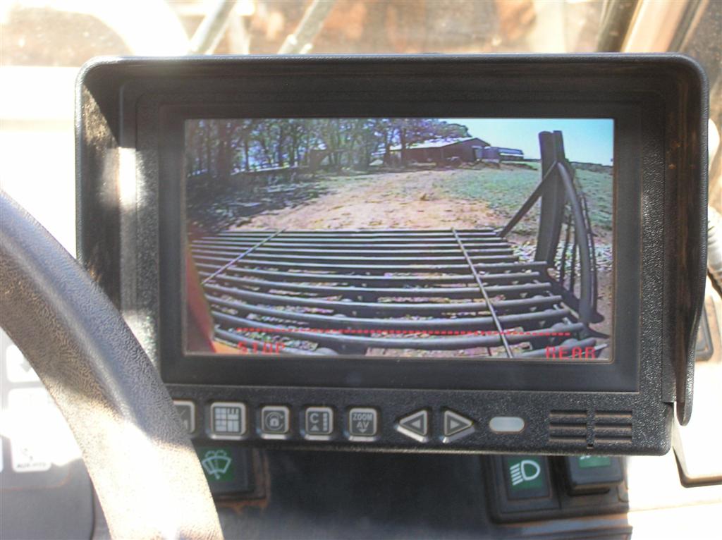

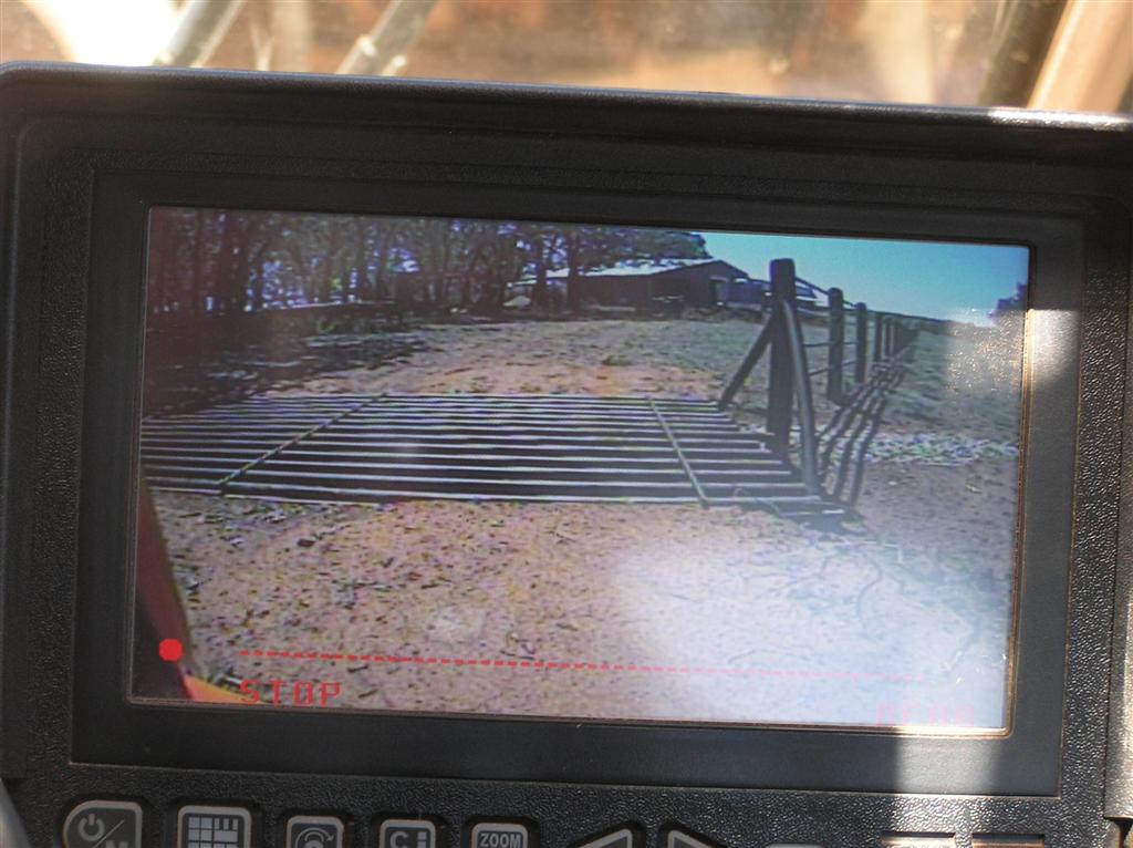

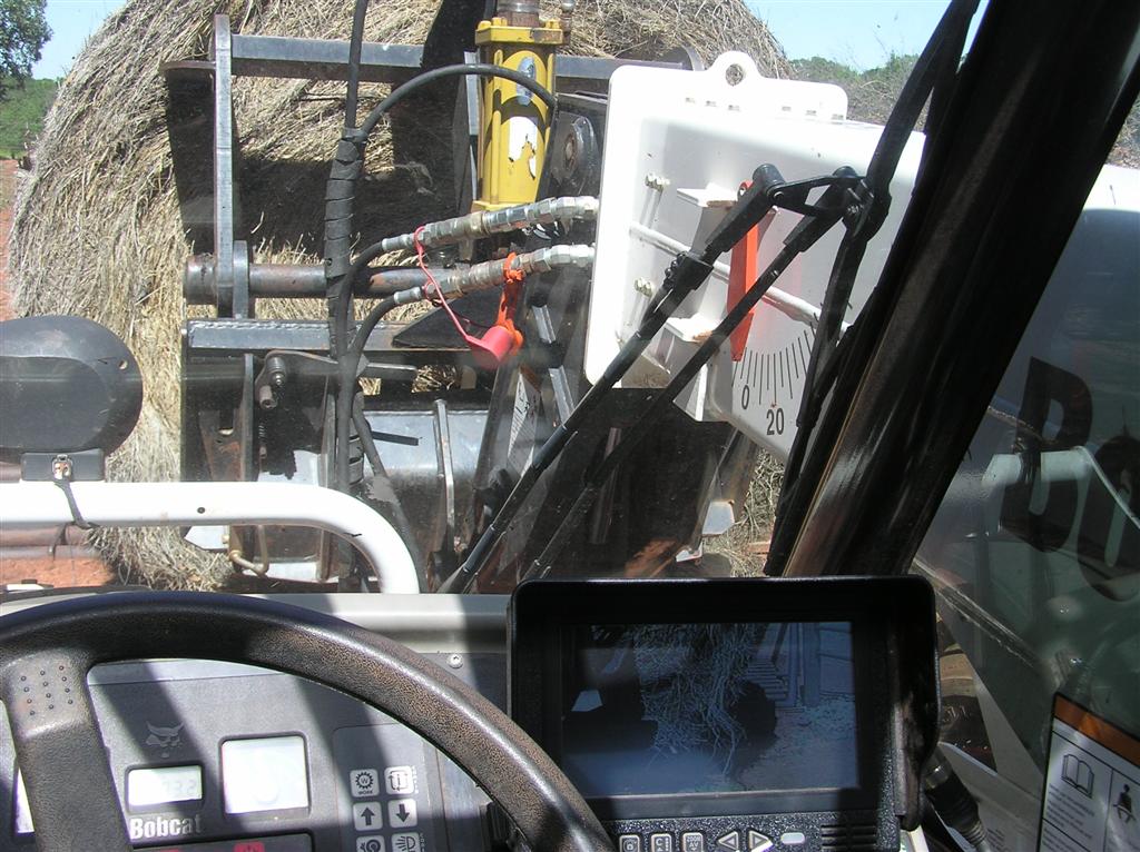

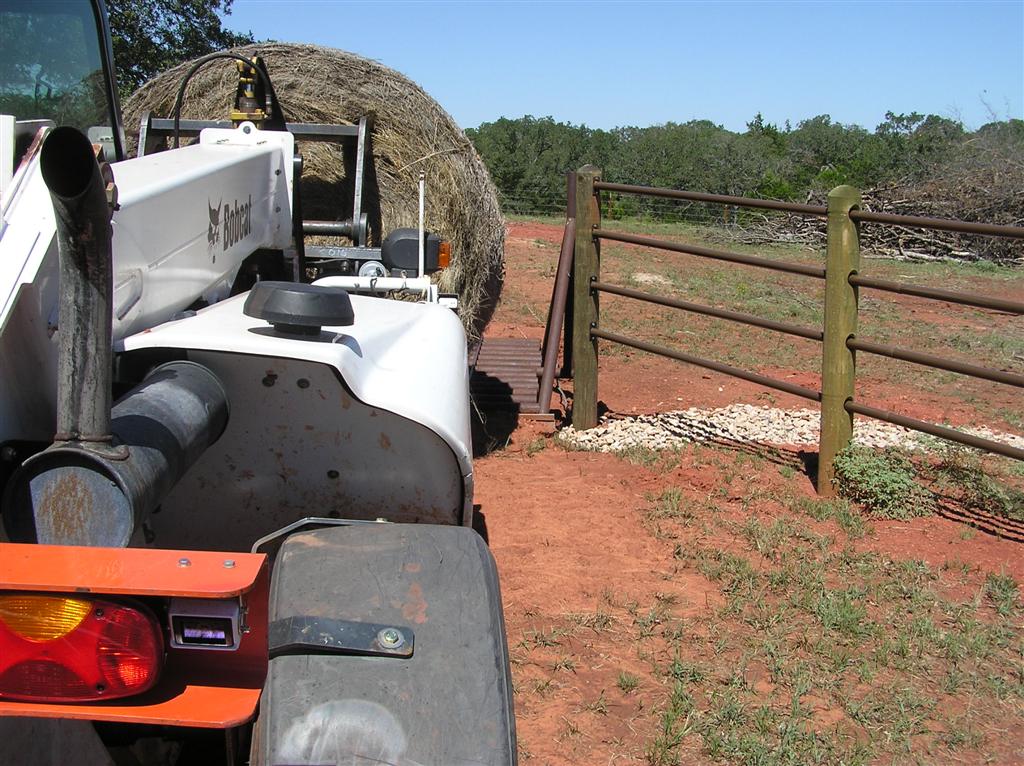

Since these old threads show up to anyone searching the internet for information, I will show how I solved the poor visibility problem on my V417.
This is what I use, it is a 7" monitor
Can't see much to the right looking out the front with a round bale out there.

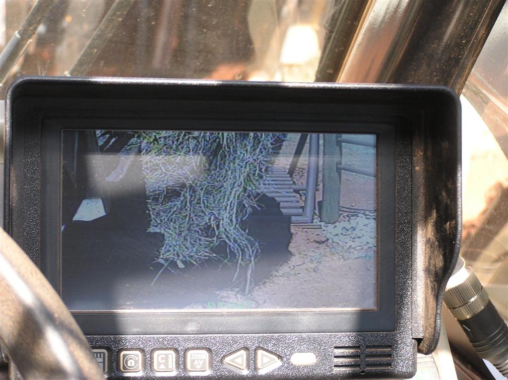

This is the view from the front camera, mounted above the right wheel.
I have tilted the camera up to see higher, since this picture was taken.
This shows what I saw in the monitor.

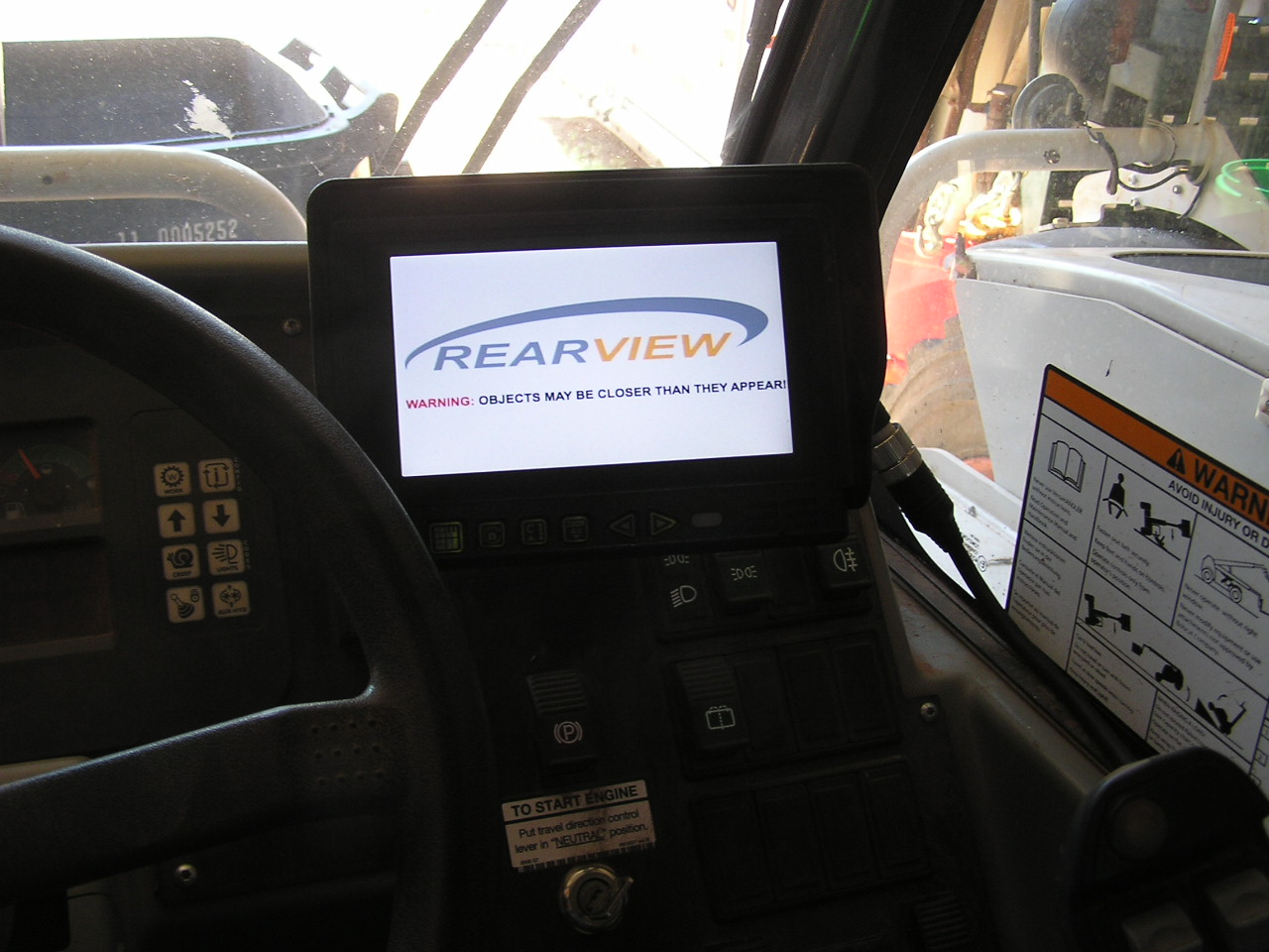

You can see the backup camera next to the tail light lens.

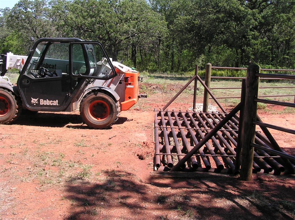

I drove on across the cattle guard and shifted to reverse.
Backed up and stopped with the first pipe at the lower edge of the monitor.
This is how close it was to the cattle guard.
It switches to the rear camera when I pull the reverse lever, and the front camera in neutral or forward.
It also shows the top right corner of the quick attach plate when you are lining up to hook onto an attachment, that makes it easy to see that it is under the lip and seated, as you raise it up.
You can also select the rear camera to be on all the time if you are pulling something you want to keep an eye on while going forward, just glance at the monitor.

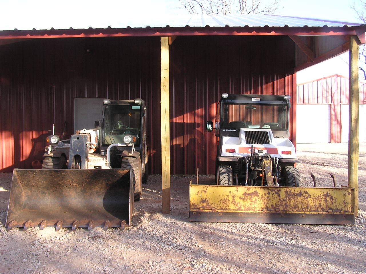

The V417 is the most amazing and versatile machine that I have ever had, and I have had a lot of tractors in the last 30 years.
Next to the Toolcat 5610

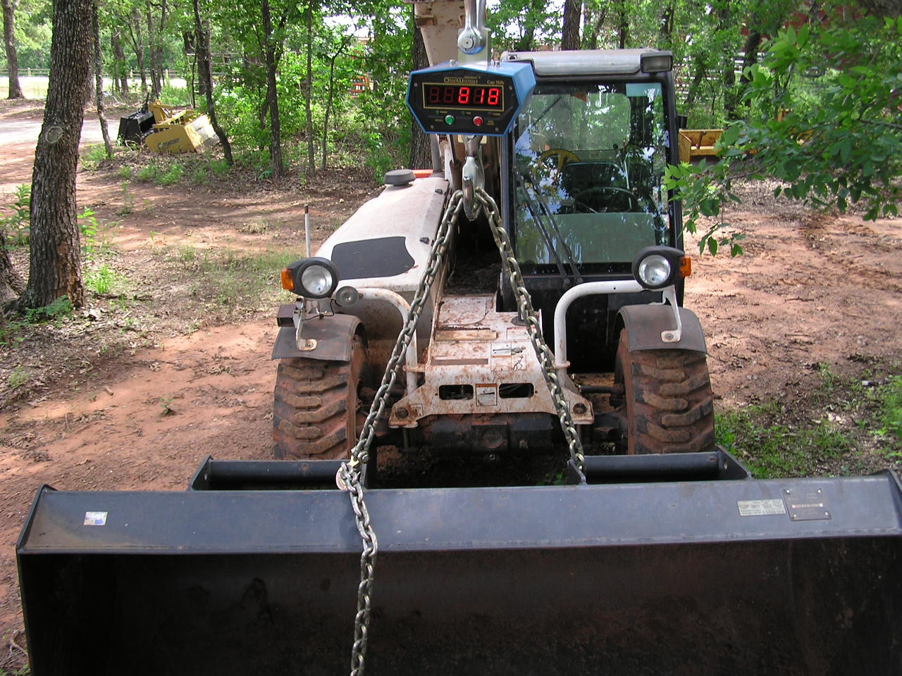

Yep, the mounting plate is the same on the V417. Hydraulic flow is 22 GPM. Rated Lift Capacity is 4400 lbs, but mine measured over 5000 lbs.
Max lift: http://www.tractorbynet.com/forums/bobcat-construction-equipment/275747-v417-max-lift.html

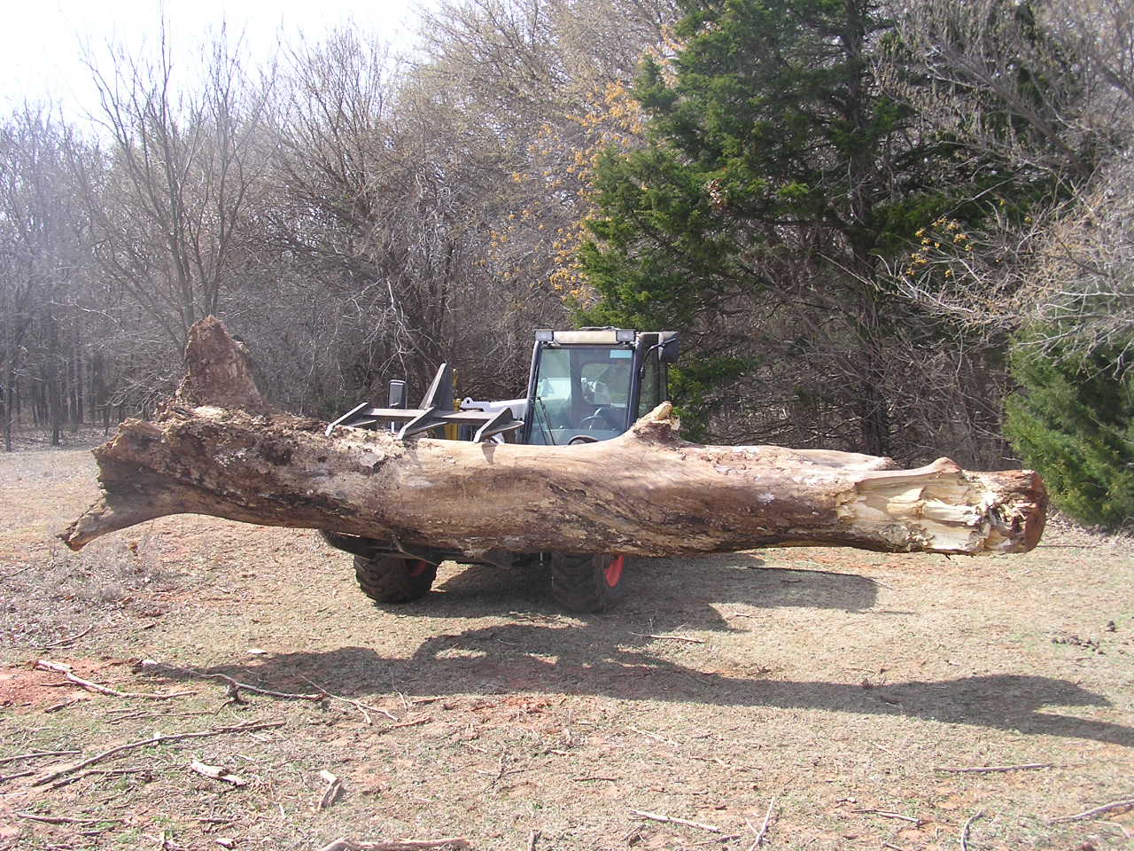

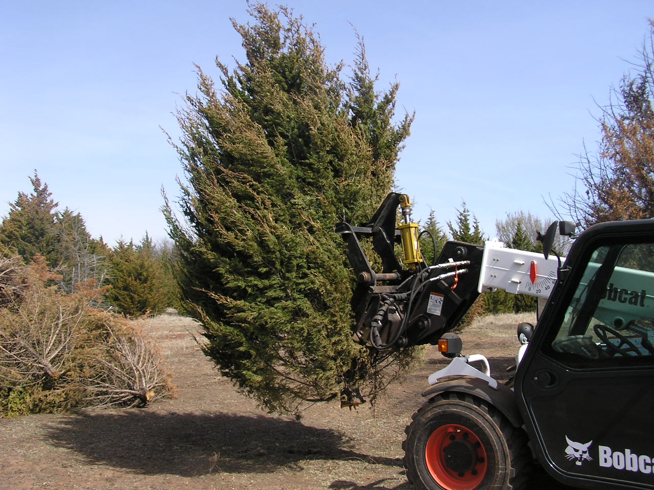

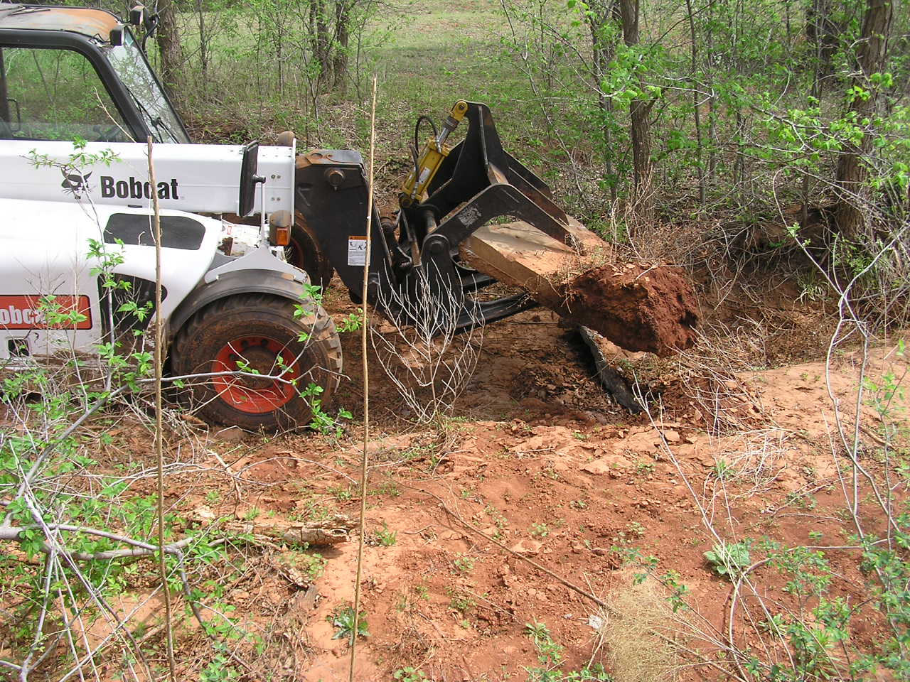

More V417 pictures here: http://www.tractorbynet.com/forums/toolcat/273429-toolcat-v417.html

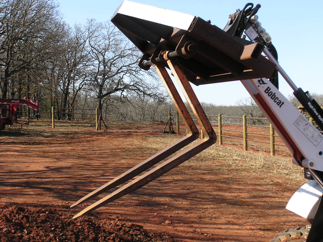

If I had a v417, I would want that kind of setup. Can you see pallet fork tips or bucket edge with monitor?
   / Toolcat vs V417 #9

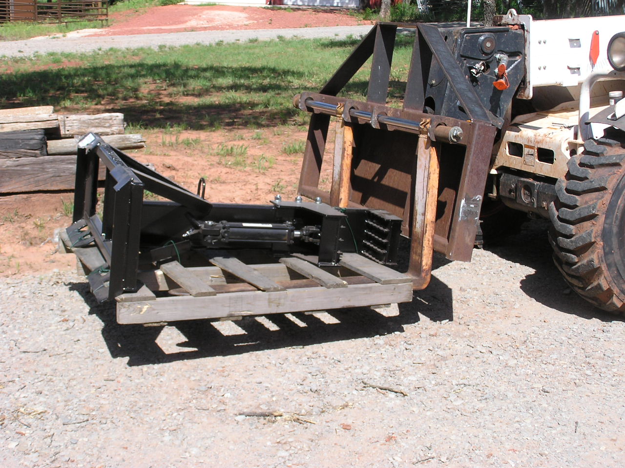

No, I thought about getting a wireless camera to mount out on the boom, so that I could, but don't really need it.
For a pallet on the ground, I can tilt the forks down and see the tips under the fork frame, drive forward until the tips are lined up and touching the pallet, stop, curl up as I go down and extend the boom, the forks slide into the pallet.
For a pallet on a flatbed truck or deckover trailer, the tips are visible as they slide in.
This is what I have, the forks are 42" long, from a forklift. I bought them used about 30 years ago.
I don't have any pictures of just the forks on the V417 Versahandler.
Here is one with a pallet on the forks, on the V417

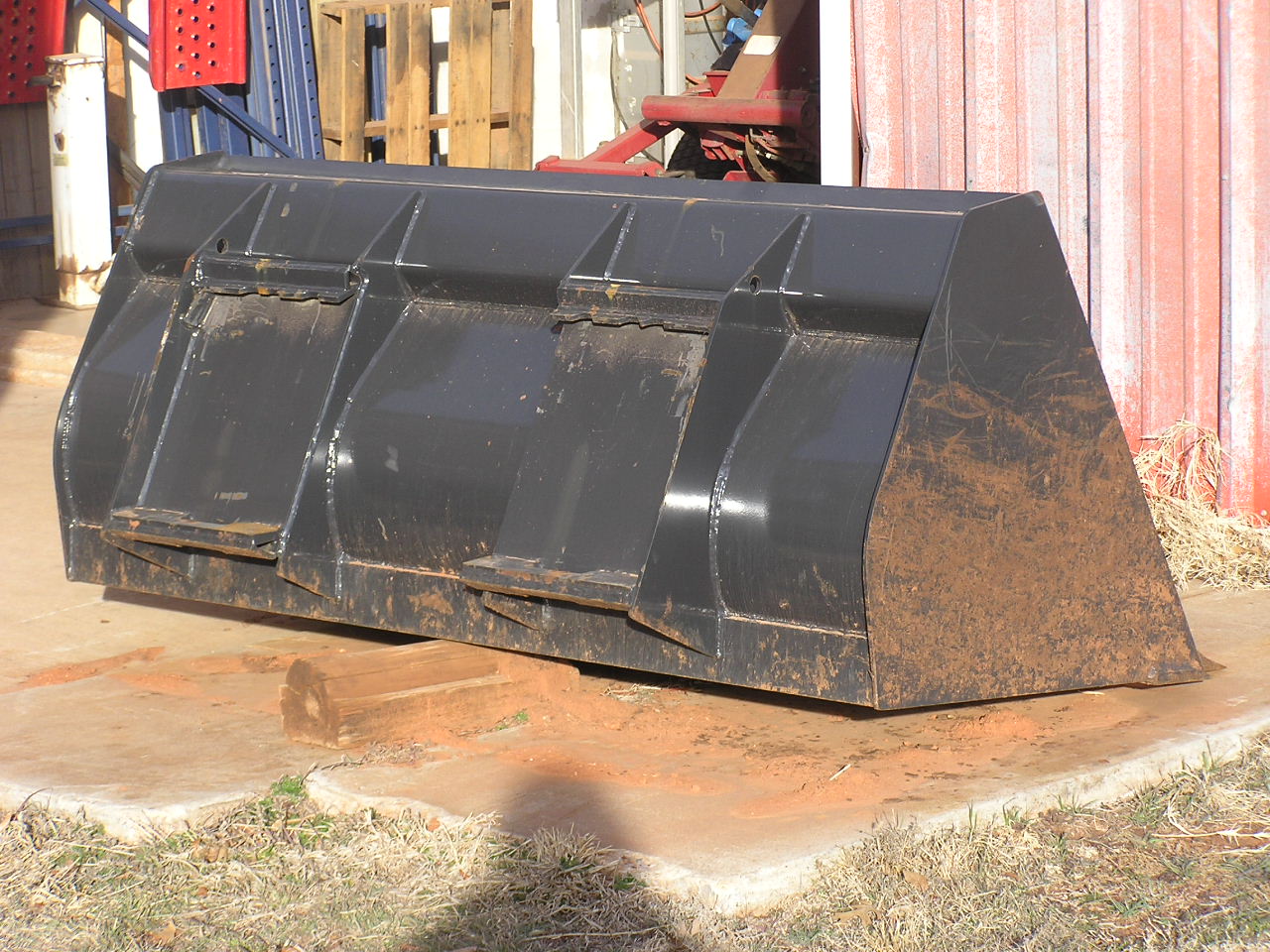

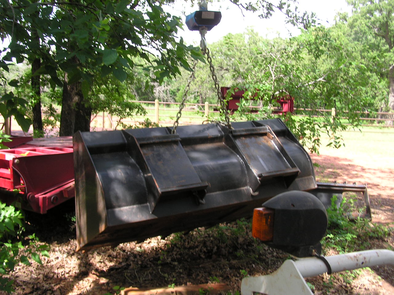

On the monitor, I can see past the bucket and what is next to it on the right.
The bucket has a high back, made for the V417
Weighs 818 pounds with the teeth.

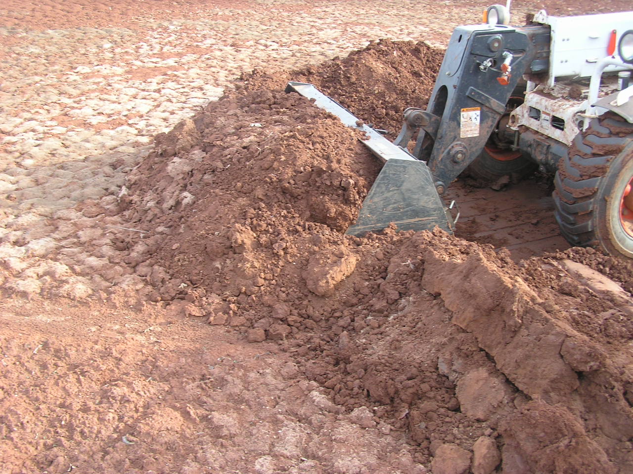

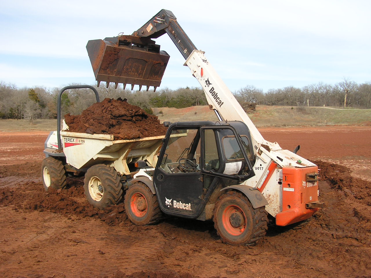

The V417 compact telehandler also excels at digging in the red clay. :thumbsup:
Enough weight in the 1 cubic yard bucket to make a teeter-totter! :D
Filling the 4WD wheel barrow.
The 6' wide bucket with teeth has no problem in the hard red clay
