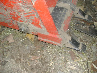

Pic of my markham on my L5030 LA853 loader. Cost $289 plus $30 shipping to Ohio. I ordered end of July, it shipped end of Sept. Markham was backordered on the teeth.

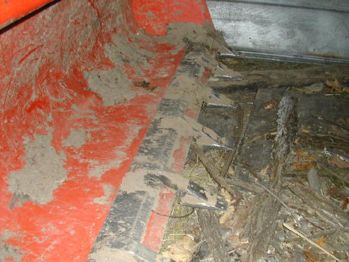

another pic, last pic showed the bolt on, this shows more of the teeth. Sorry about the dirt, but that's why i bought it....
