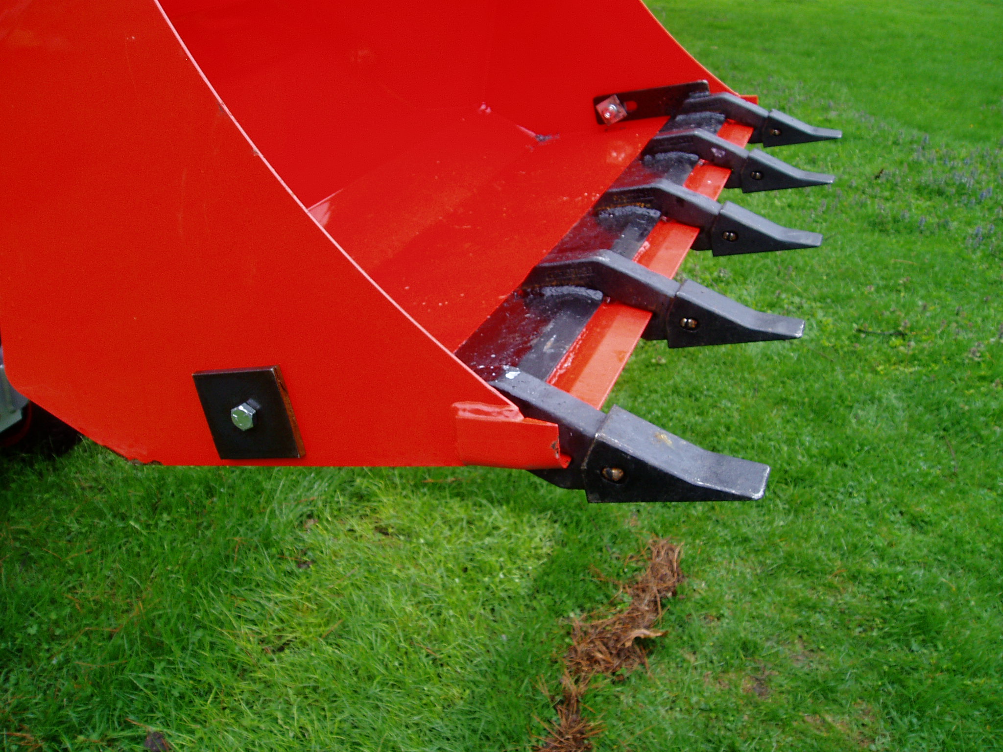

For those still considering the Flat Tooth Bar from from W R Long, I posted installation pictures here.
/ Tooth Bar Question #34
"... how does it work?"
Just fine so far though my dirt piles are still soft from all the rain in CT - a better test of the tooth bar will be when they dry out and harden up. I ripped through a few barberry bushes and shifted a few fallen trunks around just for fun.
It appears to be sturdy. One unusual aspect of this design (unlike "standard" bars) is that the tooth bar's flat plate (or "gum" I suppose, to extend the analogy) becomes the new cutting edge. This is good in that it protects the bucket's own edge, but it's not as as sharp. Whether I will notice any impact of that I can't say.

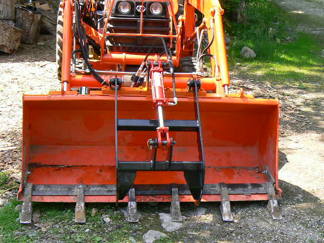

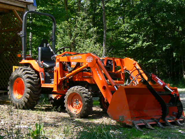

/ Tooth Bar Question #39
Here's my BX24 with the Markham..just installed yesterday. Came out great!
I used a drill bit with a pilot hole and some cutting oil...about 2 minutes per hole, drilling slowly and squirting oil when the bit started smoking.
