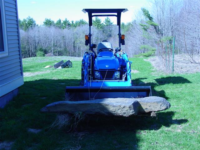

   / Tooth bar uses? #5
Another reason for the toothbar is the extra depth that it gives the bucket. See the jdfantic's picture on the post above this one. If he hadn't had the toothbar, he wouldn't have been able to pick up that concrete slab.

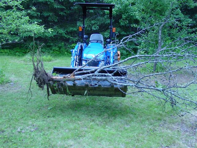

   / Tooth bar uses? #9
Mayor said:
The toothbar is a must have!!!
I will provide pictoral evidence of the utility of tooth bars. The first is an old posted picture. The second happened today. I discovered another use for toothbars today as well- you can strip lower branches off tree and shrubs before you push them over from various angles and then pull them out with the FEL hydraulics. I was able to pop a plumb and an apple tree today using this technique. By stripping the lower branches I possibly protected the radiator from branch reactive response :eek:. Jay

   / Tooth bar uses? #10
There seems to be a lot of traffic on TBN tonight. The second picture:
