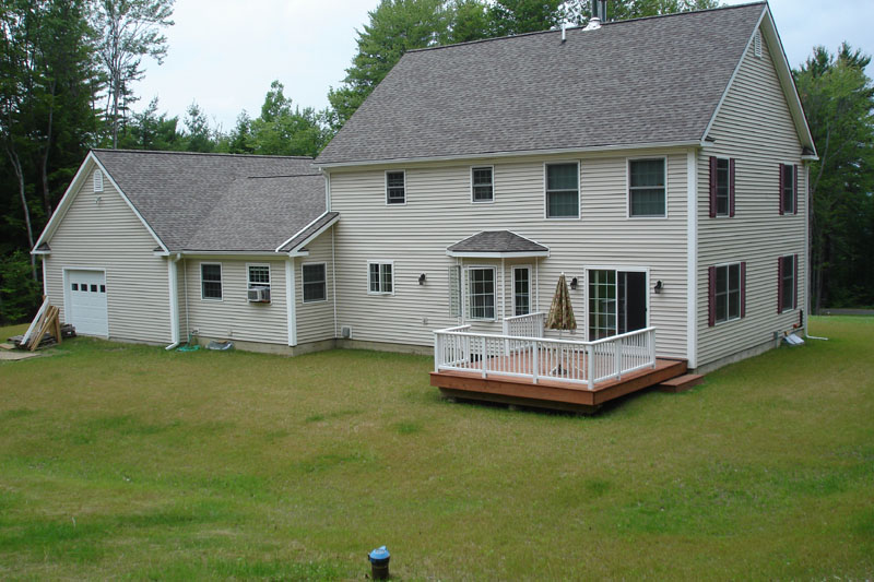

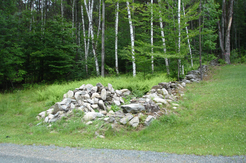

Nice pictures :D! I see a tiller in your future for garden and flower beds as well as an old beat up junkyard car/truck hood (AKA "stone boat") to help you skid the larger rocks that you can not lift. Jay
LOL :D :D
Jay, that was too funny… brought my spirits up for the first time today (daughter problems… don’t ask…:mad: ).
Good idea on the truck hood. I’ll park that next to the rocks and put the body of the truck where the stone wall once was on the other side of the driveway. When people ask what it’s doing there I’ll blame it on the site guy. Maybe I’ll even paint his name on it.

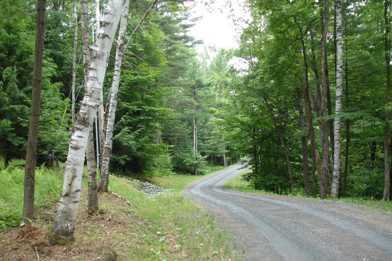

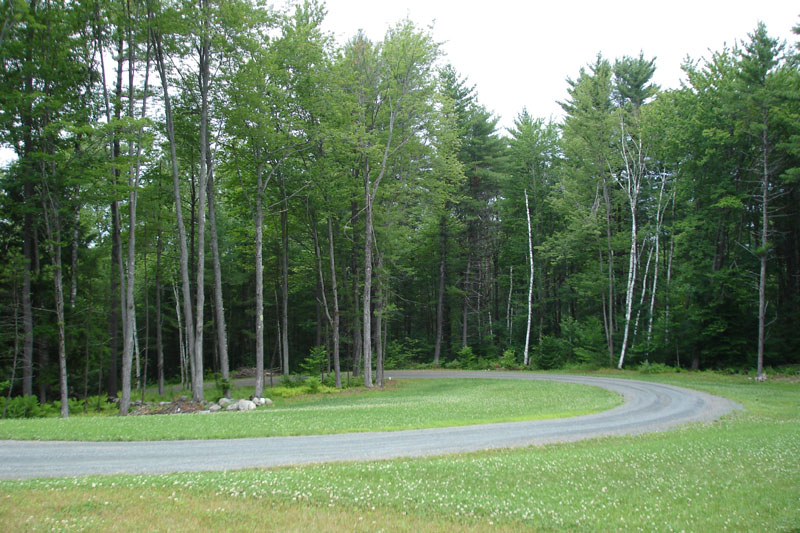

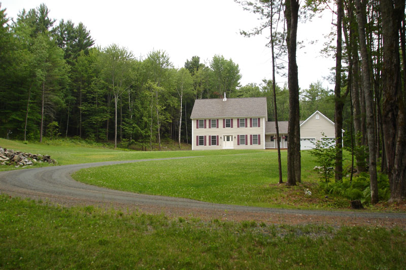

Thx Efreet and JDFANATIC. Agreed on the tires. I'm thinking I'll do the R4s as I do have clay around here and want to go in the woods to do clearing. I've been told that there is a new type of chain that works well with these tires... Something about extra lugs that give better bite when some fall between the bars. Not sure what that is but we'll see.
JD, you think a BB is the better choice for this driveway as opposed to a rake? Is it also good for smoothing woods dirt once the roots & stumps are out?
This is the third house we've built (glutton for punishment) and is by far the one that needs the most landscaping.... I really need this machine. :(
VTtractorguy,
A York-style rake can work with gravel drives. The problem with them is that they really don't dig (no down-force on the 3PH). A box blade will dig, and what is required to fill the invariable pot holes that will form, is not the rake that will smooth gravel into them, but a method of actually digging the pot holes out. Personally I think the rake is easier to master usage techniques with, but the box blade is a far more versatile implement (and not too hard to learn how to use). :)
JD, that's good to know about the box blade. Makes sense. It's on the list.

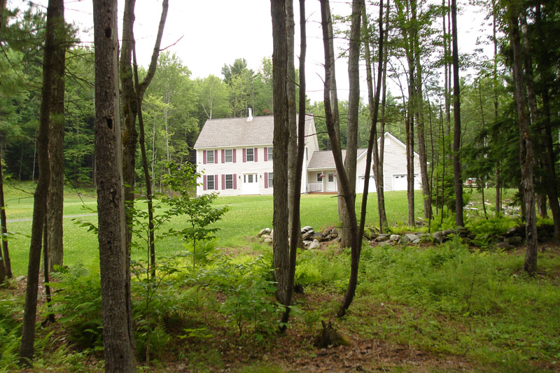

Hey VTtractorguy the place looks great and I can see a nice 2520 in your future. I would love to get my hands on those stones you have!
