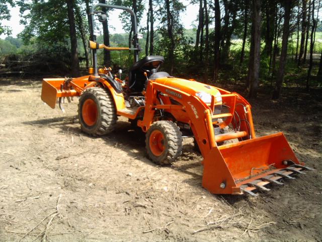

thank-you johnnylight, the plate is on the to do list with a plate across the top with hooks on it,modifying my 5ft dozerblade for the craftsman garden tractor to fit off the buckit,(for snow) and a hitch off the boxblade to pull my two 17cu ft wagons.( nothing fancy needed for that)

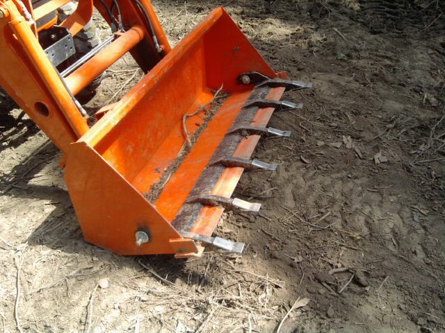

johnthomas,i look at the rachitrake before i order the tooth bar and it problie would of worked for what i needed but ended up with the tooth bar.
the ratchet rake i feel would of kept getting hung up in the trees piles or would dig up the ground when i pick-up a rootball with the part teeth that hangs on the bottom side. now i could be wrong never, used one but the way it looks it would do that. plus my teeth can be replace if i break one.
it only took me 10 min's to install the bar and with air tools it only take 2-3 min's to zip it off and back on.mine will be removed if needing a smooth buckit and for winter.

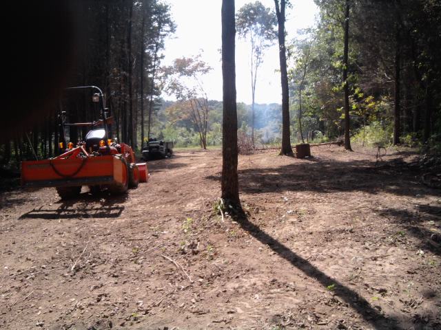

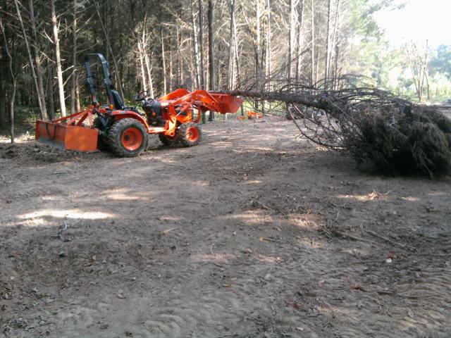

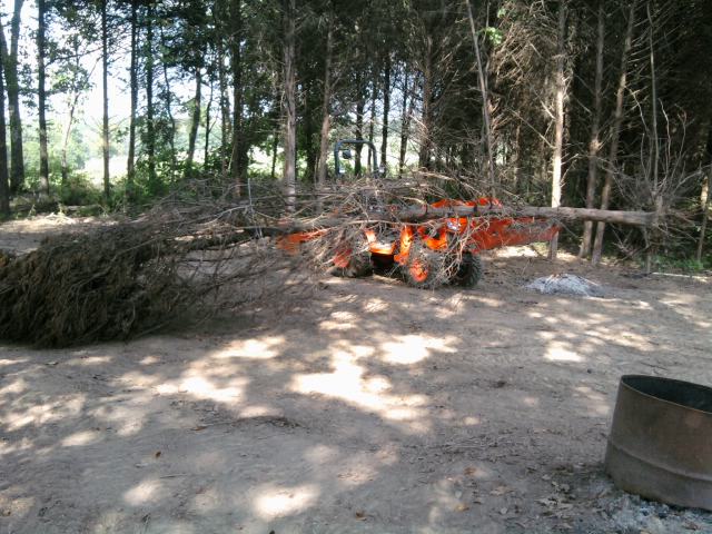

with a chain pulling the trees out i would get 6-10 cut up in a day,the first day with the toothbar i did 18,so it help me out alot sence i had almost 600 trees.piled up around my place.
here are some pic's of one fence line i got cleaned up. i still have the fence to put up but all the post ecept the corner post are up.
just like any tool, they both have a time and a place to be used. i my opinion

thank-you, i had a dozer come in and push them all over but i can push over
4" cedar or so. if it rains abuck i maybe able to push over a little bigger.
