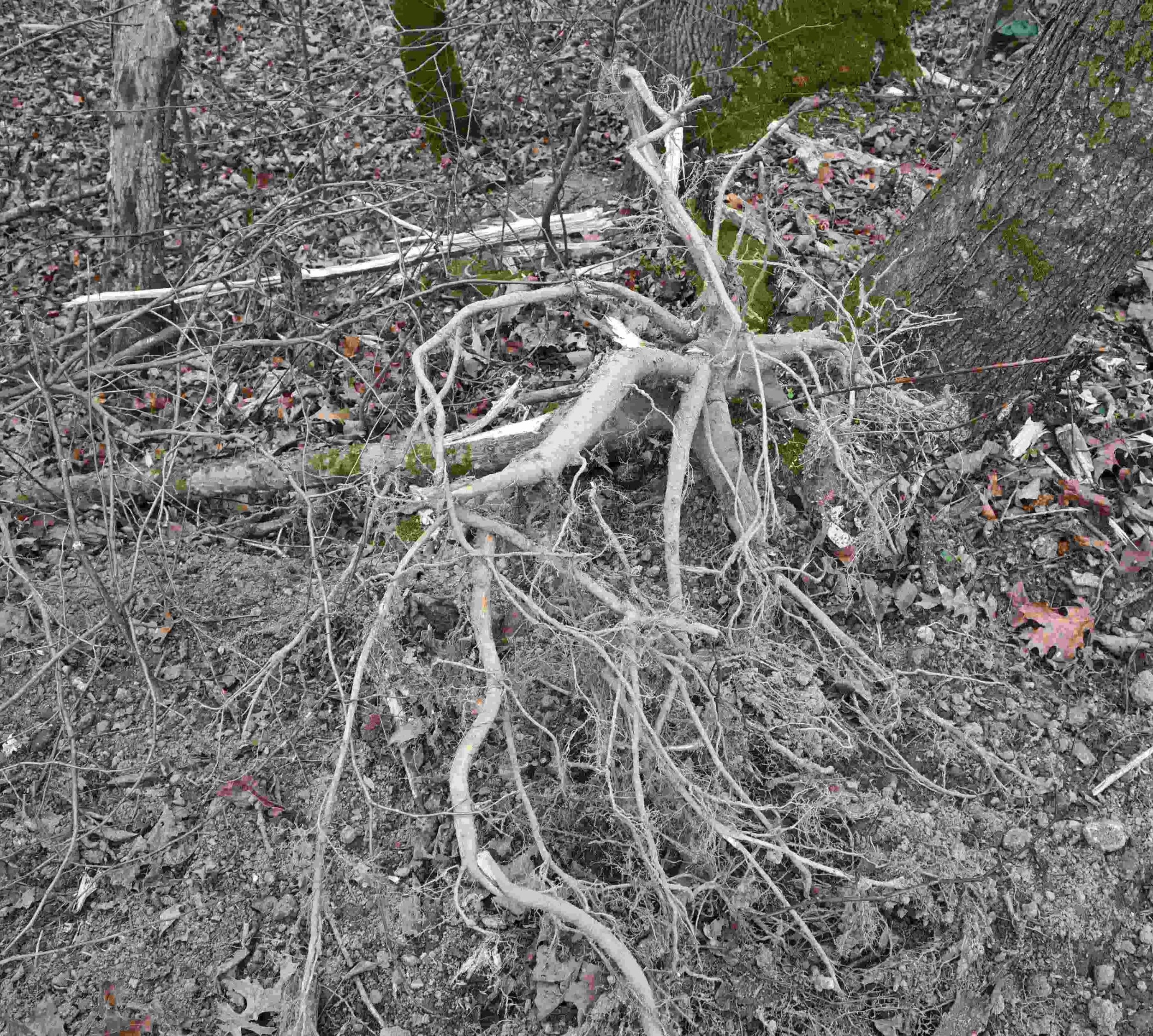

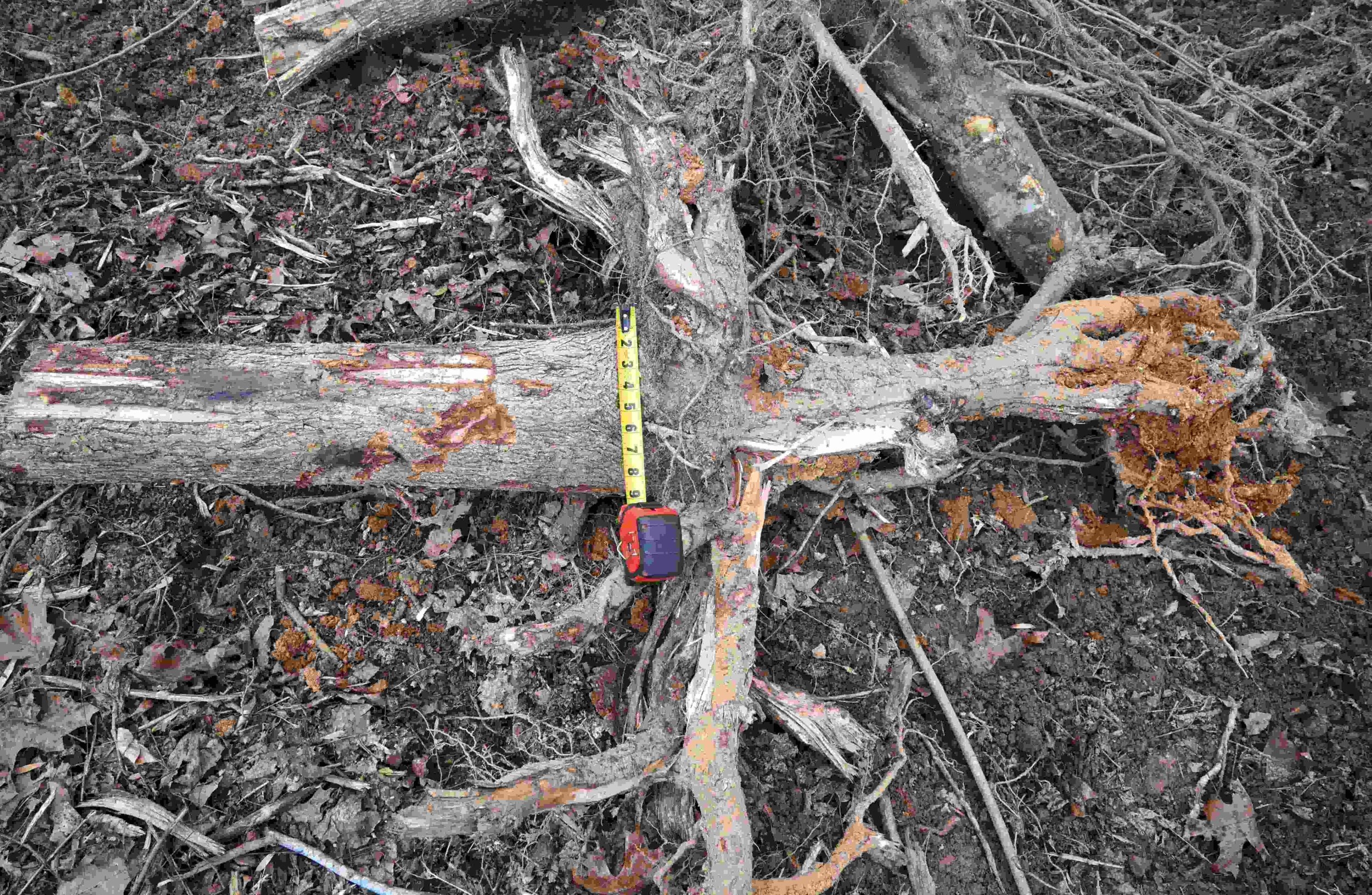

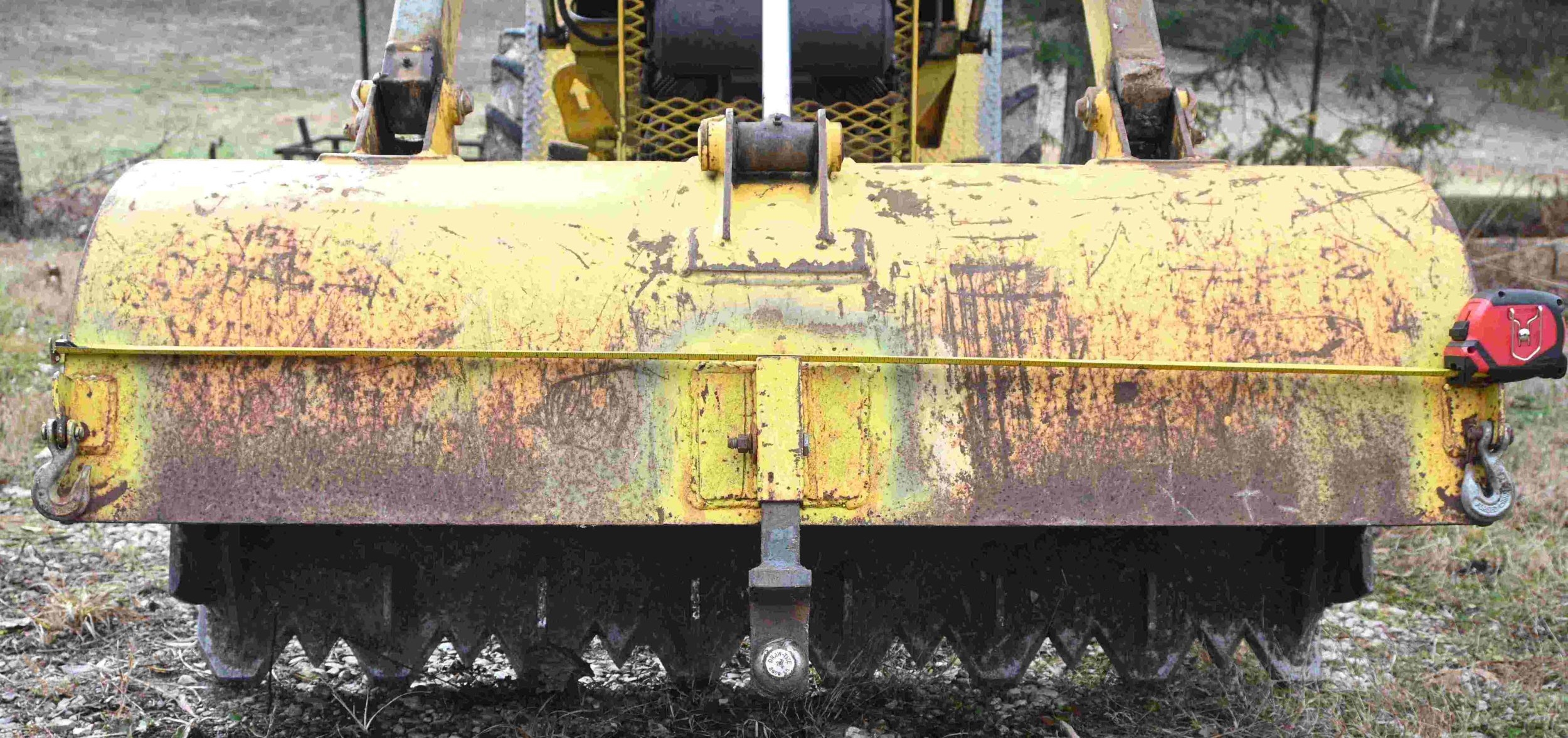

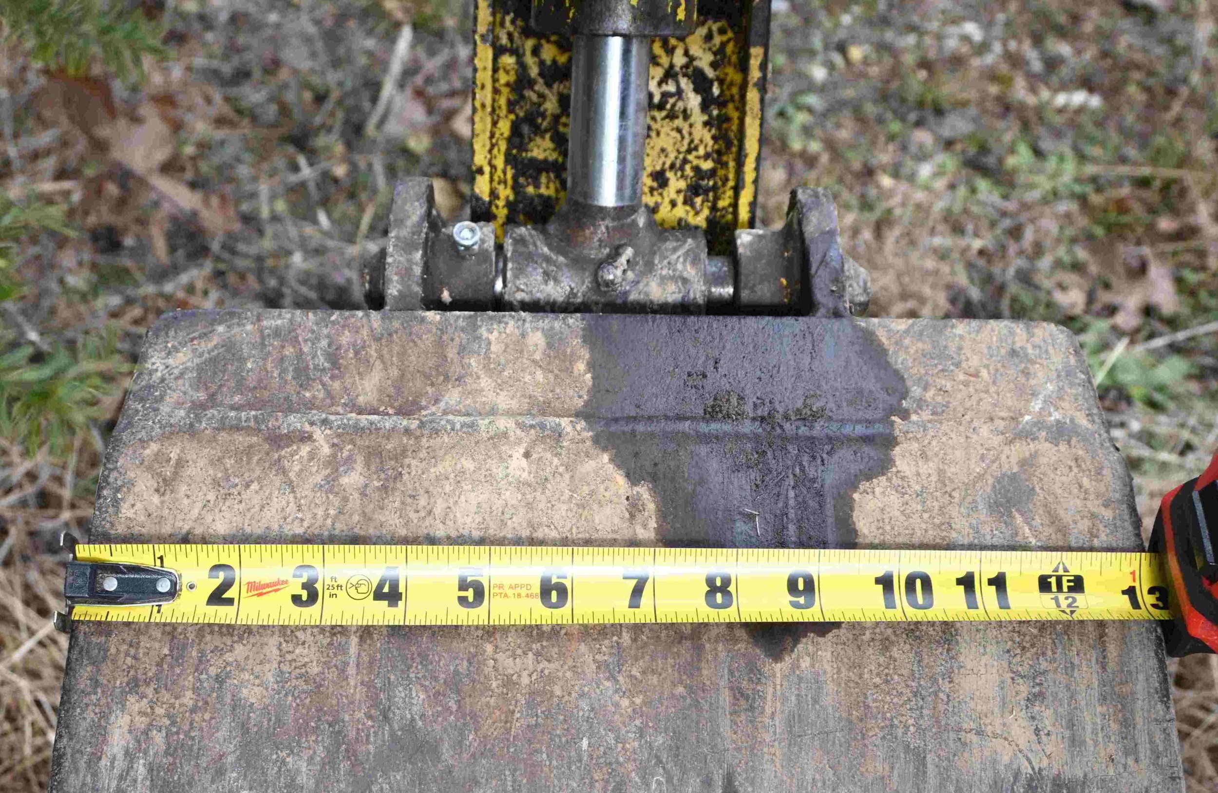

My Terramite T5c has a 48" front bucket with toothbar and 13" digging bucket.

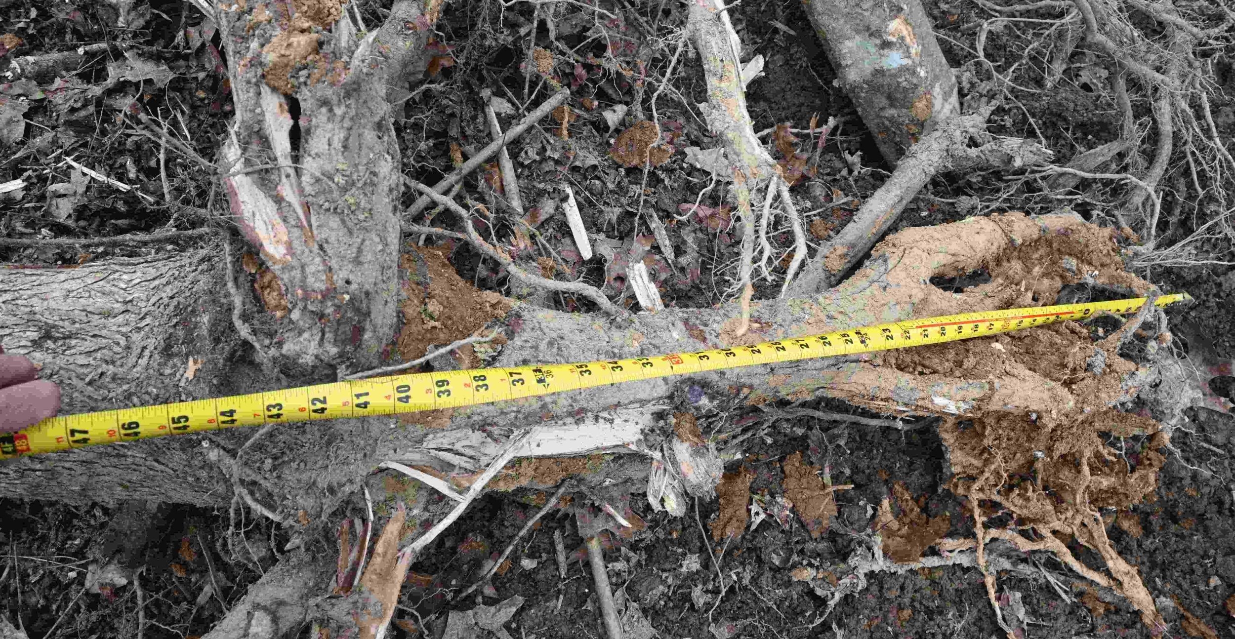

This gum tree had a 8" trunk at the surface with 43" hidden under the ground. It was hard on the Terramite digging it out with the digging bucket on the backhoe even though I paced myself to dig in smaller bites. The ground was moist when I dug it out last week.
It was also growing in a cluster of other similar sized trees so the combined root system made it harder to dig out.
On the other hand, I was able to push out this much smaller tree whose roots were at the surface and didn't have a tap root with the FEL. But keep in mind that the T5c is built from plate steel and is heavier than it looks in pictures.
For the price of a toothbar, you might could rent a stump grinder or pay someone to grind them out.
Also worth mentioning is I loosened a stump similar to this one with the T5c and tried pulling it out with the drawbar on my MX5200 in 4wd to see if it would be any easier. Although it came out, I was mindful of the risk of flipping the MX trying to pull a firmly embedded stump that doesn't want to budge. So I dug the rest of the stumps out with the T5c instead of taking that risk.
