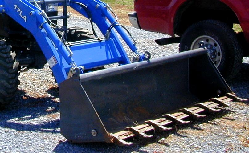

Re: Toothbar problem, part 2

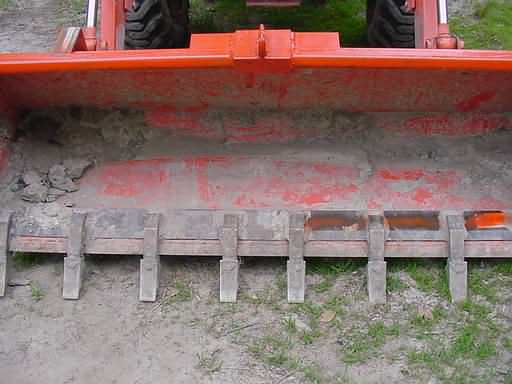

Here's another shot of the poor fit.
John Mc
/ Toothbar Installation #22
If the clearance is 1/2 inch, I would consider it a problem. The two edges fit tight together on mine and I still have to clean out the wood splinters after working in the woods. With a larger opening you would have stick and about anything else stuck in there. Dont think it would effect dumping of materials. Possible solution is to stuff some metal in there to fill the gap.
John
Your picture looks very similar to the Long Tooth Bar I have. I never did get it down flat without any gap. To get it closer than yours I had to grind some of the weld that holds cutting edge to bucket.
When installing tooth bar I point the teeth of tooth bar down and attempt to lift front of tractor up. This seats tooth bar on bucket cutting edge.
John,
I purchaced the Long toothbar from Carver for my B2400 with LA351 loader. The toothbar fit exactly as your pictures show with a half inch gap between the toothbar and bucket. I considered that an unacceptable sloppy fit. It would have fit a one inch thick cutting edge, but the LA351 loader has a half inch thick cutting edge. I had the same thoughts, that things would get jammed in the gap and dumping would be affected. I contacted Carver and they double checked that it was the same toothbar that they always ship for that loader. I returned the toothbar and got my money back.
I was suprised to read here that others have the same loader/toothbar combination and say "it fits like a glove". Maybe different people have different standards for how well something fits, or maybe it is a quality control problem. Long does have a quality problem as far as spacing the teeth. While it may not affect the functionality much, the spacing of the teeth was completely random on the toothbar that was shipped to me. The tooth to tooth distance varied by more than 3 inches with every spacing being different. The guy that didn't bother to measure and eyeballed where the teeth should go, didn't have very good estimating abilities.
My toothbar is a bobcat bucket bite and it does fit like a glove. No gap at all. That would drive me nuts.

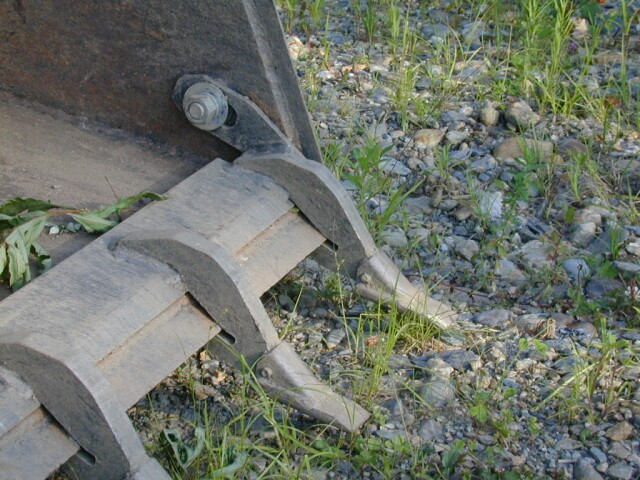

Here is a pic of the toothbar. It was to wide for the bucket so I cut a piece out of the middle and rewelded it. That is why the two teeth in the center are closer than the others.

That’s the way mine looks. /w3tcompact/icons/smile.gif Except for the 2 teeth close together. /w3tcompact/icons/laugh.gif
John, I have a Woods tooth bar that looks to be the same model and fit as the one you presently have. Maybe I am not picky enough but I haven’t found it to be a problem. The gap will fill with dirt almost immediately and I don’t recall brush having ever been a problem. With the Tooth Bar on, the loaders cutting edge is not engaging unbroken soil so the wider profile created at the edge has not been an issue. Actually with the bucket leveled, you will see that the teeth engage the ground about an inch below the cutting edge. Mine has over 300 hours working in rocky terrain with little wear so I would buy another if I needed one. Of course I never remove mine and that may make a difference.

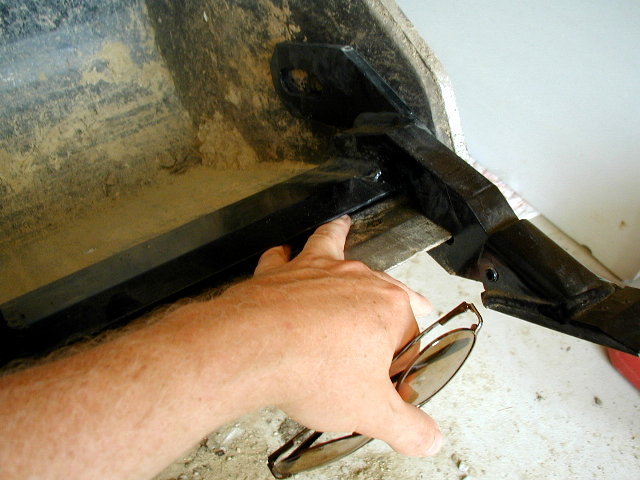

/ Toothbar Installation #30
John,

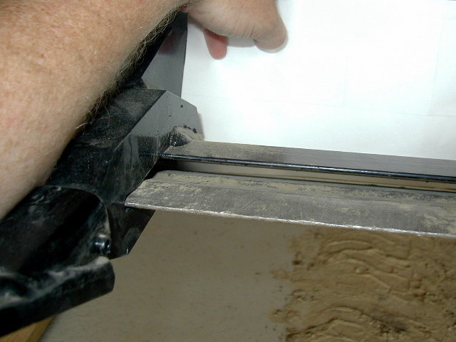

I agree with Mr. Carver that a slightly loose fit is
better, especially side to side. But I don't know about being able to slide the tip of your finger under it. I don't believe I can get much more than a fingernail under mine.
John,

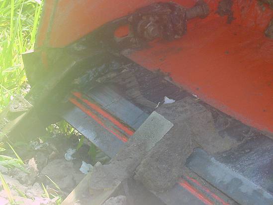

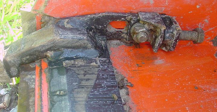

I basically got the "sloppy" fit with mine too. On mine I had to make a choice of having a gap between cutting edge of the bucket and the flat edge of the tooth bar that the teeth are weled to (like you have on yours). Or have a gap where the teeth slide onto the cutting edge. I choose to keep the gap where the bucket cutting cutting edge slides onto the teeth. I thought that this would be better and take some of the load of the mounting bolts and keep branches and rocks from getting stuck. I'm not sure if this is the best way as I haven't used it much yet, only 6 yards of boney gravel worth.
I will post a pic of it tonight.
I was not happy with the fit but I'm sure there are many different bucket configuation with different cutting edge angles that these tooth bars have to fit. I hoping it will be alright. My loader is able to lift 1800 lbs. so it will get a good testing.
/ Toothbar Installation #33
Here's the close-up as promised. Although it looks like there is a lot of space between the tooth bracket and the bucket cutting edge it fits pretty tight. No signs of movement. Again I haven't really used the toothbar hard yet, just moderate.

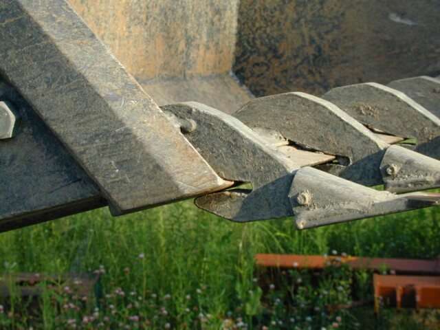

Ok here is a picture of mine and also this picture shows the mount. It's adjustable, reason being as you bucket wears you can still adjust the mount so it still fits like a glove.

Ok here is a much better picture. It's more of a close up.

Really nice!!! That fits BETTER than a glove!
I really like the adjustment.
