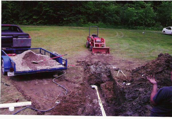

Jim,
In case you haven't decided yet, here is a photo of some excavation work I did a few weeks ago at my lake property to dig up my septic outlet to the distribution box. It was accomplished with my BX and toothbar. A backhoe would have been nicer, but I don't have that luxury /forums/images/graemlins/frown.gif so toothbar it is /forums/images/graemlins/grin.gif
Only problem with doing it this way is you have to take 4' wide and also dig a ramp in so you end up excavating more than you would with a backhoe. In any event it sure was better than doing it all by shovel! As it was there was plenty of shovel work and the wife helped for a bit and threw her back out. She's just finally getting back to normal and this was 3 weeks ago.
My soil there is mostly clay but the top was hauled in dirt/gravel a couple of years ago when I had the septic put in so it was hard to get started in but then went better as I went.
The picture isn't very good as my father took them and printed them out on photo paper and deleted the files before I told him I wanted them. So I had to scan them back in so I have a digital copy as well for long term archival.
Toothbars sure do rule for us "poor" no backhoe usin kinda guys /forums/images/graemlins/grin.gif
Hope you enjoy as much as I do.
