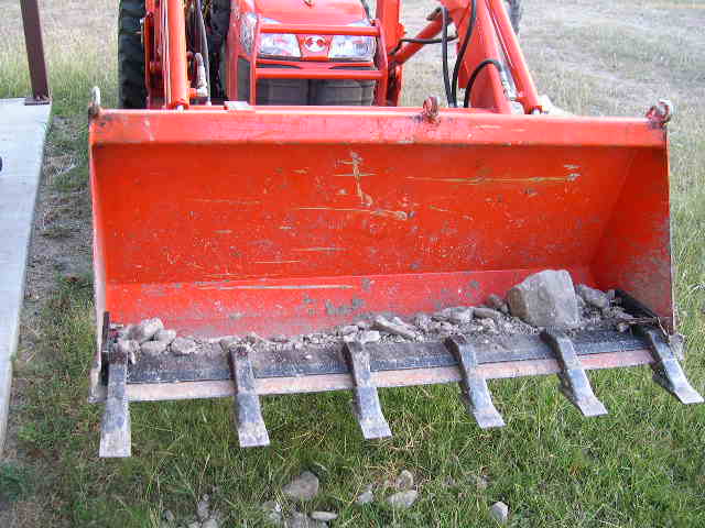

I will call Allen or Melissa at Markham in the AM. If they don't have a tooth shortage, I should have a toothbar in hand by early next week. They have the best prices, too, ~$175, compared to Berlon at $300, and ATI at $350 (shipping NOT included).
How closely did you measure the internal width? With the weld bead along the bottom of the bucket, it measures some 5/16 to 3/8 inch less width than when I measure higher up. I understand that Markham jigs the bar to be 1/8 inch less than the measurement you provide. Is it reasonable to expect that when you bolt it in the bolt will suck the mounting tab out to the inside wall of the bucket or will you need washers inside as you mentioned??

doc, this is my markham bar that came in monday (10/3). as you can tell, i've already tried it out. my bucket was 54" and measured exactly 52 1/2" inside and that was the measurement i provided markham. no shims required as you can see in photo. shipping weight was 65lbs but i think that was on the light side. about 20 minutes install time. you will need a 1/2" drill and i used a 9/16" bit. your price is what i paid and 40.00 frt. good quality and fit. highly recommended............. /forums/images/graemlins/grin.gif

My bucket measured 42 inches. I took into account the weld bead, and gave them a 41 7/8 measurement to be on the safe side. They also made the bar 1/8 shorter. I now have room for about two washers on the inside.
It is made of pretty heavy stock so I am not sure if the tabs would suck it in or not. I figured measure a little short, for me better safe than sorry. I think like Stockerduster you can get away with an exact measurement. I just didn't have anything to gage it by. Didn't want to go to all of the trouble of having to send it back. /forums/images/graemlins/ooo.gif

Couple of tips as you start learning to use these aggressive toothbars:
1. Get a sense of what the bucket position looks like when just the teeth are sitting flat on a hard surface. When the toothbar is installed on the bucket, the bottom of the teeth are actually over an inch lower than the bottom of the bucket. You need to be able to visualize what the bucket looks like when the bottom of the bucket is parallel to the ground -- because if you just put the front and back of the bucket on the ground now, it'll actually be angled up over 1" in front, and won't stay in the ground as you try to dig.
2. The opposite holds true -- don't "get greedy" and try to take too deep of bites of dirt, if you're digging. Instead, slice off 3" or 4" at a time, running with the bottom of the bucket parallel to the ground....
3. Don't be frustrated if it takes a little while to get the hang of it -- like everything else, it gets much easier with practice....
