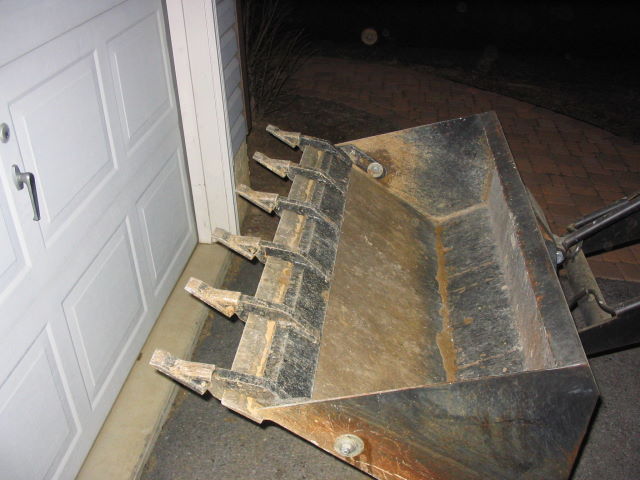

Here's a pic of my LM bucket with a toothbar on it.
Works great!

Looks great too! :D Did you provide exact measures when ordering the bar? Or did you account for anything (e.g. welding)?
Thanks!
Thanks!
The mounting tab for the Markham bar will sit about 1/8-3/16 th inch above the floor of the LMB when it's installed. So, unless your bucket has an inordinately large welding bead at the junction of floor-sidewall, you don't have to take this into consideration when you measure. The Markhams will jig up your toothbar about 1/2 inch LESS than the measurement that you provide (i.e., 1/4 inch per side)to take into account any irregularities. If you do measure conservatively, it's easier to put in a few "fill" washers than to have to try to correct for a bar that's too big---my $0.02.
To address your other query, the Markham bar on my LMB has been fantastic. Without re-hashing too much, the bar strengthens the bucket considerably by reinforcing and rigidizing the leading edge of the floor which is the part that takes abuse in any digging bucket. I have the LMB w/ toothbar and the 4n1 w/o toothbar--- an awesome combo. Just be careful that you don't overfill the LMB with heavy stuff like crush'n'run. That's its only limitation. Too much weight in the bucket can lead to sagging of the floor as reported by MR and other folks on the forum. I don't think the toothbar would prevent that.
P.S. The Markhams are great to deal with.
