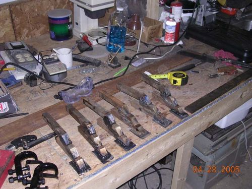

#29
hey, My thread is falling deep into the list so I better post an update to bring it to the top. I finished all "six teefers" now. Hopefully I will finish the project tomorrow. Also the two hooks that I ordered from JC Whitney back in February finally arrived for the top of the bucket. See attached.
   / Toothbars, how much is too much? #30
Nice teeth - easy to floss too!
