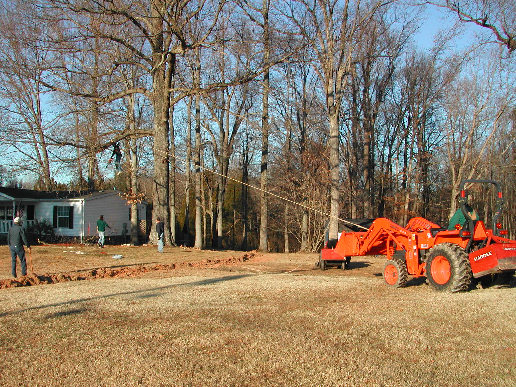

DON'T! WHAT EVER YOU DO use your loader or tractor to trim trees, don't even think about tying a person to the bucket and pulling him up into a tree to trim it.:eek:
   / Top 10 things NOT to do with a new loader! #44
Hey who got that picture of me up in the tree! :D

I hadn't thought about cutting trees that way
Getting up close to your work !!!
