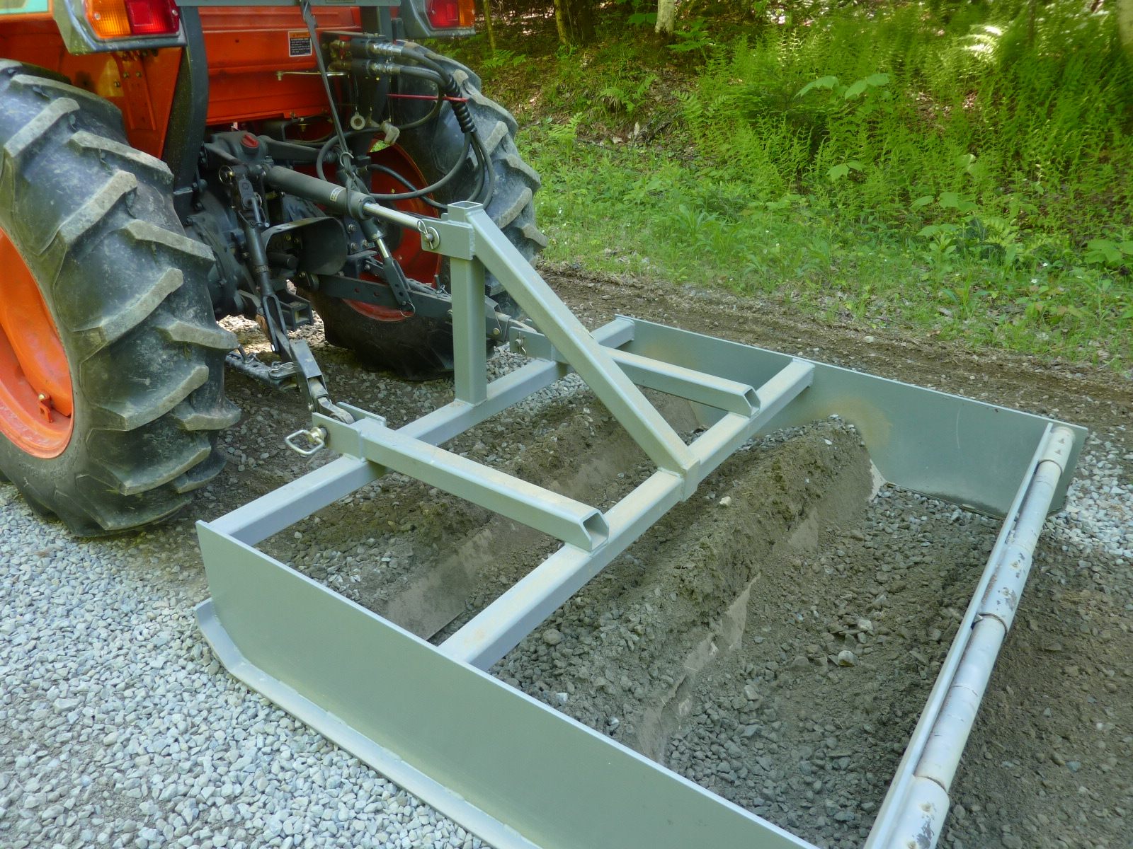

My L3010 is similar to your 3301. This is a T-n-T from fit-Right Hydraulics.
gg
gg
I see you did what I did Gordon. Moved the manual adjustable side link to the left side!!! :)

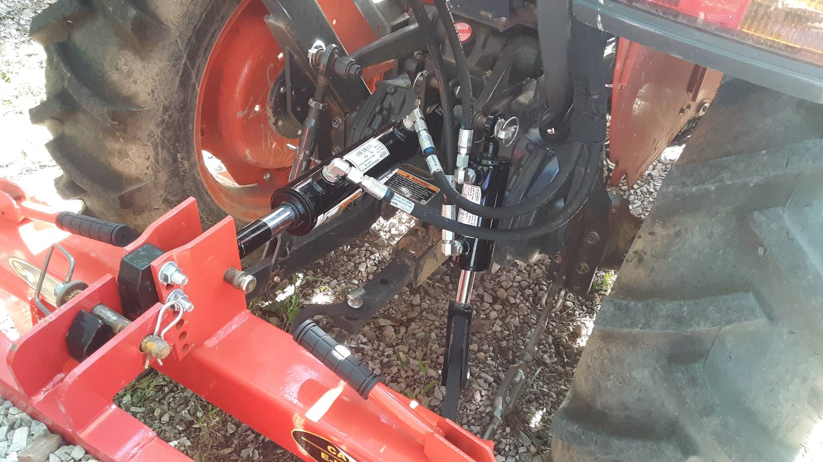

I also installed a Fitrite Hydraulic solution on my L3800 - similar size to yours. At 1st I used it to regrade my 500' gravel driveway with my box blade and back blade. It's a game changer to be able to quickly and often adjust the tilt or the aggressive angle of he blades.
This is a shot of the valves first mounted. I moved the control levers horizontal when finished.
and the top n tilt
I'll never have another tractor without TNT

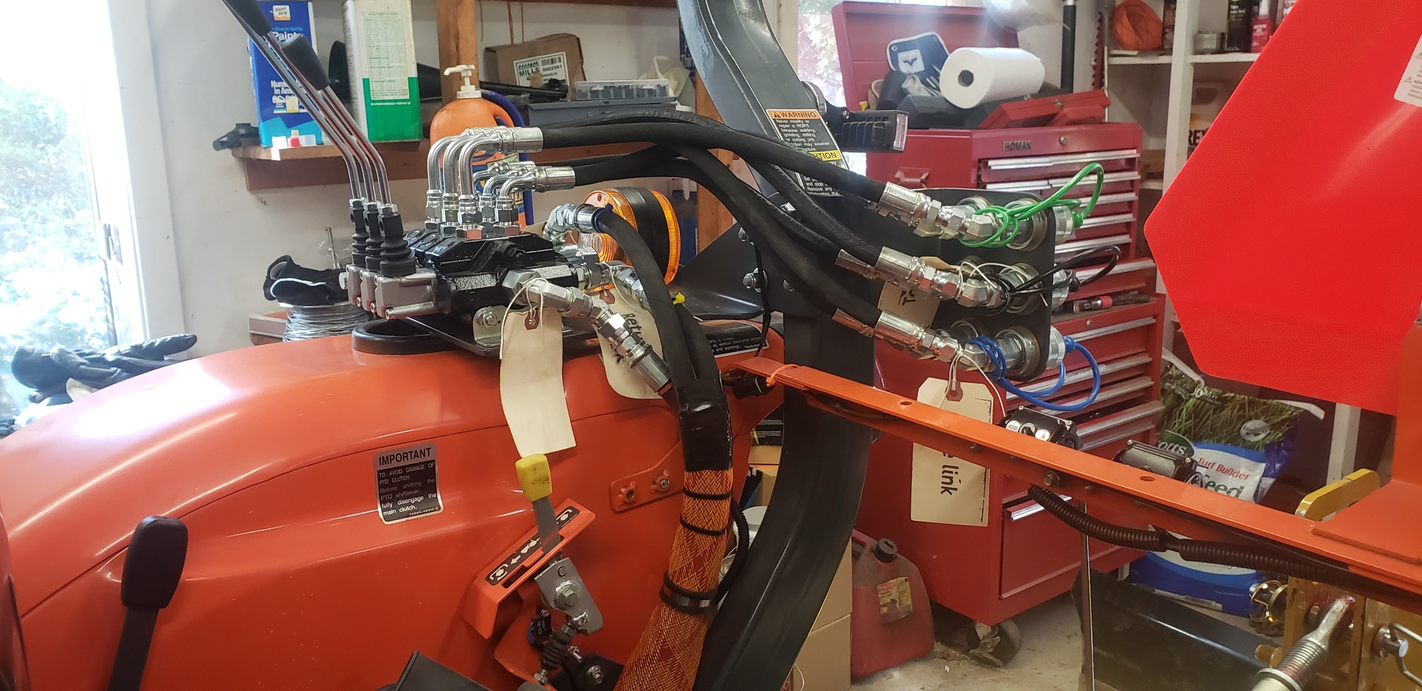

   / Top and tilt questions #12
My custom valving & Fit Rite TnT build on my old L3200. Should be more or less identical to a L3301. 3 OEM valves may be cheaper & easier. Probably won't look as good though.

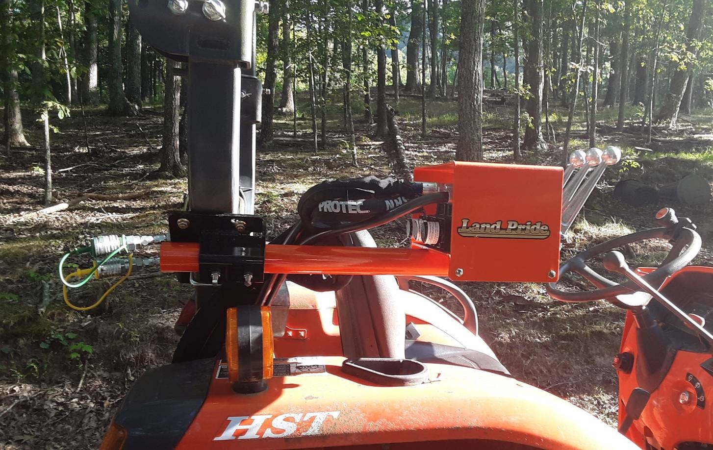

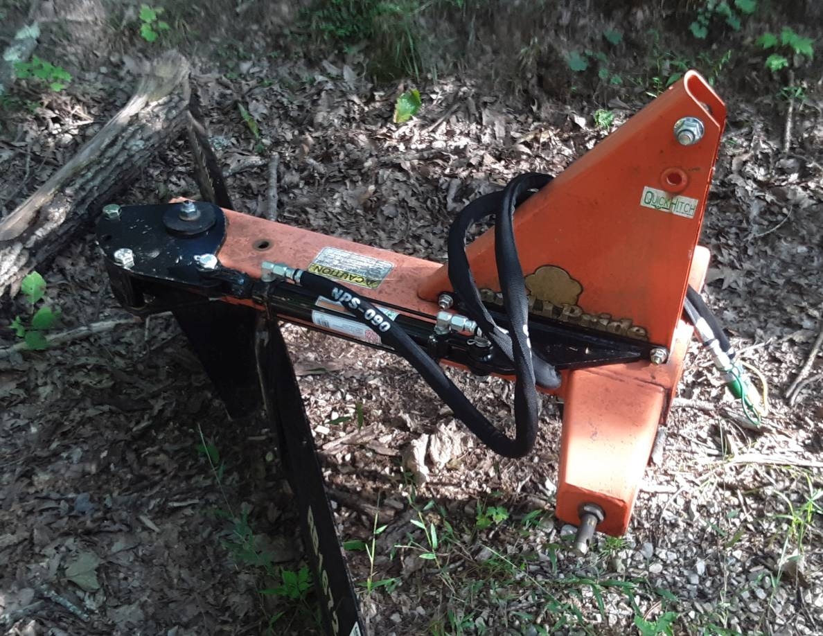

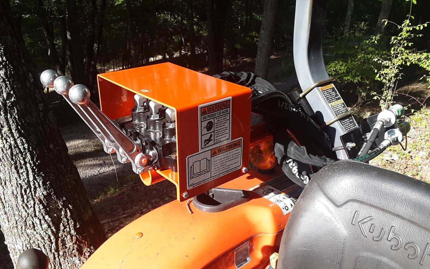

I finally got my top & tilt installed and it is SO NICE! No more climbing on and off and on and off and on setting the blade angles. And I got a 3-point quick attach. So. Much. Better!
I went with the Land Pride T&T kit and added the blade angle kit for my blade. No fuss trying to piece-part it. Had the dealer install and make the hoses.
