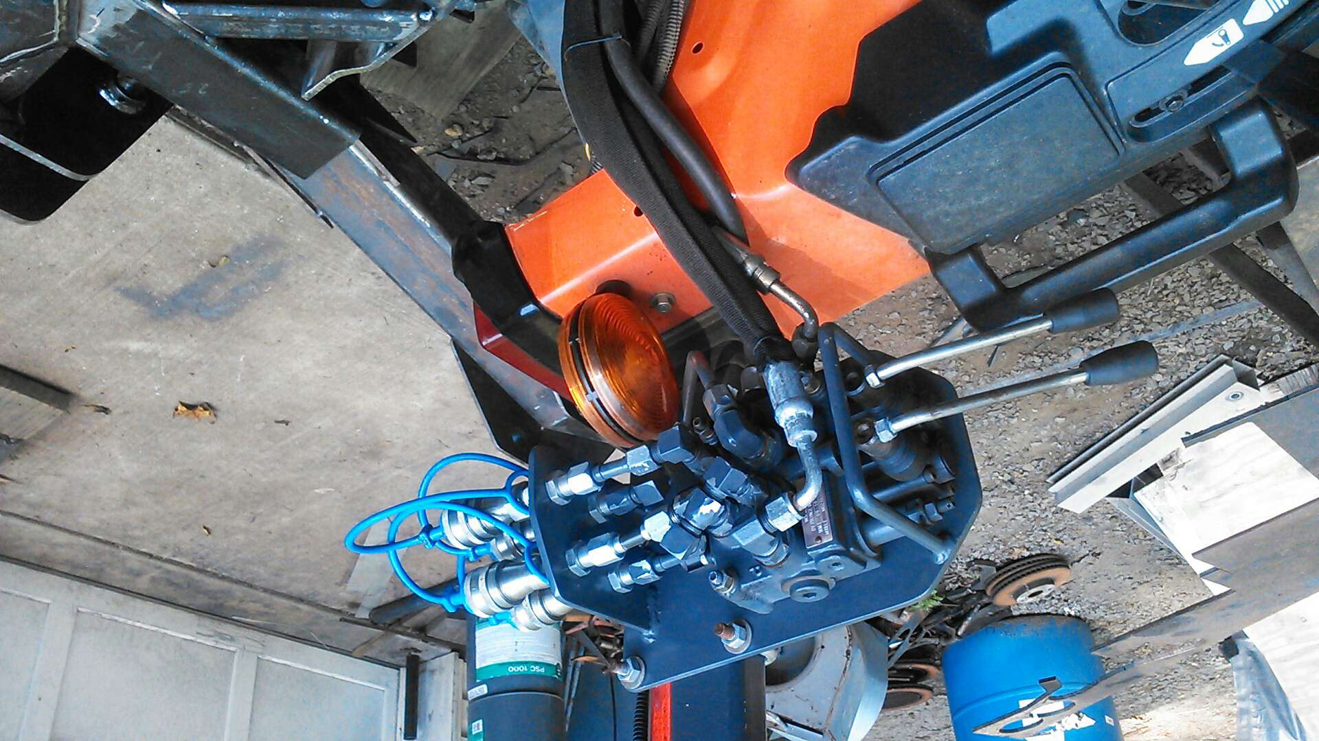

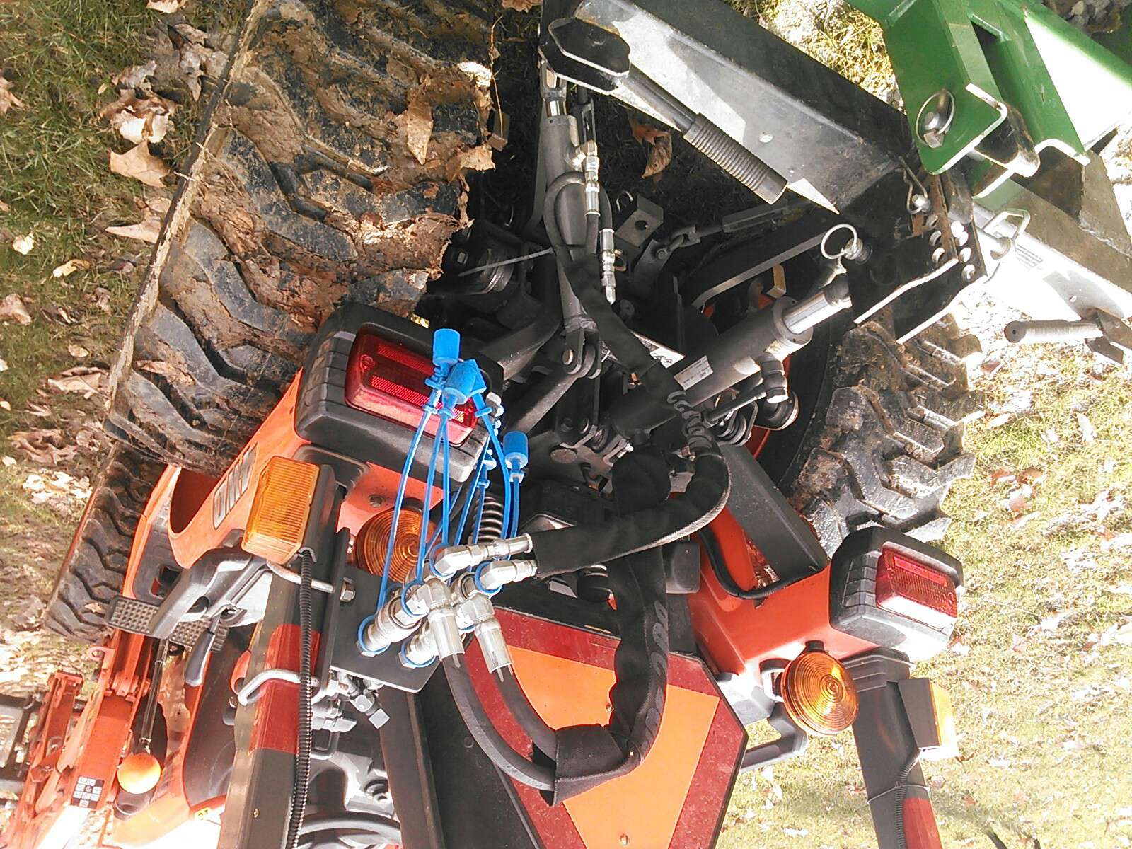

This is how I did my remotes and TNT on my B2620(basically the same tractortractor), I'm still trying to get around to adding other 2 remotes on the left side of the rops. The top link is from surplus center and I made the side link from a generic cylinder from surplus center.
I added a backhoe so I had top leave the center section open on mine, if not you would have a few more options for the coupler location.

Sir,
I have a B2601 with BH 70 hoe and want to duplicate what you have done here with your rear remotes. I was hoping you could provide some insights on the main parts you used and how its hooked up.
Best,
Alex
