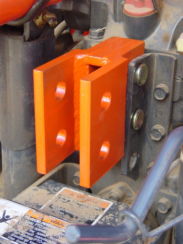

This is the one I plan to copy: extender 002.JPG
It was mentioned that he chose not to have the 3rd hole as he thought it might interfere with his PTO cover.
I suspect that, were one to need the lower hole, this could simply be moved down, leaving the top hole uncovered.
I hope this works as well as I expect.
   / Top link extension on the tractor. #12
Spray some paint on the new welds or they will quickly start rusting.
   / Top link extension on the tractor. #13
This is the one I plan to copy: View attachment 554898
The advantage in using this method is you can remove it if you need a shorter top link.
If it were me, I'd cut the bottom corners off the bracket to give more clearance for the PTO cover. I'd also paint it Kubota gray instead of orange. :)
