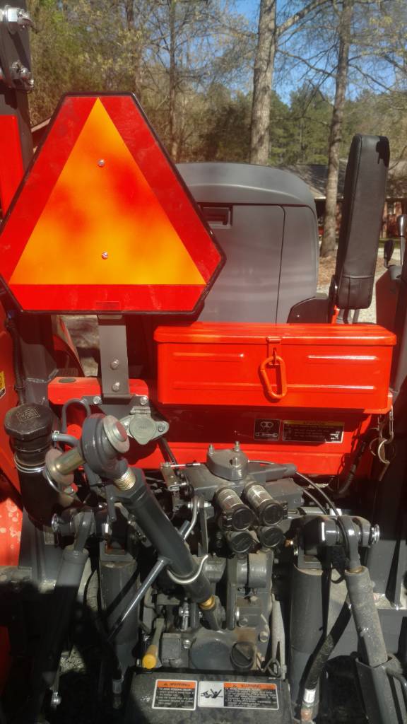

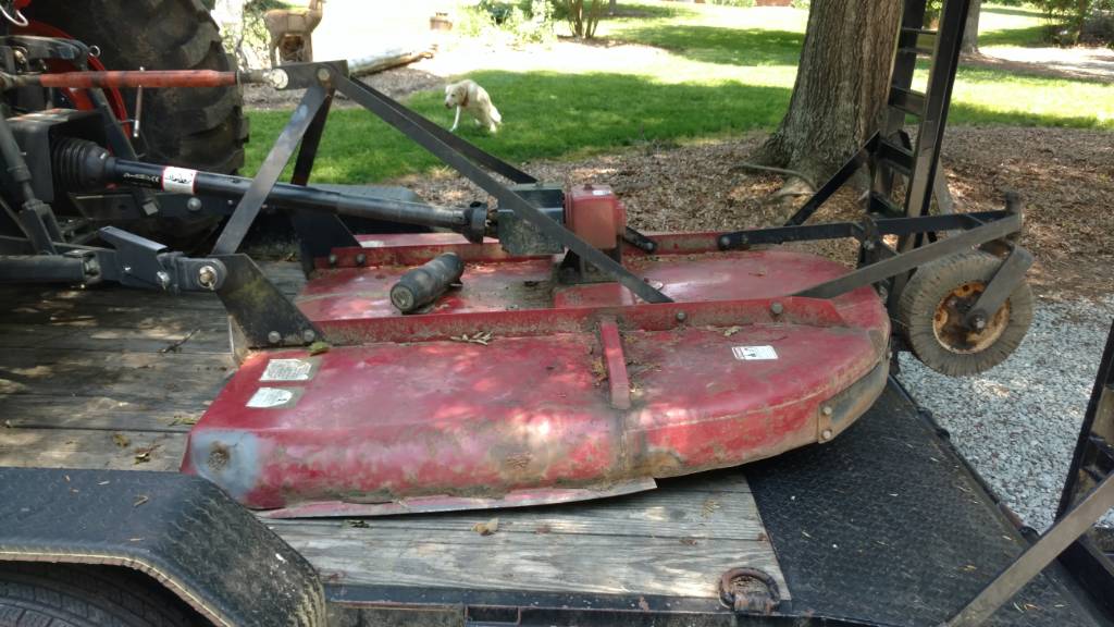

I don't have the hydraulic top link, but the particular bush hog I have needs a extra long top link. I purchased this extra long top link when I used a Ford 2000. I then used it on my Ford 3910. Oddly, I did not need it with the Mahindra 5035 I had prior to my new 2018 Kubota M7060HD12. I have to use the extra long top link again. My tractor is supplied with Cat 2 and most of my implements are Cat 1. I bought several Cat 1 x Cat 2 bushing adapters. I couldn't use the Kubota bushings on several of my implements because the tolerance was too tight and they wouldn't slide over the implement pins. My tractor also has Cat 1 top link pin at the tractor and Cat 2 at the implement end of the adjustable link. Pics are of both top links. IMG_20180417_165419966.jpegIMG_20180514_125736005.jpeg
