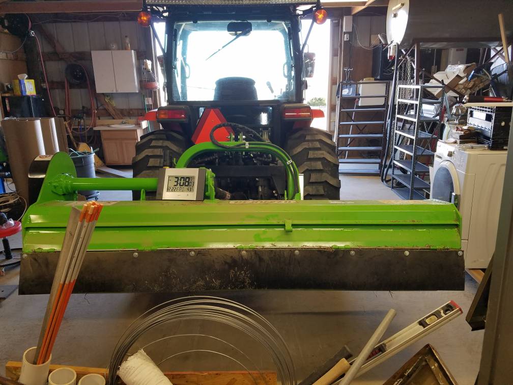

Under 40 minutes according to the clock i set on there. No external leakage on any of my FitRite cylinders or any leakdown with them disconnected. Allegedly my dealer has replaced several of them several times each. Only the toplink valve doesn't such.
More or less given up on Kubota fixing it. But haven't got around to an external valve of some sort that will likely kill float (not that I use float much on the side link, unlike the toplink). 20171222_150735-1.jpg20171222_154409.jpg
