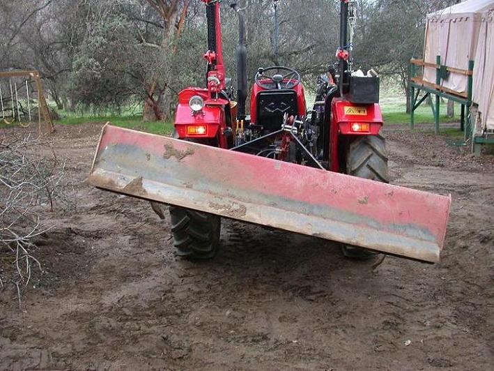

/ Top link Length needed #10
If you're only attaching one or two implements - especially light ones - it will take a long time to amortize the investment. I've got to switch regularly among six very different implements, and wouldn't be without mine.
It also cured my PTO broadcast spreader problem. I never could find a toplink short enough for the spreader to ride level, but a Cat II PEC system added 4" to the lower lift arms. Problem solved.
//greg//

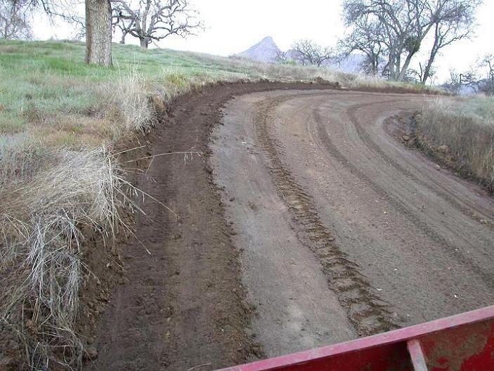

/ Top link Length needed #11
Rick,
I highly reccomend it. I only switch 4 implements and it's worth it to me. I've had zero problems with it. Very easy.
One thing that came up on a different thread was concern about being able to tilt your boxblade side ways as for cutting gutters. Someone thought the EZ system might limit the amount of tilt but I found out different. Here's a picture of my boxblade tilted. I cut 1500 feet of road, gutters on both sides of it this way. It never jumped off the link pins.
